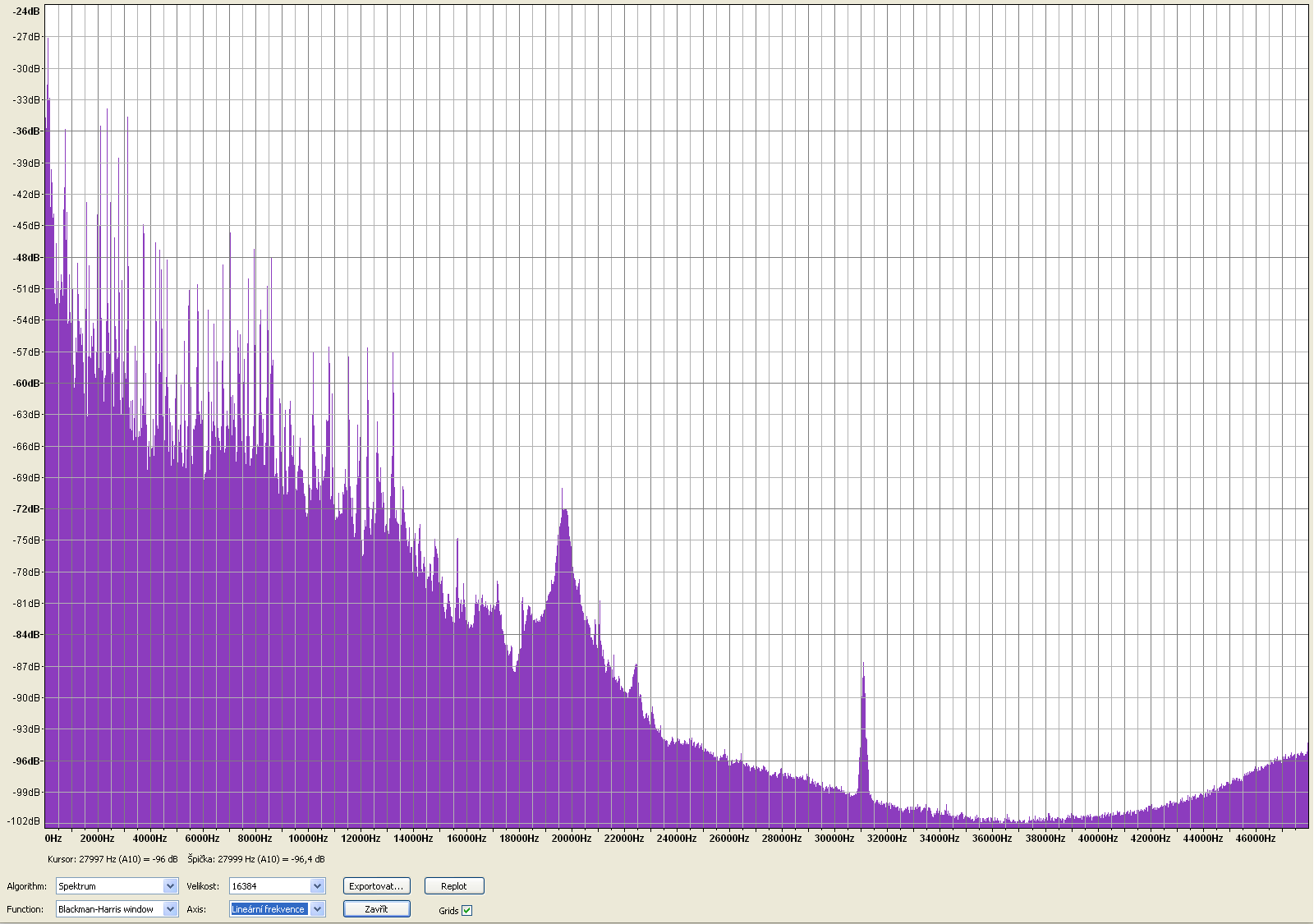

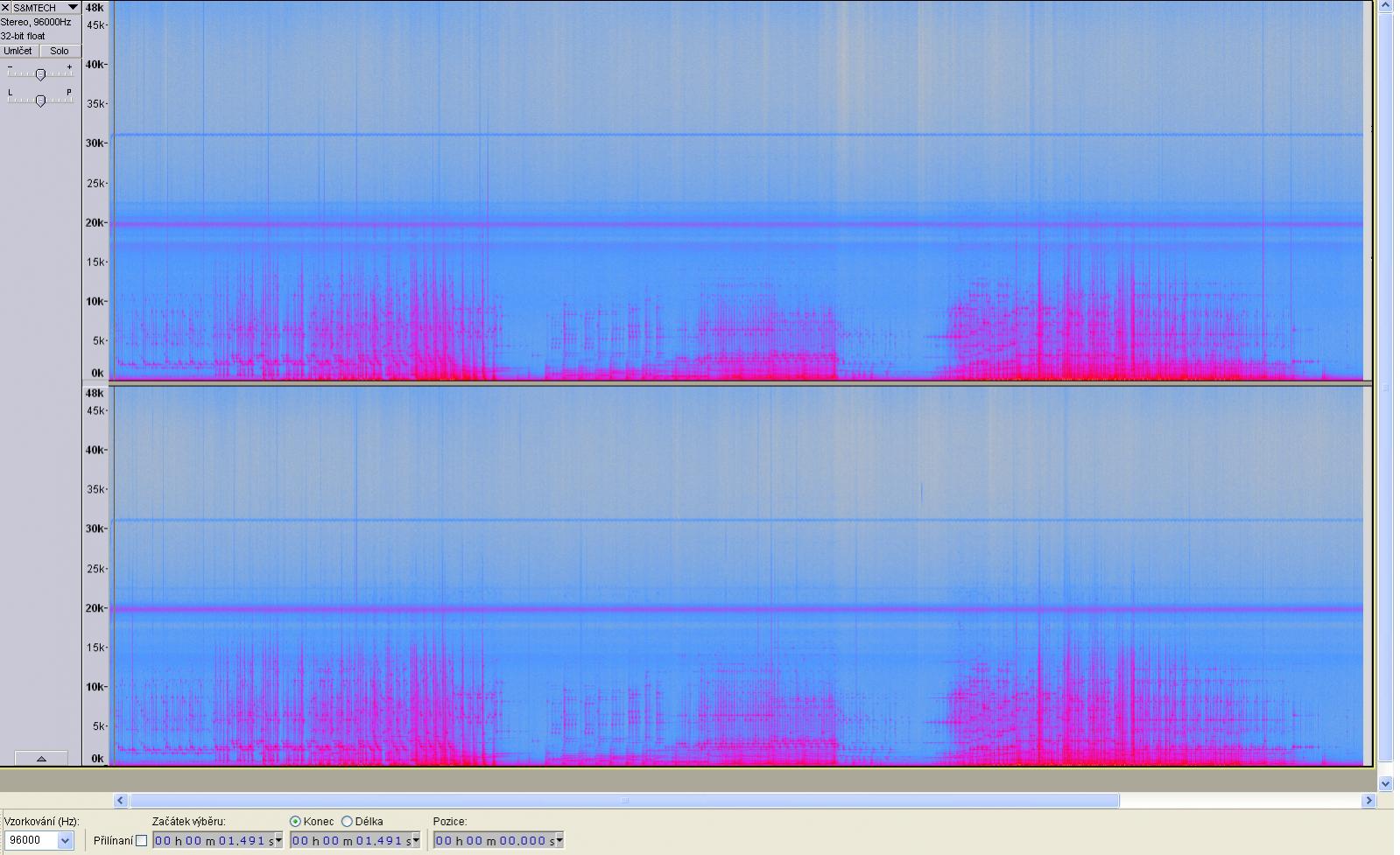

He also prepared A/D digitized "hirez" files recorded from LP's to demonstrate different "sound quality" of various phone cartridges/turntables. Technical quality of these recordings was so poor that I can hardly understand how he could publish such thing. Or maybe I understand quite well. Based on what he likes, I would probably avoid it first.
Technics SL-1200G Versus Continuum Caliburn And SAT Arm | Analog Planet
This is what Fremer is giving to audiophiles. Cartridge resonance + tons of groove noise. And no real highs, they end at 13kHz. Aif files in the previous link. Good sound?

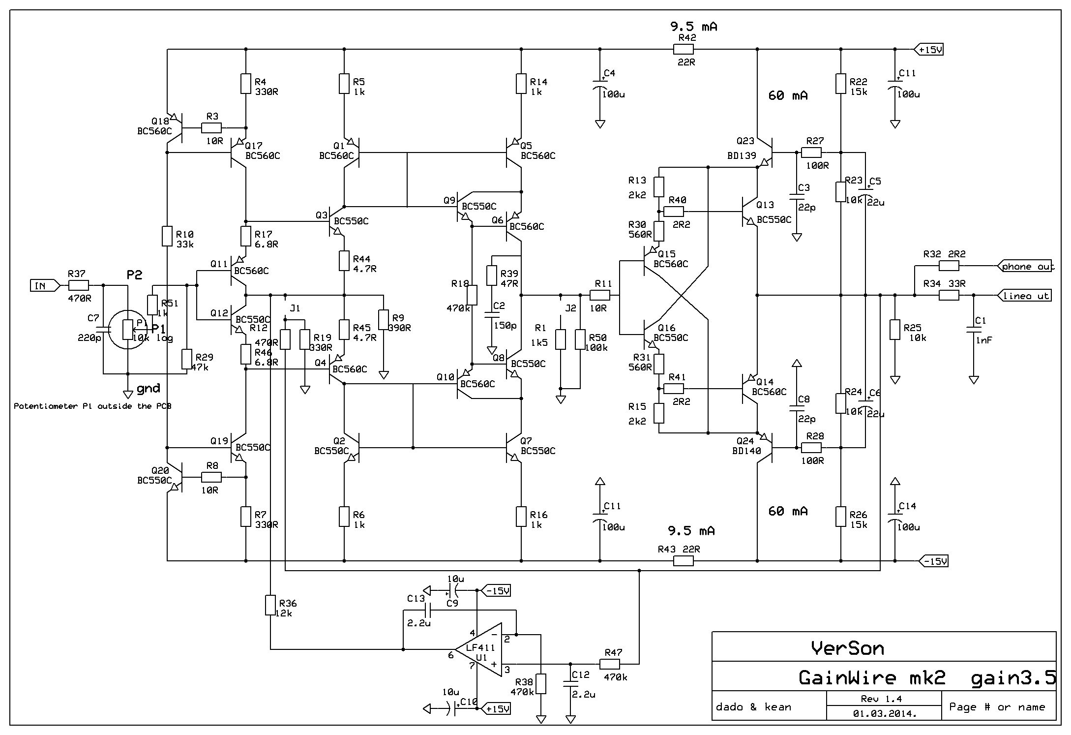

I think I know the preamp;-)
So, we have a preamp witch works in two configurations, *with the same components*.
If I remember well, the distortions were low enough in both modes to can exclude any difference to come from there. Despite this, a lot of people tend to make the difference and have a preference. And I tend to believe there is really a difference in the presentation..
Now the question is; why ?
The only answer I can imagine is : Dynamic behavior.
Exactly, the same circuit/components, with the gain difference of both modes is 0.13 dB. The mode set by change just one jumper(J1 or J2), schematic attached.
I am inclined on the NFB side, but here I could not decide.
