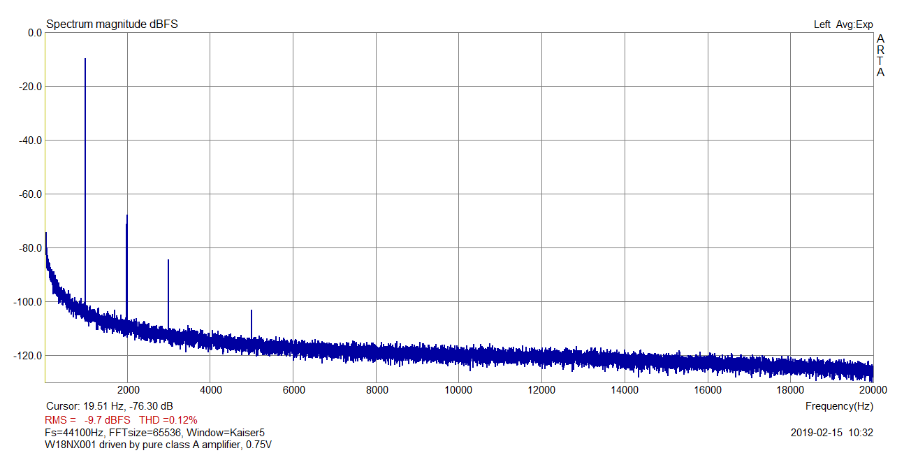

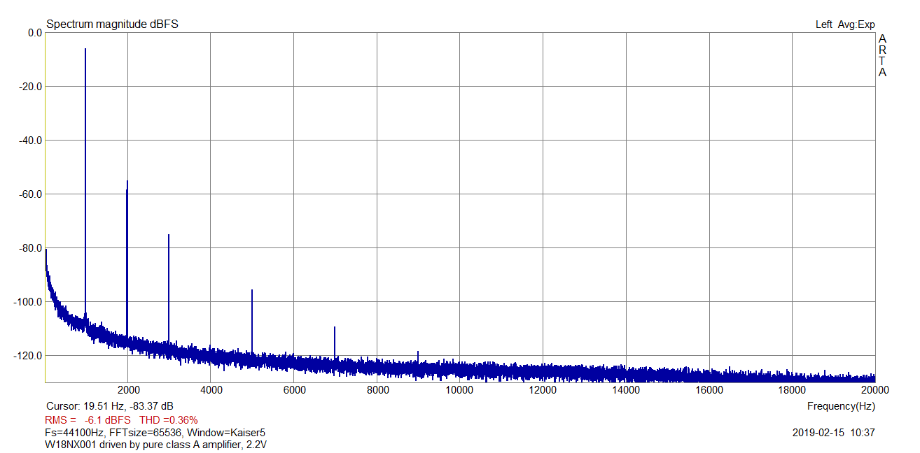

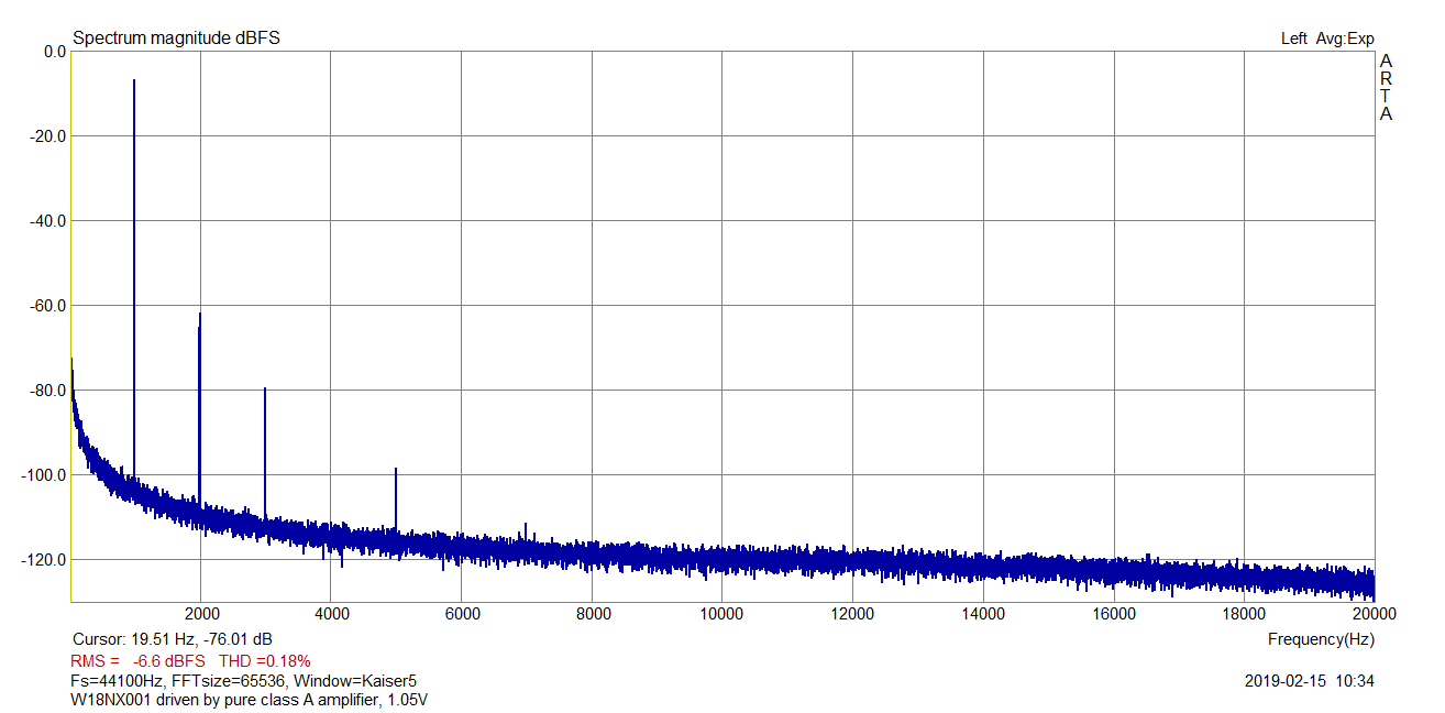

We are able to measure with unexpectedly good resolution event at speaker acoustical side. There were some remarks on class AB amplifiers and I have to concur that class AB crossover distortion is often measurable at acoustical side. As a reference, I use a pure class A amplifier, with distortion components only H2 and H3 and below 0.001%, with all other higher harmonics well below -130dBr. This is still not usual even with well designed class AB amplifiers, especially if we are in the crossover area. Acoustical measurements at quite low voltage level, however quite usual during normal listening, show, that higher order harmonics at the acoustical side are really extremely low in level and that a crossover "signature" of class AB amplifiers is very often higher. Not speaking about tube amplifiers, which would be in orders higher. Class A with local linearization is still the best we can design, especially its immunity to load variations. Class AB amps still do have its signature.

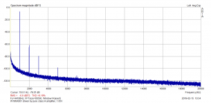

Hope Pavel doesn't mind, the tweeter voltage driven:
The same tweeter current driven:
Kudos to Pavel. I have done the same and more... with is more to come. And it will be about what one can do to voltage drive and hopefully get the distortion of current drive. That should be of interest to all of us here.

Thank you for the effort. Your acoustic side measurements are always helpful to me in some way or other.We are able to measure with unexpectedly good resolution event at speaker acoustical side. ...
I'm afraid the pictures don't load.
Not sure why, it worked when I posted them. Maybe PMA blocked them, that is his right if he did. I linked them from his website.
They show that you get lower distortion products under current drive when compared to voltage drive. What I propose is that there may be measurable improvement with voltage drive too. Lower distortion with voltage drive, that ought to be good.
