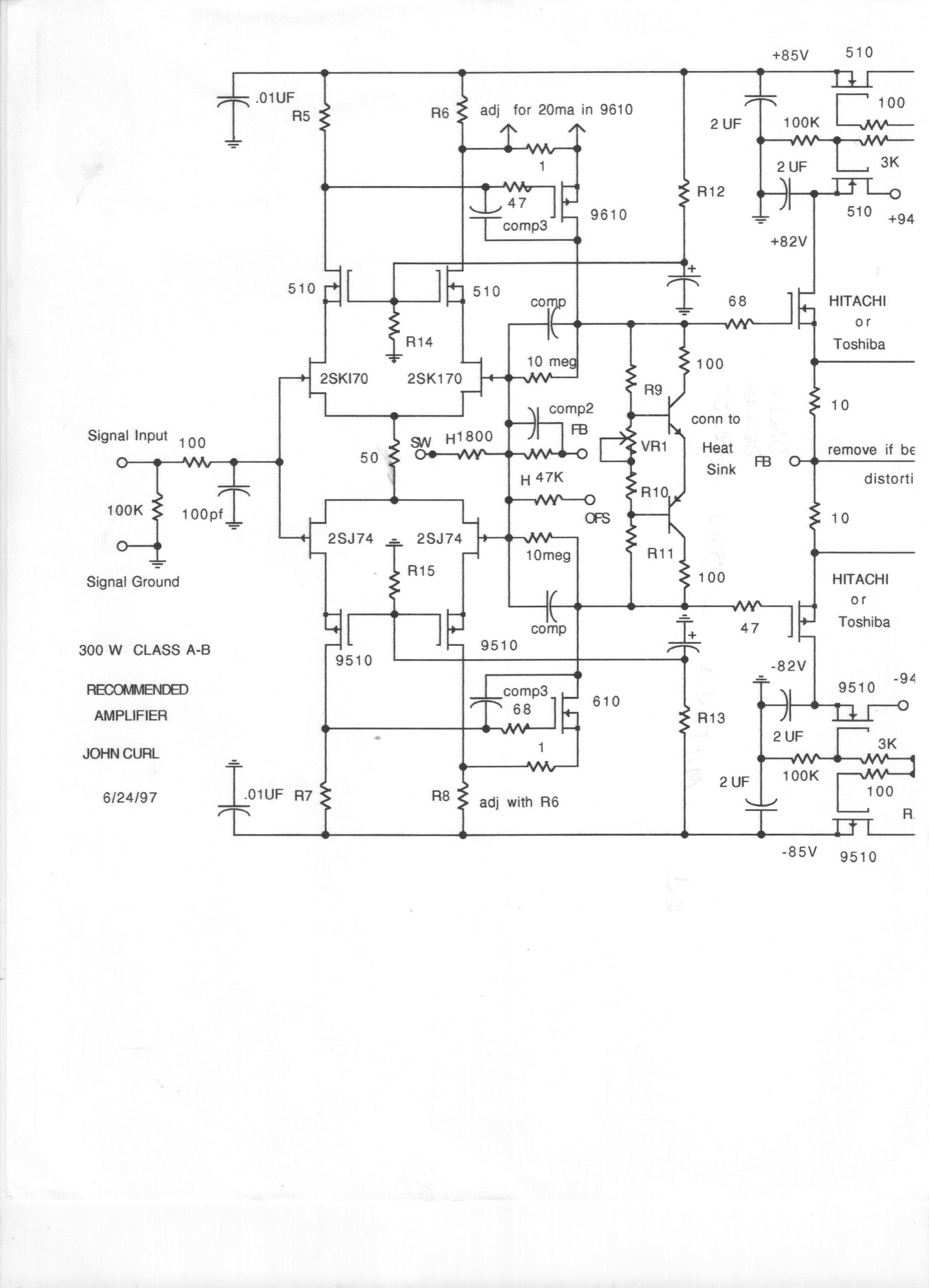

I agree with PMA that fets in both the input and the driver in this topology are better. However, Parasound engineers designing the cheaper models, invariably find better thd specs and more efficiency by using bipolars in the driver stages, so the A21 uses bipolars after the first stage instead of fets. My JC series amps use fets throughout, for example:
