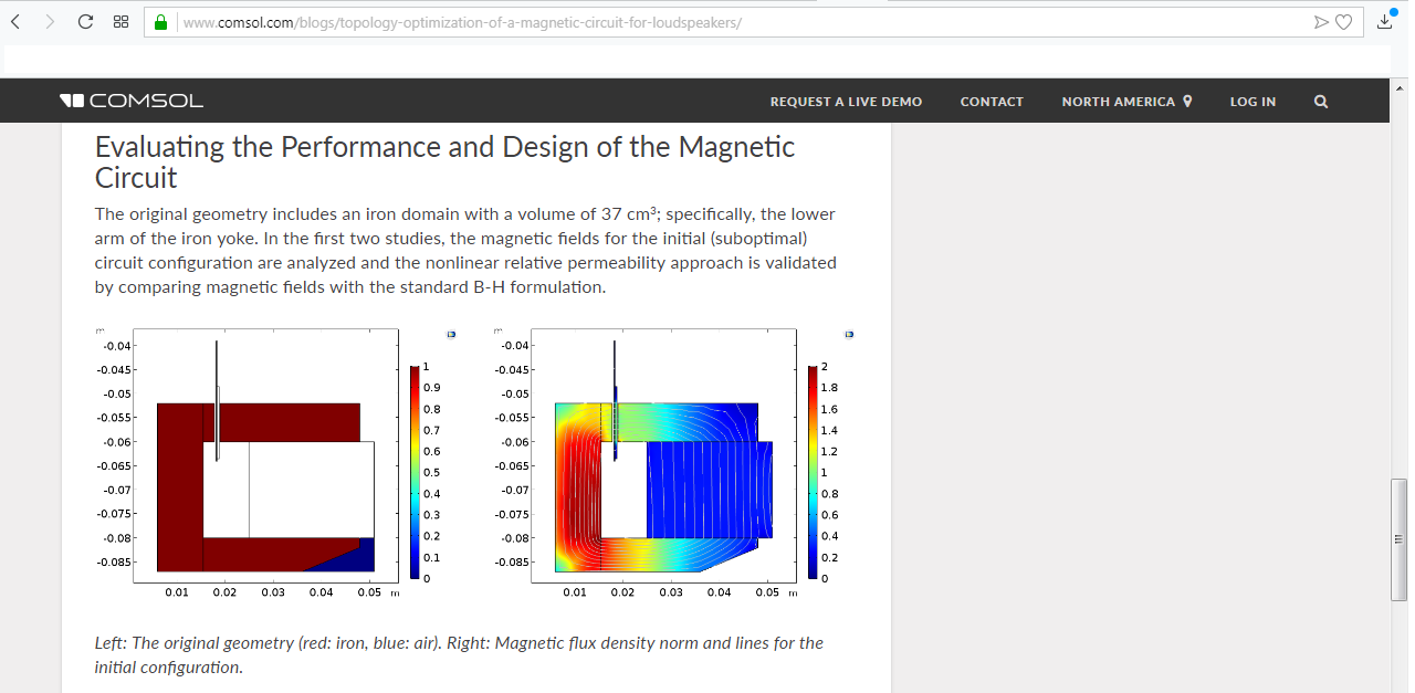

To deliver 1.5 tesla to the gap takes some horsepower. Most manu's just slap flat and round pieces together, many use as little as possible, the normal trade offs. Of course the iron type matters as well. Without a true FEA it's almost impossible to tell if any edges at the gap are complaining. I would expect the faceplate gap back edge to be the most compromised as it is the shortest path.Hi JN!
By two gaps I was referring to the air on either side of the coil (inside/outside) in series with the magnetic path.
So you are saying that the PM is strong enough in the driver you are using as a reference, even with the fairly large total air gap to saturate the front plate, center pole, or back plate in the driver you are referencing? I remember testing some Aura woofers some years ago with radial arrays of neo magnets which (big assumption here) should have had much higher flux density (2-5x) than a comparable size or weight ferrite structure. Those drivers did indeed have a generous vented one-piece yoke and front plate, but my thought here is: if the front or rear plates or center pole were saturating the additional PM B would be for naught. Without data here I am speculating, so many variables comparing two drivers....cross-sectional area and alloy of the plates/pole piece, grade of the magnets, etc...

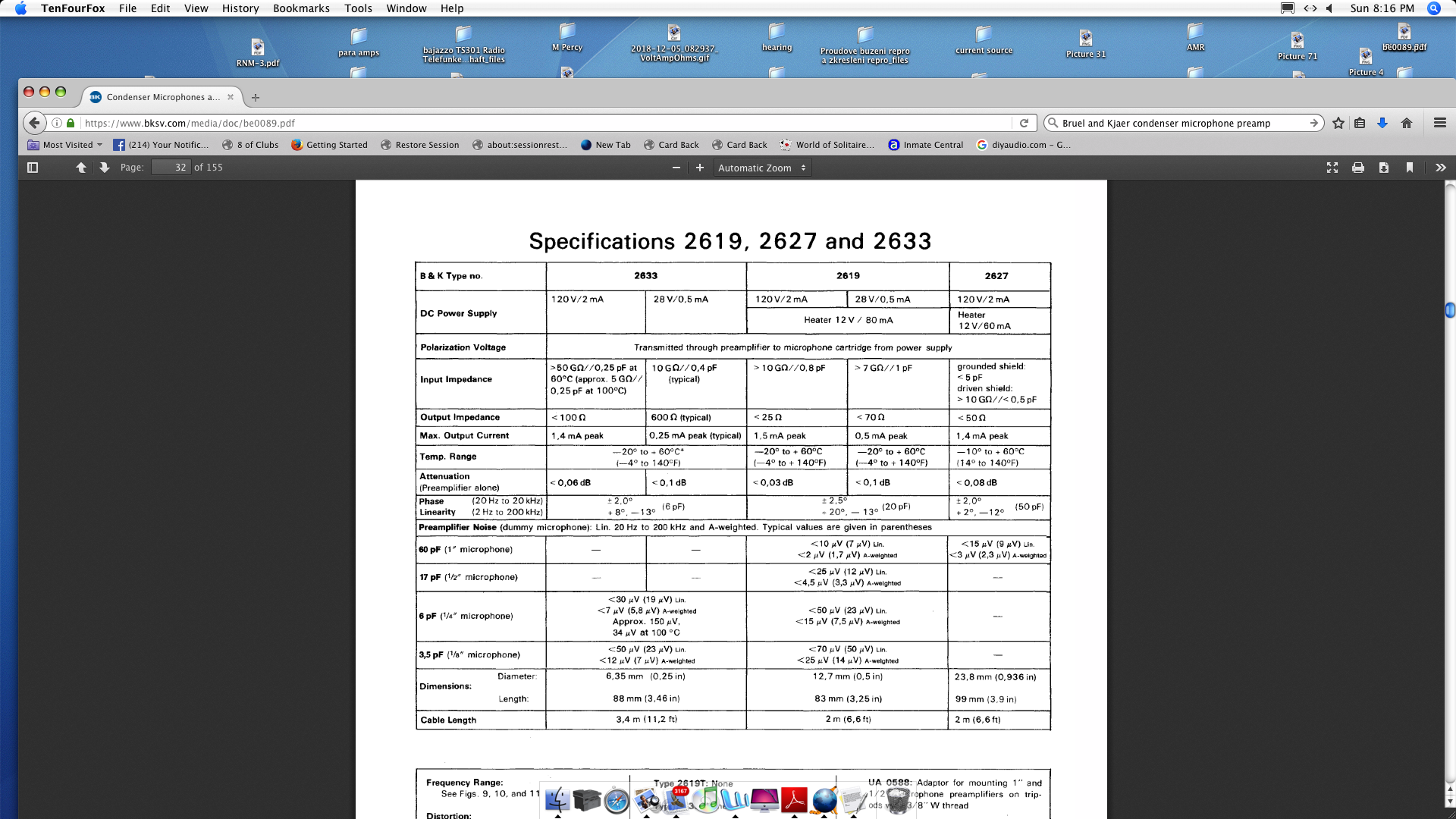

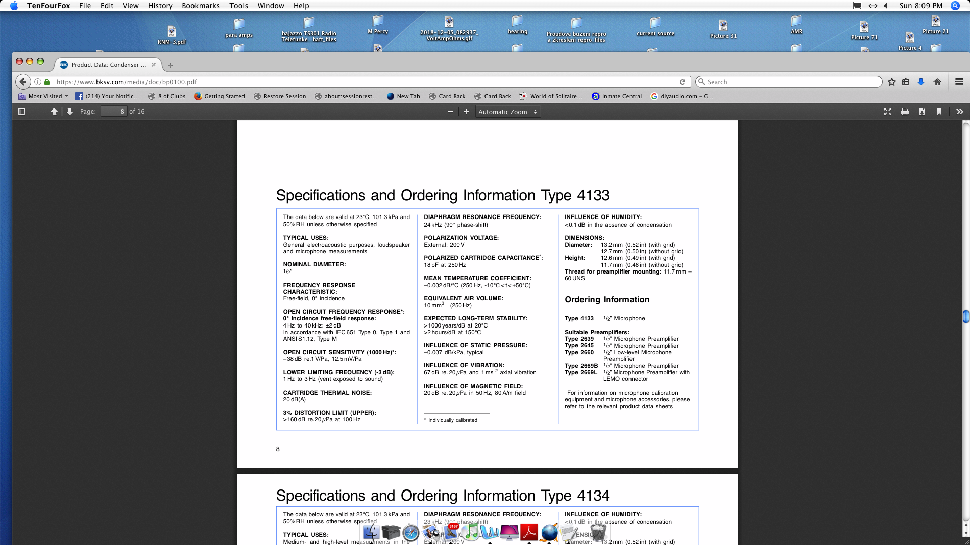

Demian, something is wrong. The chart you put up is for the CAPSULES only and at 140 dB or more! The preamps are subject to cap loading, unfortunately, but with a little care should be virtually unmeasurable even with the capsule up to 100dB or so.

In a PM speaker the magnet, pole pieces, front plate, airgaps, and VC are in a series circuit, and in most magnetic systems the part of the magnetic circuit with the lowest permeability determines the overall saturation fluxivity.
So here is my query: Since the magnetic circuit of a speaker has two air gaps, would there not be little chance of any saturation of the rest of the magnetic structureGreat discussion all!
Howie
Hi Howie
I haven’t designed a speaker motor yet, I am an armchair literature overviewer.
As I see, it is feasible to magnetically saturate the metal close to the gap (it is one gap by the way), paying the price of using the recourses of the PM inefficiently
In the series magnetic circuit PM is the source, the leakage flux at the gap is the wanted dissipative element.
Any other section which is magnetically saturated will constitute a parasitic leakage flux, which acts as an unwanted dissipative element.
Better set the priorities upfront and start from scratch than trying to patch ( “improve”) an existing magnetic circuit. Using a bigger or a stronger PM can easily fire back.

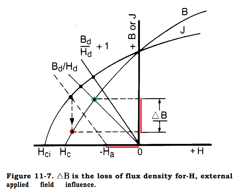

The wild card here is the inclusion of the field radiated by the VC in series with the PM fluxivity...Curious minds want to know!
The VC field works as an external demagnetizing field (-Ha at the attachment).
This will reduce the working induction Bd appreciably if the load line crosses the intrinsic curve close to the knee
