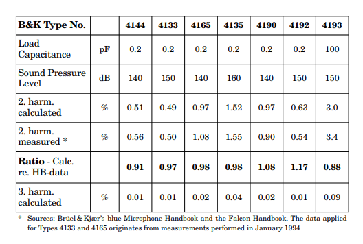

What mike preamp did you use Demian? A 2619? If so, you have a problem. If a portable sound level meter preamp, I can understand.
I have several 2619's. They all show the same issue. The HP was much better. Its too late tonight. I'll try to redo those measurements and scan the circuits. its not clear why the B&K was worse or if its related to the host measuring amp.
Here are some interesting links re: distortion in B&K microphones
https://pdfs.semanticscholar.org/e9f8/5980d82b1d8f9bcc2574e38f0c1ef162d07d.pdf
https://www.bksv.com/media/doc/083-80.pdf
The chart is from : https://www.bksv.com/media/doc/bv0048.pdf pg 28.
More soon.

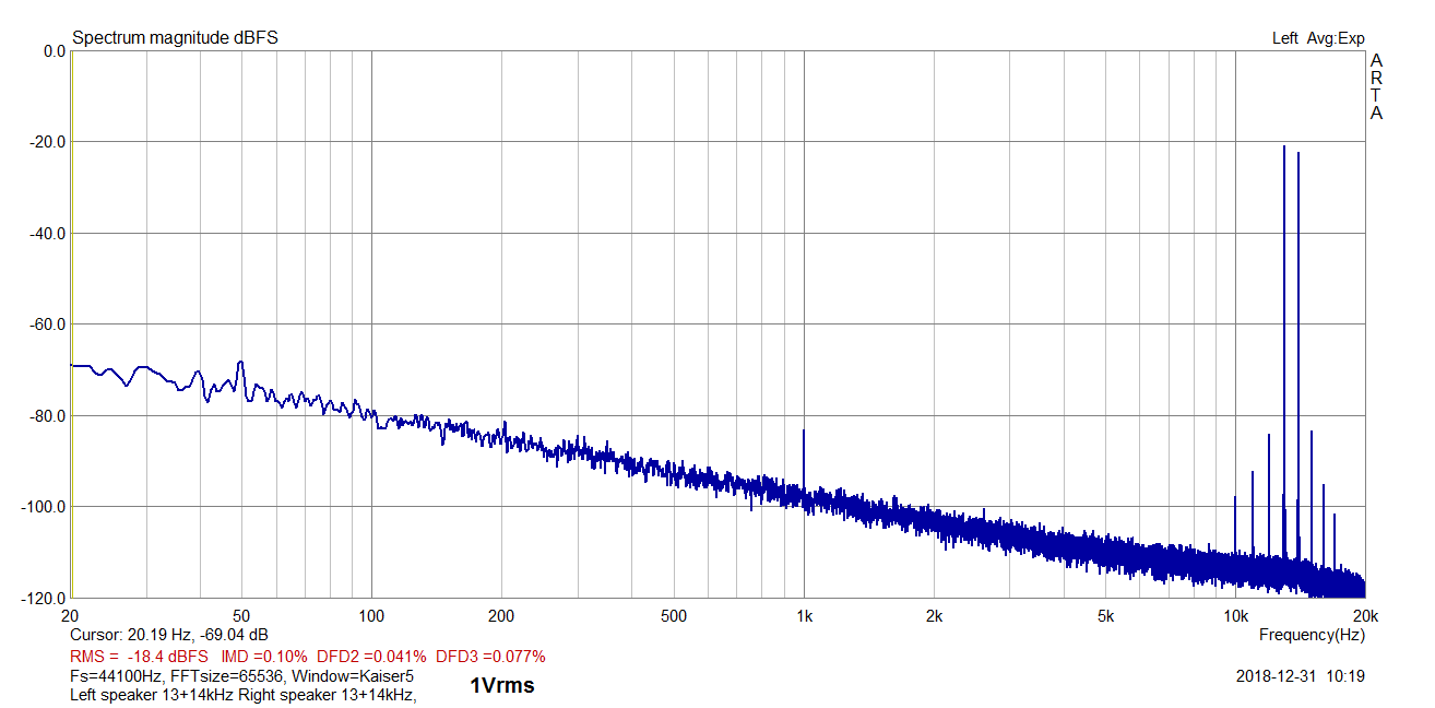

OK, one more tweeter/microphone IM test. Today is a quiet day, no background noise
Again, two tweeters, now SEAS T25CF001, playing 13kHz and 14kHz
1st plot, left speaker = 13kHz, right speaker = 14kHz,
2nd plot, both speakers playing 13+14kHz twin tone.
Voltage at each tweeter is 1Vrms. Measured at 1.5m distance.
Those T25CF001 are fine drivers, with low IM distortion.
It seems that mike+preamp H2 is about <= -65dB. H3 and highers are a non-issue.

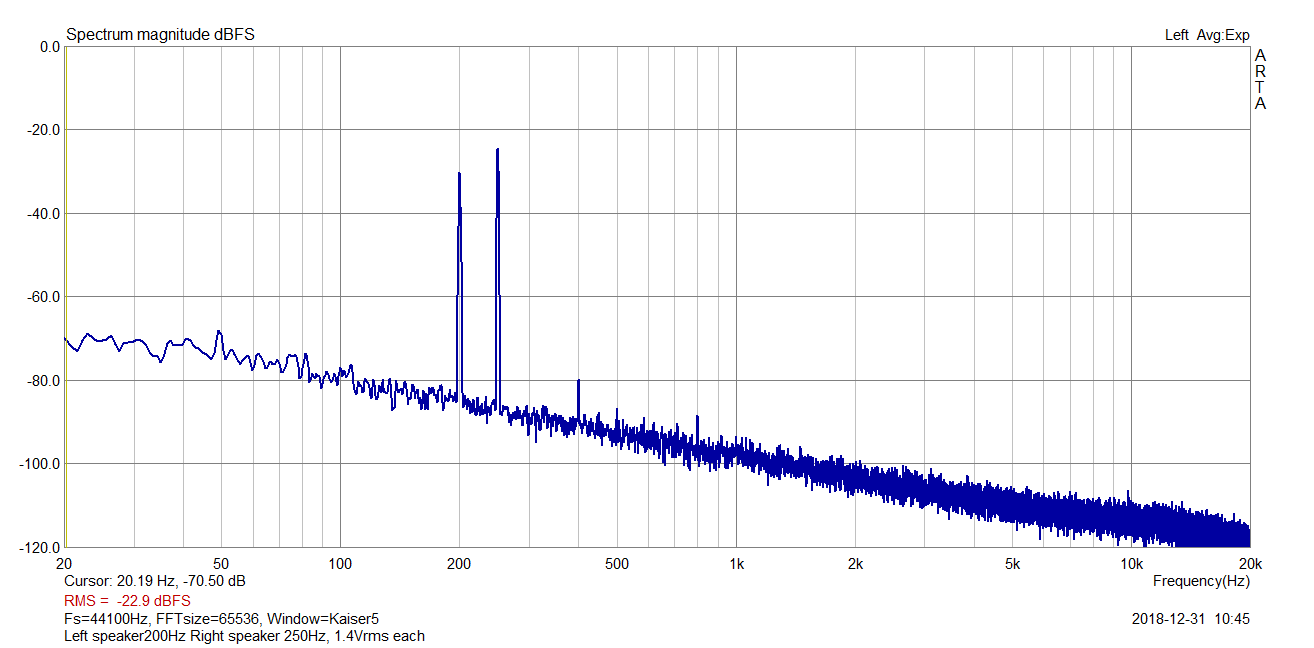

Same IM test, with SEAS W18NX001, 200+250Hz, 1.4Vrms at each driver. The measurements are almost "clean" in both cases now, when drivers are supplied with a single tone or a twin tone. Yes resolution is now lower than in a nearfield measurement, H2 difference tone may be hidden in noise.
