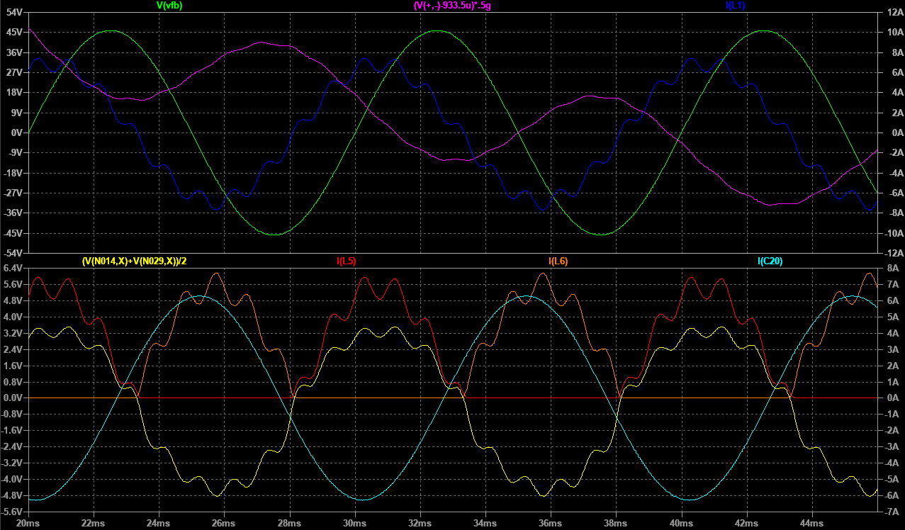

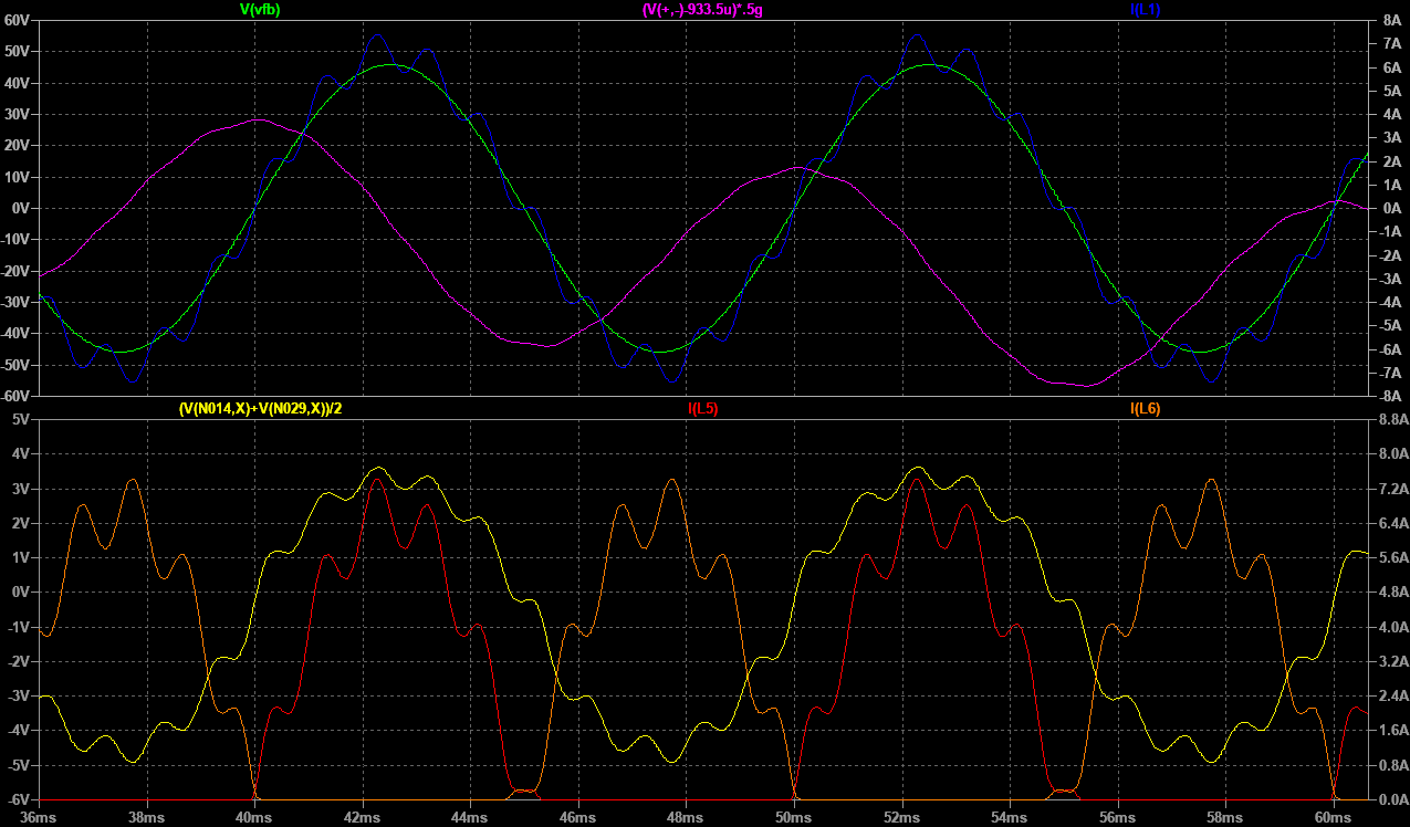

An amplifier has no trouble driving all quadrants as long as voltage and current margins are adequate. In the attached simulations green is output, blue is current, pink is the differential error voltage. Yellow is the gate drive voltage of both output transistors, orange and red are their source currents. These transistors have no idea they are in Q2. Compare it with the second image which is Q1. If the simulator is wrong about this then I can only suggest to stock up on canned food and stay away from everything electronic, which is already or will soon be on fire.

The question still remains, how you would get significant phase shift change without harmonic distortion, as such phase shift would immediately overload the VAS. A Cordell Distortion Magnifier would be just the thing to do this experiment, although you could do it with a good ADC and your computer's onboard sound. I've done it before while playing music and didn't notice anything.

My concern is with the physical wiring, which simulation is not setup to model. When an amplifier is pushing a hard load and runs through all four quads, the hf lower power current is being driven with alternate rails. So rail wiring currents are not simple, and the rail current magfield is not a good representation of output current. As you clearly show, the hf content is alternately being driven by two physical rails. If those rails were delivering current using either a triaxial or three layer stripline, rail magfield could be ignored. If the output stages are physically located apart, is the supply return current for each output stage field neutralized by return path proximity?
