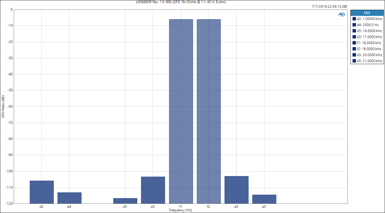

Not necessarily. General case can get quite complex and would depend. However, this can be sometimes be interesting in practice: IMD Measurement with 19 kHz and 20 kHz Tones - Audio Precision
No doubt you have seen the plots for particular amps. Sometimes quite a bit is seen at lower frequencies. But, it depends, I think we could agree. Also, probably a reason people mention cymbals as something that can be revealing of certain distortion problems. They can produce a lot of high level HF.

I'm not interested in the general case. I been talking about the specific case of high NFB at lower frequencies, but with 40-60dB less at 20kHz. I can't see this as actually being a bad thing and in this case it holds the IM distortion in the audio band WILL be supressed by the NFB. By inference I'm struggling to understand the advantage of having increased NFB at 20kHz and no one has come up with a good reason other than claiming they can hear ultrasonics.Not necessarily. General case can get quite complex and would depend. .
20kHz may be arbitrary. Again, where people commonly notice problems is with cymbals. They tend to produce a lot of harmonically unrelated frequencies over a fairly broad bandwidth. Some of it extends into rather high frequencies maybe at 20kHz or higher. Wherever in the frequency spectrum the problem arises cymbals seem to be one of the first things audibly affected.
