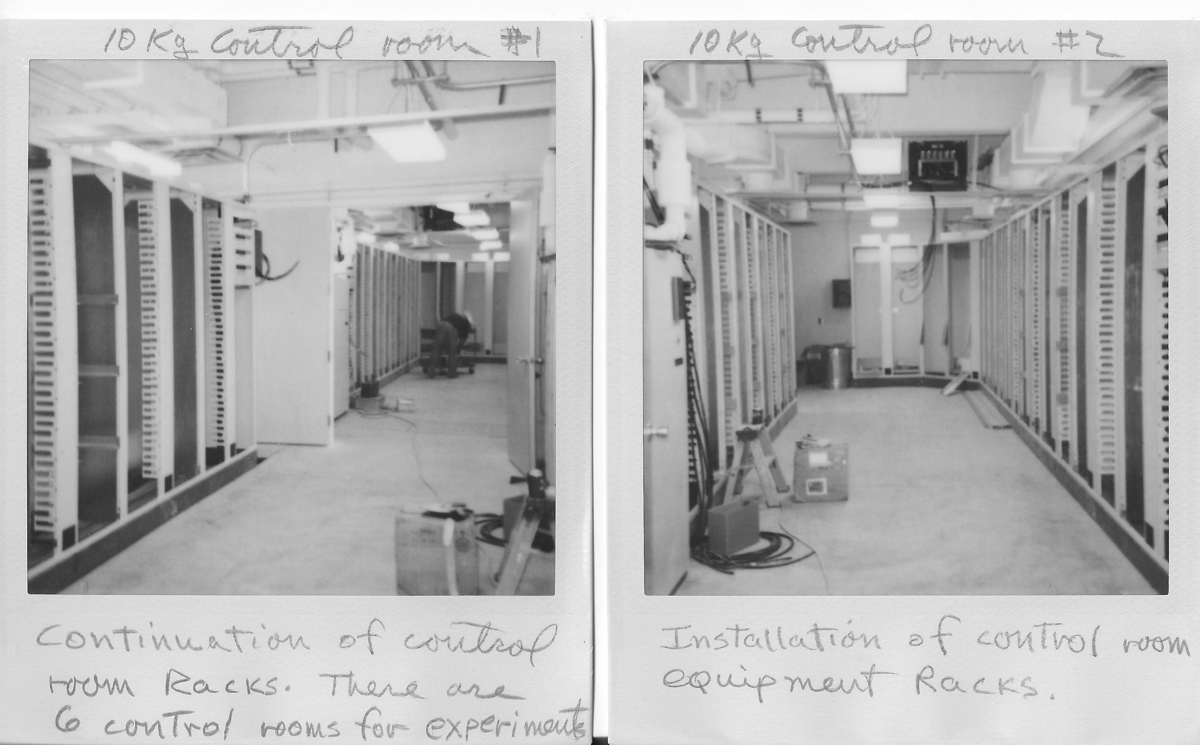

I cut my teeth on high power systems. Accelerators, Fusion energy …. From the 230KV sub-station to the accel PS and everything in between. From 120vac to 2 ea 230Kv 10MVA transformers 3 stories tall. And control room grounding, for computer room to console to machine. Plus the low Z building grounding and the experiment grounding. I coordinated it all - design, installation, test and did the low Z, grounding design for all systems.
Here is one of 6 control rooms for the 10KG H.E. control and diagnostics. One of 6 control rooms. Note the huge ultra isolation, triple shielded power transformer hanging from the ceiling to power these racks. A lot of equipment from floor to ceiling... grounding, wiring, etal. Power, control signals, diagnostics signals, their wiring and grounding of each systems.
[HE = High Explosives] BTW - 10Kg of the HE being created for nuclear weapons would flatten a reinforced concrete bunker. Which this building was itself. test was in a huge containment vessel/chamber. should a test chamber explode.. the building had designed in over-pressure paths to relieve the building pressure.
Blow up photo and look/read notes. I know a thing or two about power. You are not given the responsibility unless you are really good.
