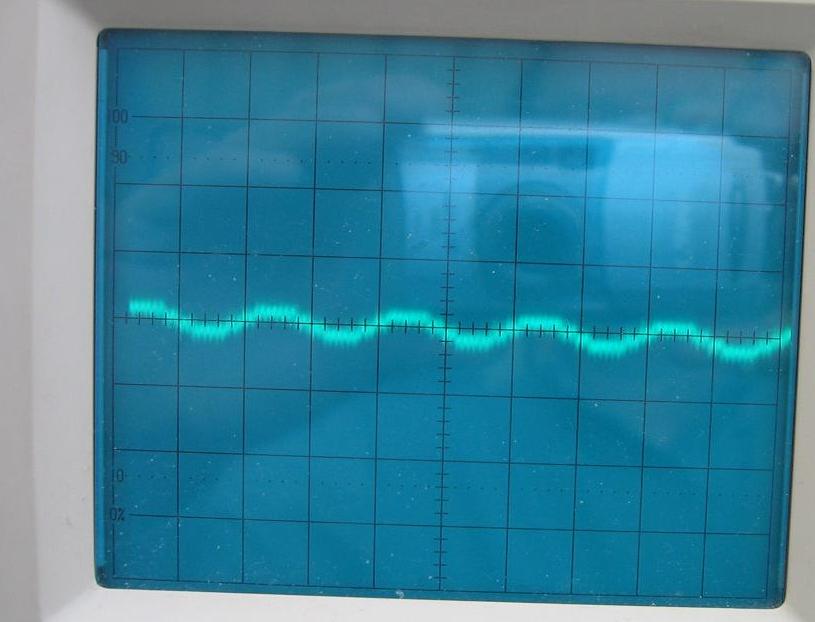

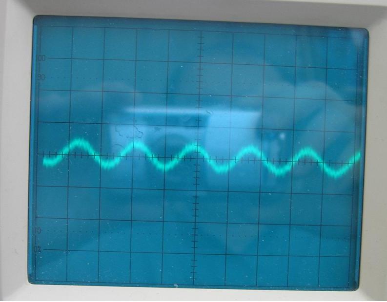

Here are three shots of a low level 1 KHz sine wave from a digital source (an AKM DAC in a sound card) running at 44.1 KHz. The level is -70 dB FS. The images are progressively wider bandwidth; 30 KHz, 80 KHz and 220 KHz. The noise dominates (the RMS level at 200 KHz is -58 dB FS) at the 220 KHz BW.
I don't have a quick way to insert different filters or weighting networks.
I'm not sure this invalidates the principles of delta sigma or if this really means anything. Even these images are "averaged" by the scope. It doesn't look pretty but to keep this in perspective try to capture a -70 dB sine wave from a turntable.
Do you know the slope of the filters? We can clearly see on the first that the dynamic range in 30kHz exceeds 70dB (because the signal is clearly larger than the noise), but we won't know by how much without knowing how steep the filters are.
Demian -
How was the bandwidth changed in your above mesurements?
Those are the low pass filters on my Boonton 1121 audio analyzer. I just spent an hour or so getting an antique B&K 1612 band pass filter with weighting networks running. I still have too much ground noise (60 Hz chassis to chassis leakage) to show the results but it seems the weighting networks do remove most of the grunge. I may try to clean up the setup in the morning to see if I can get better results.

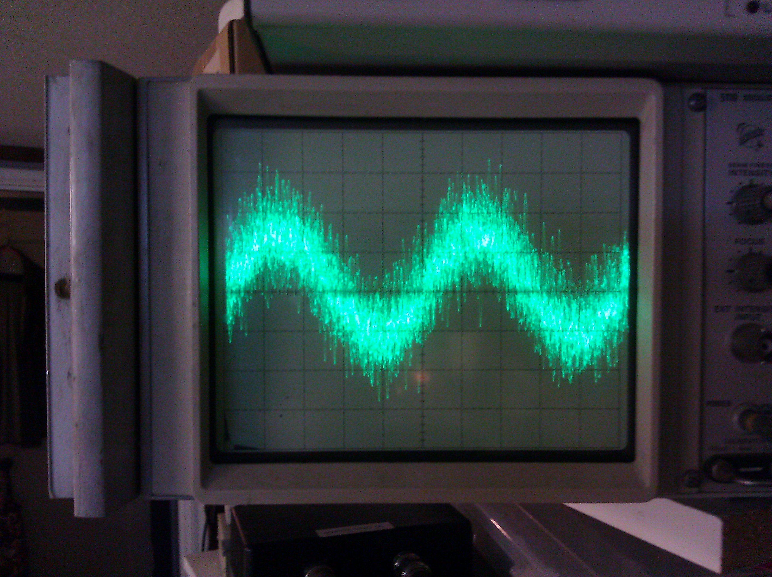

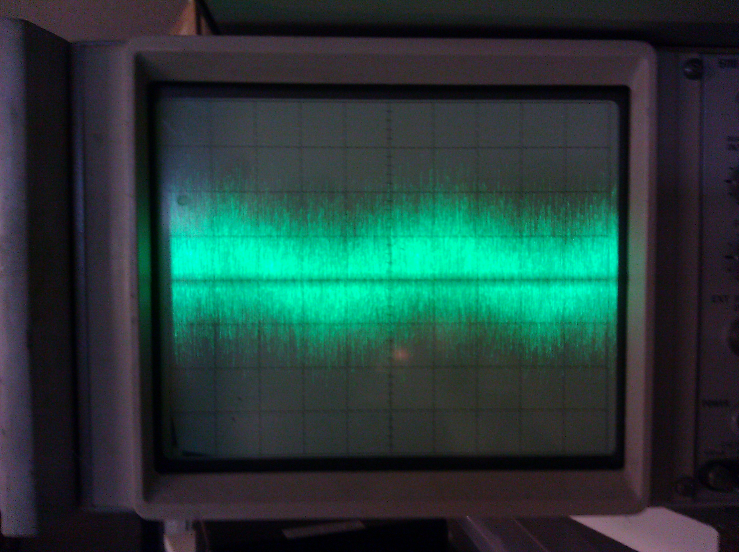

This is a -80dB FS dithered and not dithered sine from Marantz SA7001 in a CD mode.
They are 3rd order Butterworth filters.
FWIW the DAC chip on the card is an AK4358 http://www.asahi-kasei.co.jp/akm/en/product/ak4358/ak4358_f01e.pdf not a super grade chip. I may substitute a premium DAC tomorrow if I can squeeze in the time.

Why is the dithered signal stronger?
Yes I know, I know the plots, but have no snapshots. Just wanted to show lov-level CD sine in time domain, as frequency domain is not appreciated by some.
The dithered signal is stronger for the reason that it adds peaks that were cut by quantization. Scope image is naturally averaged.

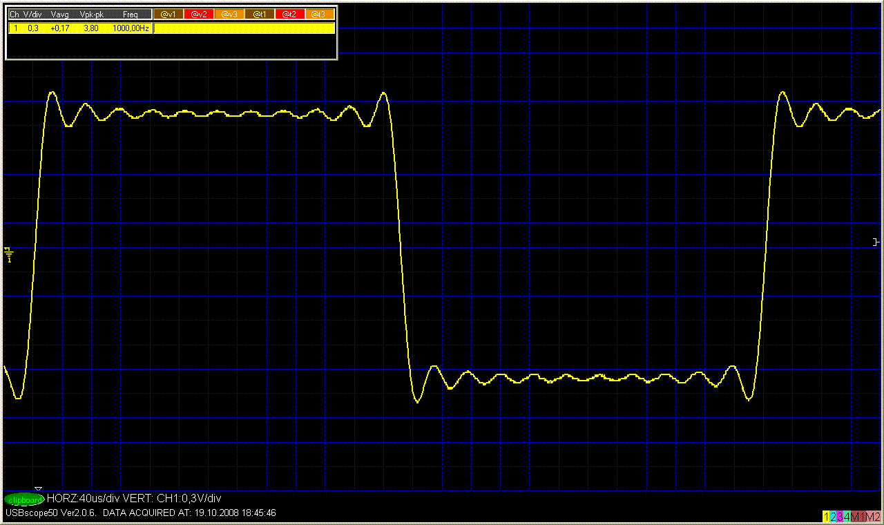

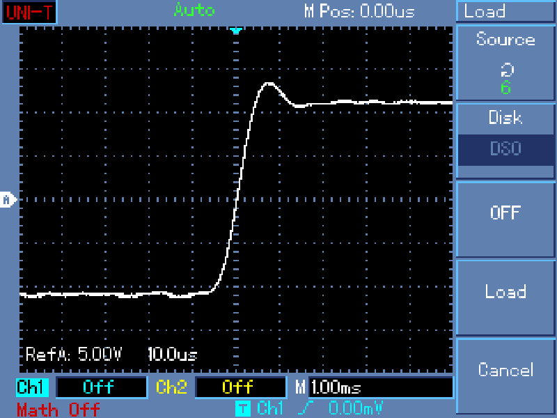

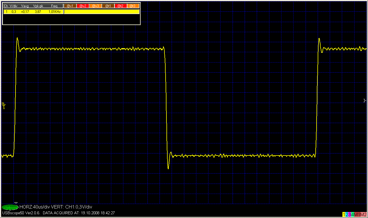

Interesting that only CD mode is using a linear phase filter, SACD mode looks to be min-phase.
I assume that SACD (DSD noise filter) uses 3-pole Butterworth. It is an analog filter, and according to recommendations it has cut off frequency near 50kHz.
Regarding frequency domain, I certainly did not mean you
Never done any wavelet analysis, though I am interested in it.
SACD rise time attached.
