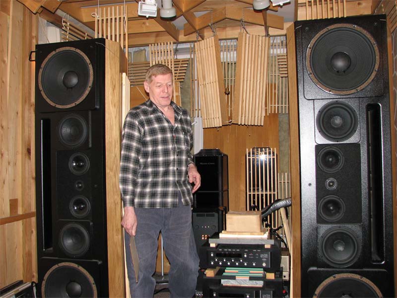

Other system's components were
CDP Mark Levinson, near 30 000 USD price tag
speakers Montana, near 80 000USD price tag
In picture...
In picture...
Yes, that is Makarov's listening room, small but good acoustically arranged, resembles a very big headphone listening conditions. The guy devotes all his life to understanding the puzzles of audio.
