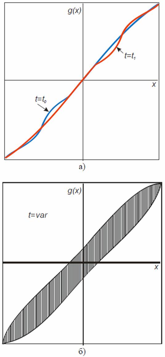

I would like to share some conclusions from one publication in russian, 2010 year, author is Chumakov.
He performed a rigorous mathematical analysis of transmission of information through a channel (an audio equipment). Analysis was focused on the transfer function. It was assumed, that TF can have some stochastic component (due to any reason, noise, parts distortions, PS effects, effects of GNFB, electro-magnetic disturbances, etc.).
The main conclusions are:
1) If the Transfer Function is strictly determined (has no stochastic non-deterministic component) there is no loss of information passing through the channel. Non-linearity of the TF does not cause loss of information. Human hearing can easily adapt to deterministic non-linearity, since hearing itself is non-linear.
2) Stochastic instability of the TF, due to, among other reasons, the "jitter" of voltage amplification factor, caused by limited velocity in GNFB loop, leads to losses of information, first of all, to losses in sibilants and transients - the most informative components of audio system.

I could only convert it into doc format and try to use google translation.
Here are some short translated parts of this paper:
Condition for the absence of information loss when converting the input X to output Y = G (X), including non-linear transfer function, is the presence of a single-valued inverse transform of H (V), reducing input X = H (G (X)).
Thus, in one transformation input to the output, a loss of information in a channel without noise does not occur, even if the transfer function is nonlinear.
Importance of this statement is not that any deterministic nonlinearity would not be noticeable by ear, but the fact that there is a fundamental opportunity without regard to the specific signal processing methods to obtain all the information at the output without a loss.
Consider what kind of distortions in electroacoustic channel
lead to loss of information and to the fundamental impossibility of receiving the initial information without losses.
If the signal in the channel is added by noise, the signal point is shifted from its true (expected) values. Since the direction and magnitude can not be predicted, the noise creates a small region of uncertainty around the "true" signal point. If, due to the effects of noise relation between transmitter and receiver is not single-valued - this is a mistake and part of the transmitted information is lost. Equation (3) just determines the number of potentially distinct areas of uncertainty for each dimension of the "web" receiver.
However, the unpredictable shift of signal point from its true position can be caused not only by noise, but also by other processes in the transmission channel. These random effects can be further reduced to an equivalent noise.
The fluctuations of the transfer function lead to the appearance in the output signal of
stochastic channel distortion, which can not be regarded as a change in metric space signals by random changes g (x). Stochastic distortion g (x) increases the uncertainty range around the "true" signal point and can be interpreted as an additional random noise and reduces the possibility of signals recognition.
It should be noted that the products of deterministic distortion do not enter into the specified formula, as expression (4) determines the potential maximum signal recognition capacity irrespective of the methods of signals processing. This implies an important difference in the influence of deterministic and stochastic distortions on information possibilities of electroacoustic path: Products of stochastic distortions can not be compensated by receiving information and lead to a reduction of information bandwidth. Thus, the presence in the transmission channel of stochastic components, regardless of their nature (additive noise, random modulation transfer function) decrease the bandwidth.
Information density of different genres of music signals and its individual components (instruments, parties, votes) are very different between themselves. In theory, the transfer of information is determined by the product of the signal band and its duration B = WT. Spectral analysis of sounds of different sources shows that a large information density have noise-like signals, such as sibilants, percussion (cymbals, brushes), and
and transients (attack transients). The smallest information density have tonal sounds with a small number of overtones.
