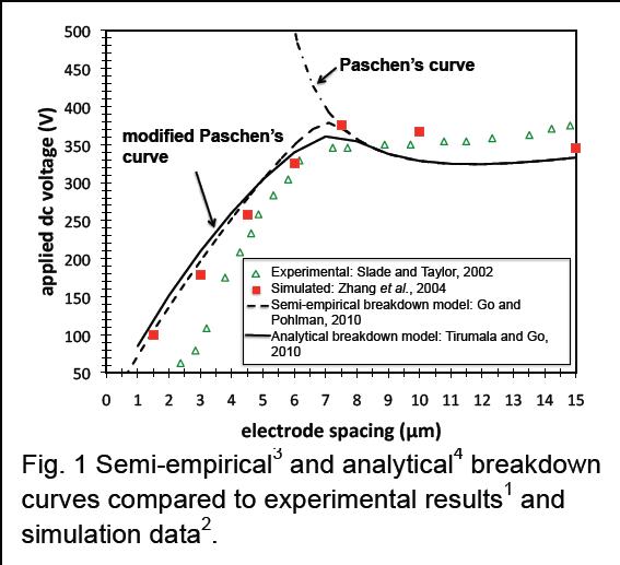

1V is used as an example. For the others here is the curve Scott is referring to.

There is nothing I know of with a bandgap low enough to do this. That and the fact that these mechanisms have large temperature coefficients makes these plots (stable) very unlikely. When you can I would gladly try and help explain what you are seeing, but I firmly believe you are being fooled by something unrelated. Also as I mentioned read up on Pashen's Law and signals "jumping" small gaps. The breakdown voltage of a 1 micron gap would surprise you.
Keeping "dirt" reliably less than 1 micon average size would be difficult, even so still in large volts regime.

Wow, and how do sparkplugs work, Scott?
High voltage arc. Follows Paschen's Law. Important stuff if you're handling multikilovolt signals. You're not doing that, though, are you?
Actually long ago I was in a group working on a semi-high power laser It ran at 22kv 200a around 3 pps. The trigger used a krytron for the first stage switch. I had not only never seen one before, but had never heard of one. Of course that was because they were I think still classified as secret (Lower Level).
So yes during that project I also learned a bit about the breakdown of air. One fellow got his PHD photographing how punch through in air actually happened! Really neat pictures!
I am less worried about air gaps as I am oxide formations on the surfaces of what should be mechanically connected components. How do you make a variable resistor without a wiper and associated problems?
