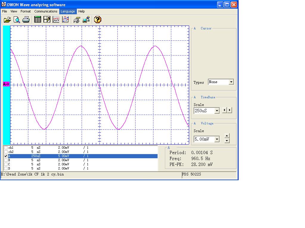

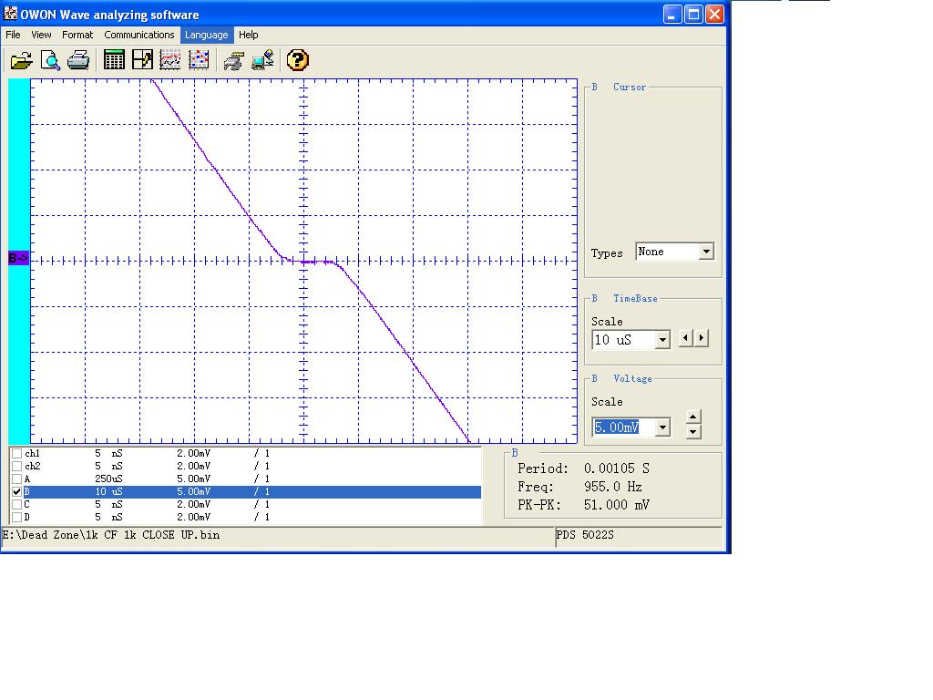

The curves you refer too are not microdiodes. Lets be clear that diodes always conduct although it is not linear as per voltage versus current. There is another issue (dead zone) and when I get a bit more along I'll show more.
The issue of oxide's forming diodes was a specific cable test and there were no changes noted at a level at which distortion in the interconnects was noted.
The VI curves would indicate rectification at a proper bias, in many tests this would be indistinguishable from diode-like behavior.
That is an interesting interpretation. I think the dead zone is symmetrical, although it may not be so. I think that any bias turns it on. So if the dead zone were say a volt and you biased it to a volt then a -.1 volt application would be linear down to .9 volts or a .1 volt application would raise it to 1,1 volt. But if you applied -1 volt then the dead zone would reappear until you hit -2 volts or back to zero, so it would be more of an offset to my view rather than a gate (Diode.)
As usual I await your tests, 1V "dead zones" would hardly have passed unnoticed till now. You would do well to read up on Paschen's Law before speculating on charges jumping a small gap.
1V is used as an example. For the others here is the curve Scott is referring to.
