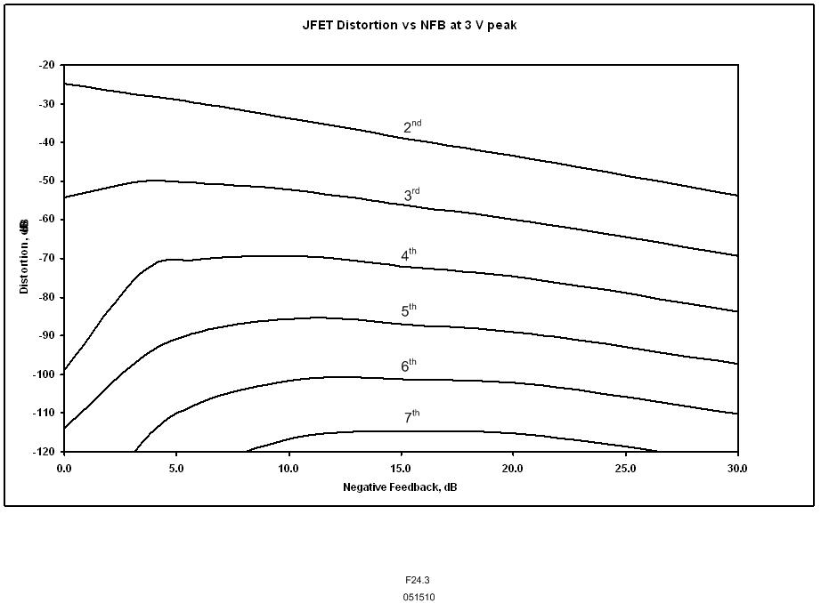

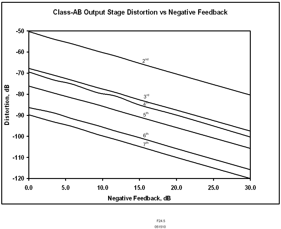

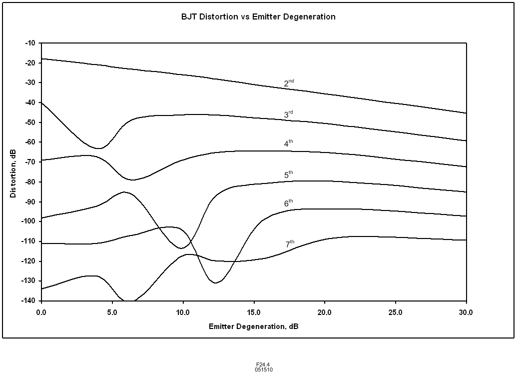

Hi Jan,
Unfortunately Bruno did not tell the whole story on the "Baxandall distortion". The three figures below are from Chapter 24 in my book. The first is akin to Baxndal's, where the distortion of a single JFET stage is shown as a function of NFB. This shows the effect, where some distortions increase until the NFB reaches about 15 dB.
Unfortunately few amplifiers are built from a single square-law device. BJTs themselves are of course not squarelaw. The second figure shows this distortion effect for local negative feedback in the form of simple emitter degeneration of a single BJT stage. Yes, even NFB in the form of "benign" emitter degeneration shows the effect!
As explained in the book, the point at which this distortion from a given stage decreases depends on the total amount of NFB around the stage, including all forms of local NFB.
Finally, the effect is not even seen in the more complex situation of an output stage, where increasing NFB ALWAYS reduces all orders of distortion, as shown in the third picture from my book.
So much for this distortion in the real world. It is largely a red herring.

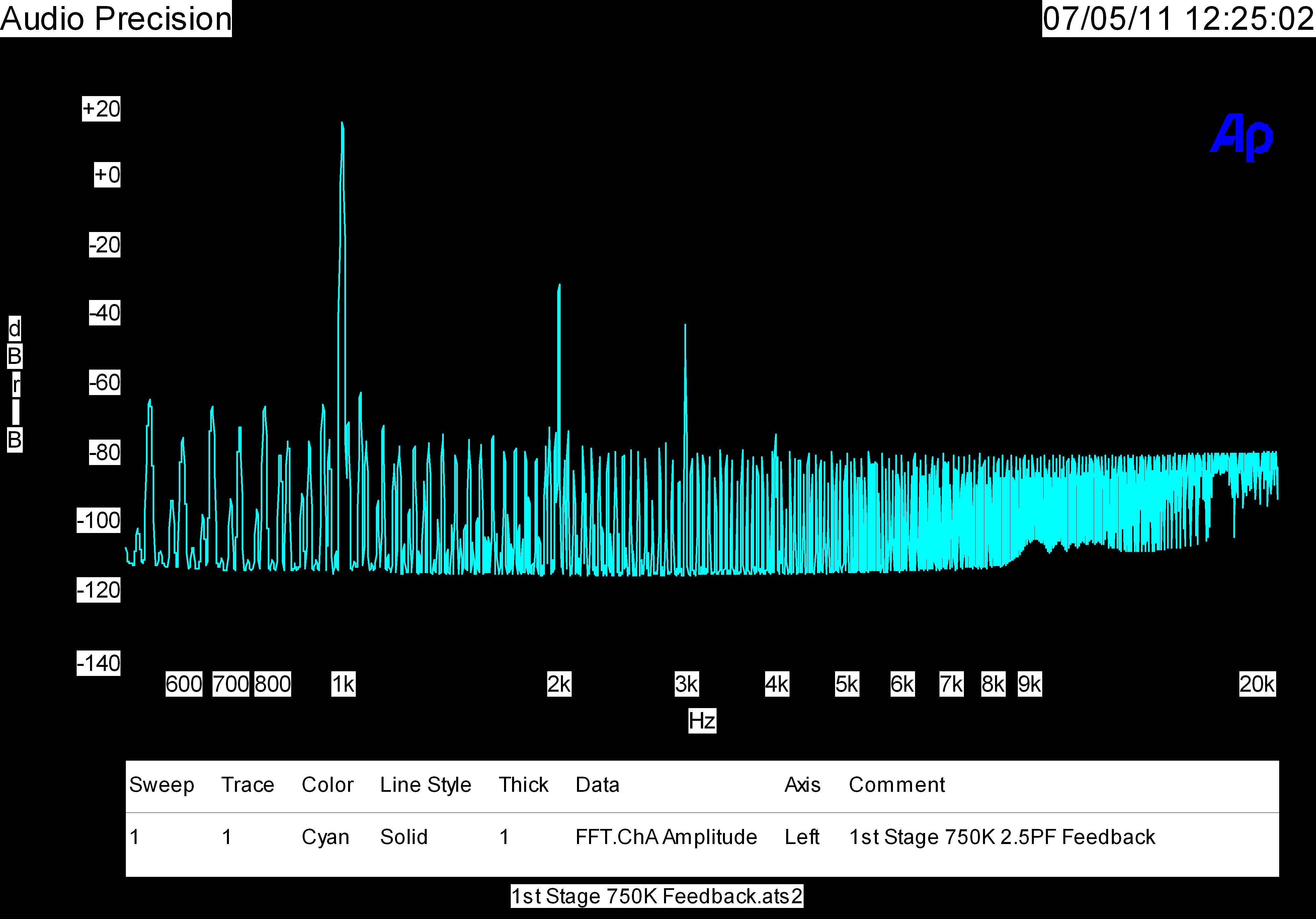

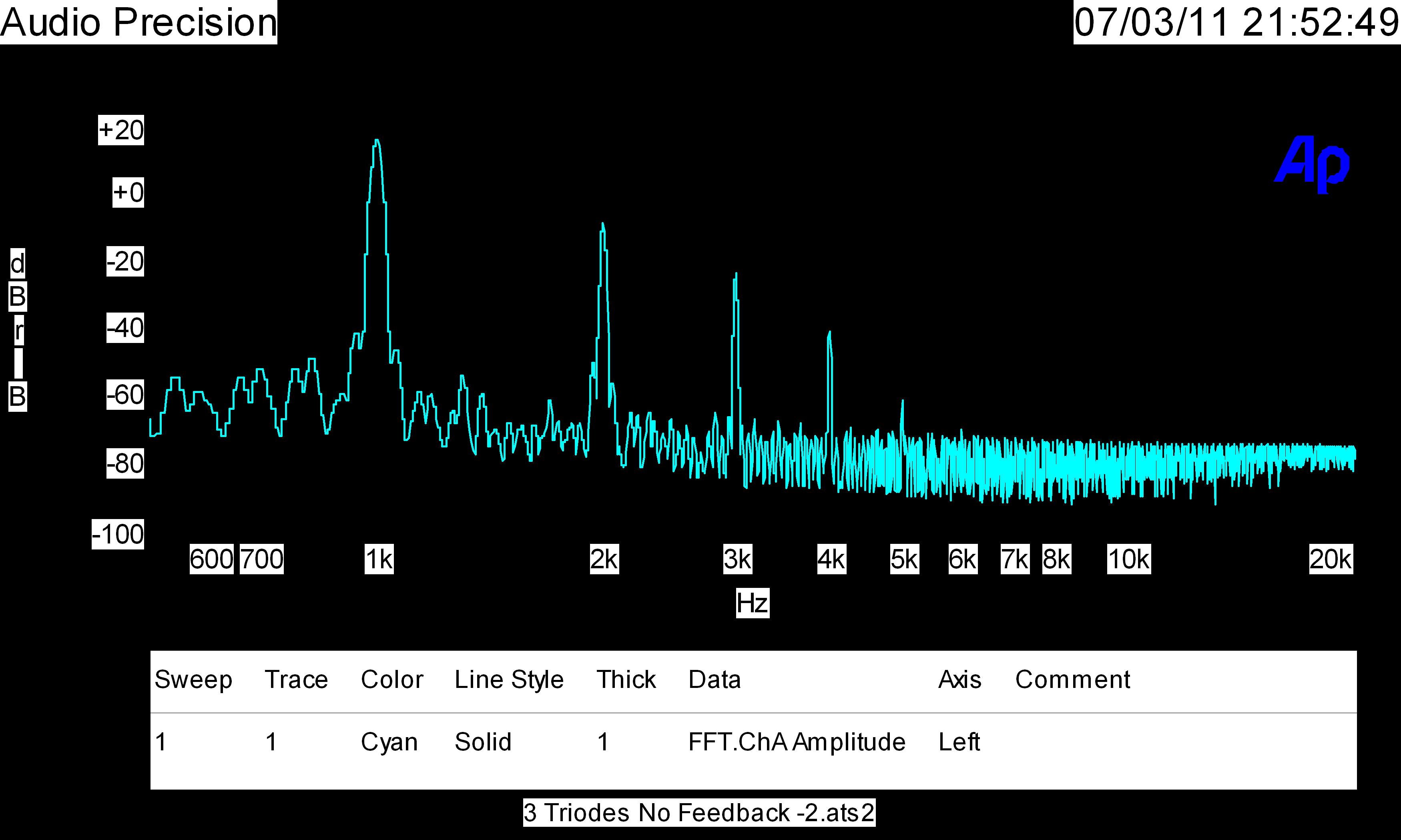

Well. it is nice to see a good technical discussion! The amplifiers with grid leak bias have three different operating points. The first stage has about 50 volts swing the middle 25 and the final 60!
When I do global feedback on the three stages the results are terrible. The first stage shows a very distorted waveform, that gets amplified by the following stages all out of clipping.
Attached is the slightly surprising distortion of three stages of amplification and a single stage with "Global" feedback via a 750K resistor bypassed with 2.5 Pf.

Well, with multiple zeros, not staggered, and multiple poles, also not staggered, this is no great surprise.
Thanks for one obvious conclusion, I think there are many more from what is shown.
I like the missing IM products!
Oh yeah the feedback works exactly as expected!
Ah, I did not analyse the circuit not enough. As shown your results are not surprising. The two stages that have the most distortion are in phase with each other, so are the distortion products, so the they add and the effects of distortion cancellation and multiplication are reduced.
While the feedback you described is looped, it is NOT global, it is local.
The results of the feedback case is also unsurprising, as the linearity of the stage that combines signal and feedback is poor.
Try it with the levels and distortion levels increasing from stage to stage with most in the final stage, so that it more represents the way a real amplifier works. Using a circuit with equal levels in each stage may also be be rather interesting...
Ciao T
Looped is a good term, I wanted to make it clear it was not a cathode resistor.
Yes one of the issues to be demonstrated is how a high gain low distortion amplifier can be used to reduce overall distortion of a complete system.
Also how ganging two high gain stages may not offer advantages.
Right now I am still adding to the list of tests to run.
I am changing scales to get detail, when I do publication runs, I will try to keep scales the same, but this is still a work in progress.
I used above the following nomenclature:
1) Degeneration = non-looped local current feedback (unbypassed Cathode/Source/Emitter resistor)
2) Local Feedback = (voltage) shunt feedback looped around a single active device (which is not an IC)
3) Global Feedback = (voltage) shunt or series feedback looped around two or more active device (or a single or more IC's)
Try to come up with some no-one has yet done.
Sure, but side by side visual comparisons are very powerful tools, if the plots are comparable... So consider this a "pretty please" from me. You can always add a zoomed version to the set...
