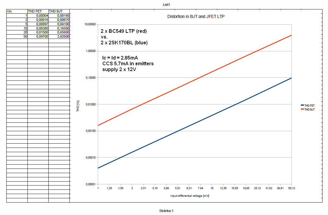

Hereby the summary - comparison of THD in bipolar and JFET LTP, for input differential voltage from 1mV to 50mV. Above 57mV, the bipolar LTP starts to clip.
It is just THD, not THD+N. For noise analysis, please consider the part used. With 2SK170BL, you can get about 0.8nV - 1nV/rt(Hz) of equivalent input voltage noise. In a real life application, you may be somwhere at 2nV/rt(Hz). This is very hard to obtain with degenerated bipolar input. The aim is to show that input JFET LTP is much more linear and that it can accept higher input differential voltage. This is of course well known, but maybe some people sometimes do not realize the real numbers.

Hi PMA,
As you know, I prefer JFET input pairs on power amplifiers. However, when BJT input pairs are used, I do degenerate them by a factor of 10, which you would probably describe as heavy degeneration. It is certainly true that degeneration adds voltage noise to the input stage. However, for a power amplifier, 5 nV/rt Hz input noise is considered very good. This is not difficult to achieve with a heavily degenerated BJT input pair.
BTW, speaking of multitanh BJT cells, I describe a JFET cascomp in my book Designing Audio Power Amplifiers in Figure 25.13 on page 522. Although the JFET does not follow the BJT tanh behavior, the cascomp principle applies equally well. It reduces distortion by a factor of 6:1 at high signal levels as compared to a conventional JFET LTP. I have not seen the JFET cascomp described anywhere previously, and would be interested in any available references to it that you might be aware of.
Without knowing the gm of the BJT respectively JFET LTP stage, your figures are not really convincing, at least to me.
Also, what about a comparison of the two LTPs, based on equal output current, instead of equal input voltage?
If you kindly read older posts, you would find comparison with equal output currents
And you can see parts used and idle current.
And the Gm could be read even in the older images.
Last but not least, it is the input voltage that counts. Output voltage divided by LG at frequency of interest defines input differential voltage of the feedback circuit.

But heavy degeneration of input bipolar LTP increases equivalent input voltage noise. We do not want it. 2SK170BL input pair would have lower voltage noise than bipolar with emitter degeneration. Not speaking about input current noise of the bipolar that is VERY unwanted.
Why not to consider multitanh bipolar cell rather than degenerated bipolar LTP.
PMA, I agree the degenerated bipolar is noiser. Tanh pair I need to try - I have not used that technique.

If you kindly continued reading, you would find comparison with equal input voltages
I asked: what about comparison with equal output currents.
