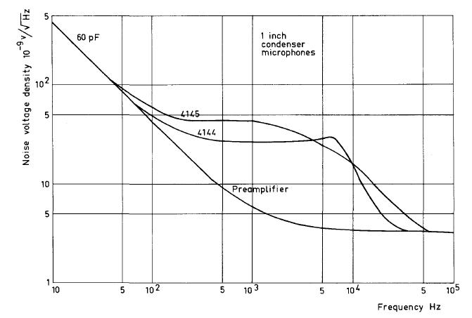

How fortunate microphone preamps don't have these problems. Do you think their designers know something phono cartridge preamp designers don't?
You won't get below the background noise level of the big bang. Liquid nitrogen isn't cold enough. Try liquid helium.
Pure physics, the brownian noise of the air on a stretched membrane is easily computed. It is rarely possible to make a useful microphone that reaches the limit of audibility, but the electronics piece of the problem is relatively easy. A picture is valuable to make this point, these are 1" B&K curves actally presented in nV for comparison.

Of course, microphone preamps have similar problems. That is why Wilson Audio and Crystal Clear Records hired me to design their microphone preamps, many decades ago.
How fortunate that when you listen to the .0000000000001% of all the phonograph records out there made by WA and CCR your phono playback preamp won't be the limiting factor for noise. But for all the rest of them that had the misfortune to be recorded using brand X microphone preamps, well we'll just have to live with their hssssssssssssssss, won't we. BTW, living in SF the way you do, what is the background street noise level you have in your house? If you keep the windows closed what is the background noise level of the air conditioning system, heating system, or the neighbor's TV set where you listen? Me, I live out in the country where the air is clean and clear, the water pure, and the only sounds besides the birds twittering...is all of the systems like the forced air heating and air conditioning equipment that makes my house liveable. Now of course you're going to tell me that even though the preamp noise is below the background noise floor, it's effect is subliminal? There's a good ad slogan for you; "my preamp is so good you can't hear how good it is."
Yes, Scott, and if that graph is a very OLD one, then I improved the S/N of the electronics by as much as 10dB and INSISTED that B&K follow my example. They did, and all the new electronics is 10dB quieter. It was not an 'easy' sell, but their OWN independent measurements proved me right, and they quietly upgraded their preamp the 2619, and I have the B&K measurements that prove it.
Who says that you have to live with mediocrity?
Nope, please read the plot and do the math 82nV at 50Hz is 50pF and 10G Ohms. So please present your data. A 1" capsule does 5-12dB SPL self noise there is no way to improve it. There are dozens of mikes at the limit of the capsule thermal noise.
Well, then they stopped using 200 Meg ohms. and went up at least 10 times in R. Do you really want me to 'rub it in'? I realize that you think I am boasting (as usual), but I have the proof. I might have to use my buddy, Ed Simon to help me put them up, but I will, if necessary.
