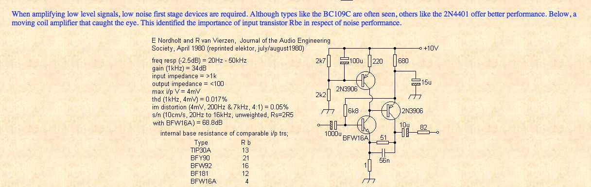

I had a long discussion with Burkhard Vogel and he told me that the Hitachis are not that good as advertised. He measured an rbb`of 14 Ohm. The lowest rbb`he measured was the Toshiba 2SC3329 with rbb`of 2 Ohm. The second best was the BFW16A, an old stablemate.
It has an rbb`of 4 Ohm at 25mA with hfe of 35. It translates into 0.28nV/qHz. fce is quite high at 250Hz. A circuit was shown in "Ultra-low-noise Preamplifier for MC phono cartridges " Nordholt & van Vierzen, 1980.

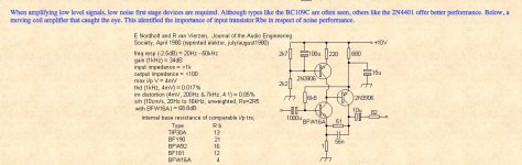

Here is the circuit i mentioned.
Higher noise than I remembered. 50nV/rt Hz.
