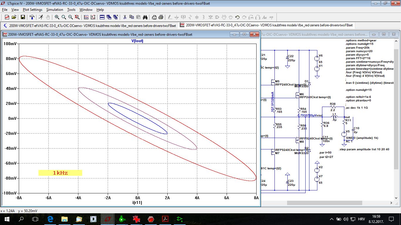

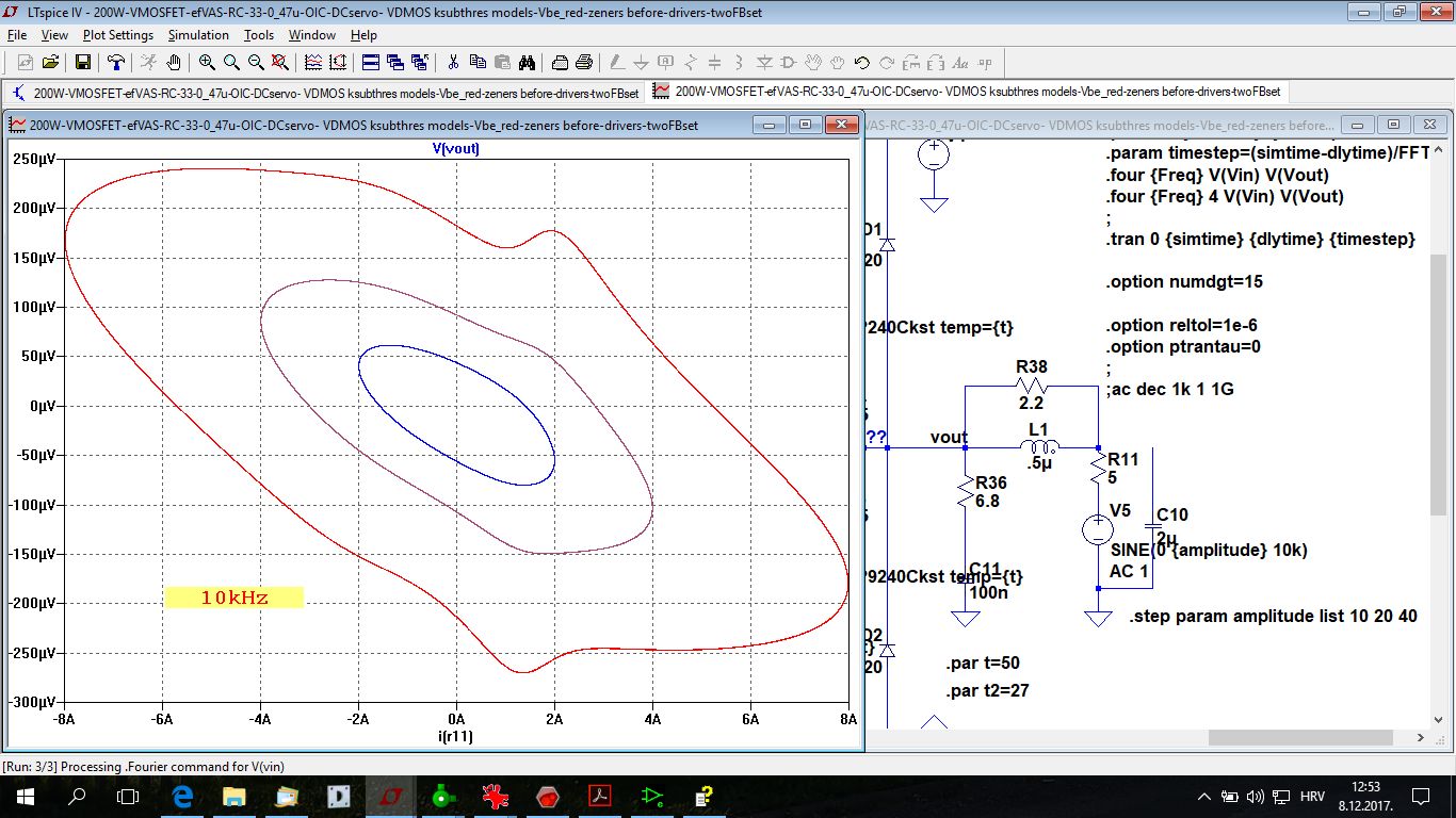

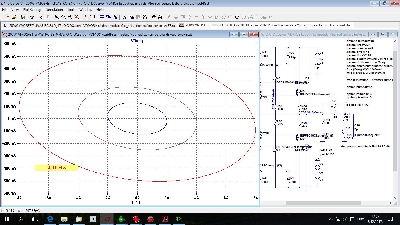

This does not reflect output impedance non-linearity. It is just OL output impedance divided by feedback factor, no level dependence shown.
In case you are interested not only in nice plots, but also in something more useful, put the voltage generator not to the input, but to the output, via say 5 or 10 ohm resistor. Inject sine current of 1 - 10A into the output, measure current injected to the output and voltage at the output terminals of the tested amplifier. You can also make an X-Y plot of output voltage vs. injected current. Make this at several frequencies and then you will see output impedance nonlinearity.
Something like this?
Yes, exactly! Very nice results. You will see that in the real amplifier even the connecting wires to rear panel speaker terminals will make a difference. Similar as in case of simulated THD x measured THD. Enough to move "Vout" node behind the output inductor in your sims.

IMO it is the test that has smallest requirements on test equipment and same time probably most revealing about power amplifiers. More than THD or IMD spectra. Easy to understand and easy to interpret. Little bit similar to distortion residual measurement. It shows what is most important for output stage linearity. Is it the number of output pairs? Or is it rather VAS nonlinear load, that may be reduced e.g. by 3EF topology? What do you think? ;)
Though number of output pairs is important, good driver and especially very light VAS load seem to be most important.
Possible audible consequences with speaker load? The more difficult speaker load, the more important are smooth and low (dv/di) curves. No spikes that would indicate to output impedance discontinuity or switching delays.

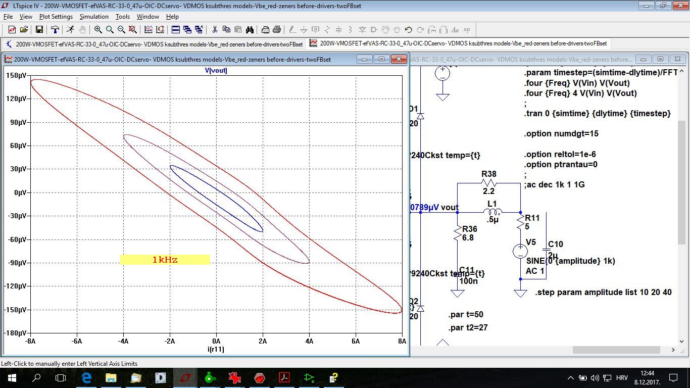

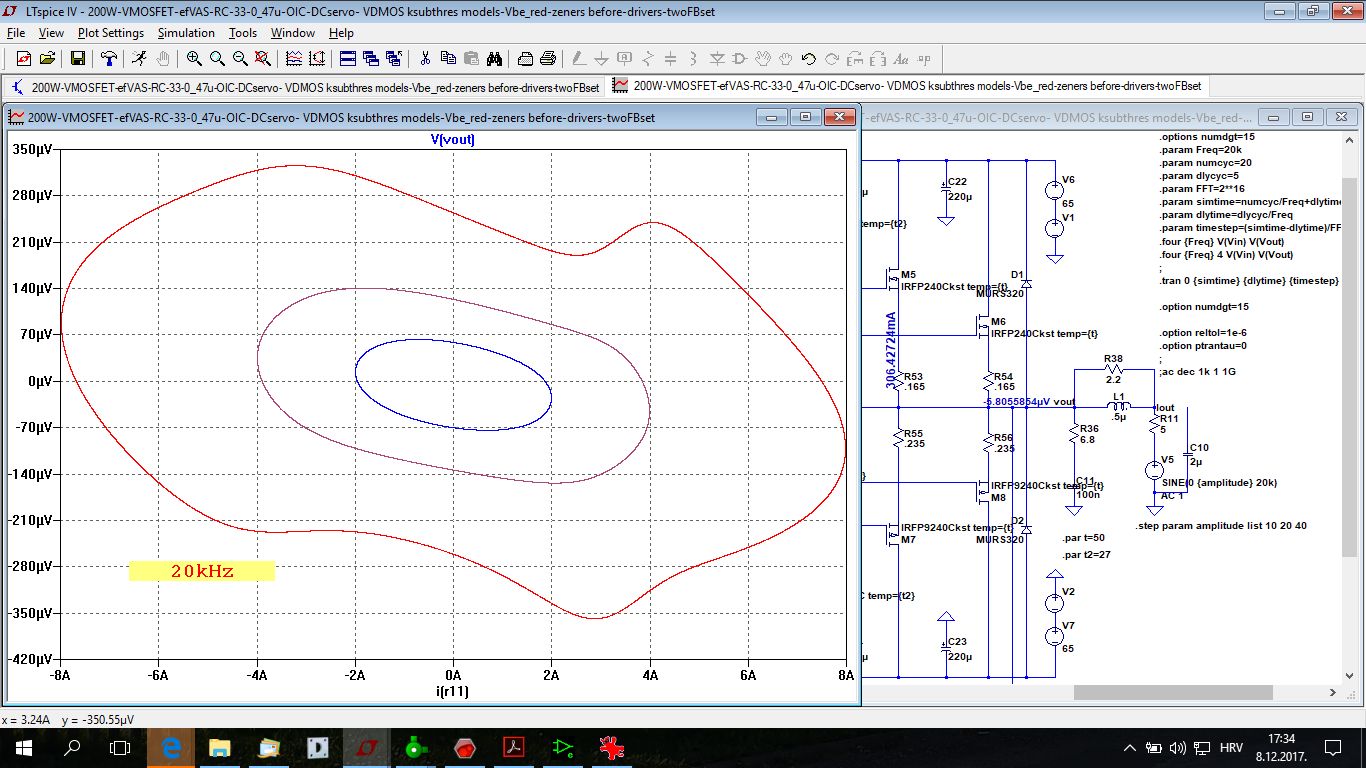

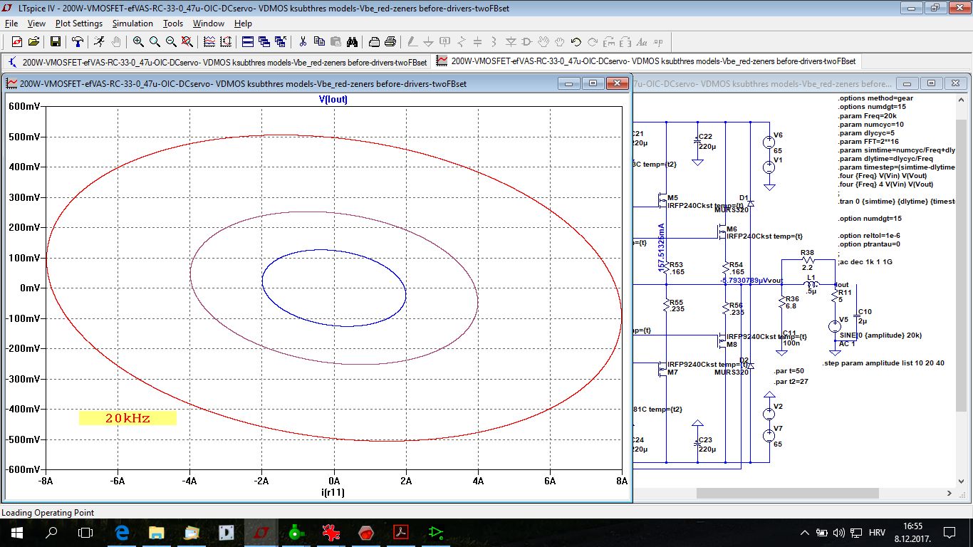

This is after output inductor. Last one was with 200 mA bias.

As you have the schematic in sim already.... how would more OPS devices change things and Vas?
I am not sure how this test can be used and the consequences of what is shown. PMA thought of some.
The shape doesnt bother me so much but any kinks in it does.
Does bias in OPS affect 'kinks' ?
THx-RNMarsh
Richard, VAS is the best BJT available. The bias certainly affect 'kinks', here is with 300 mA.
