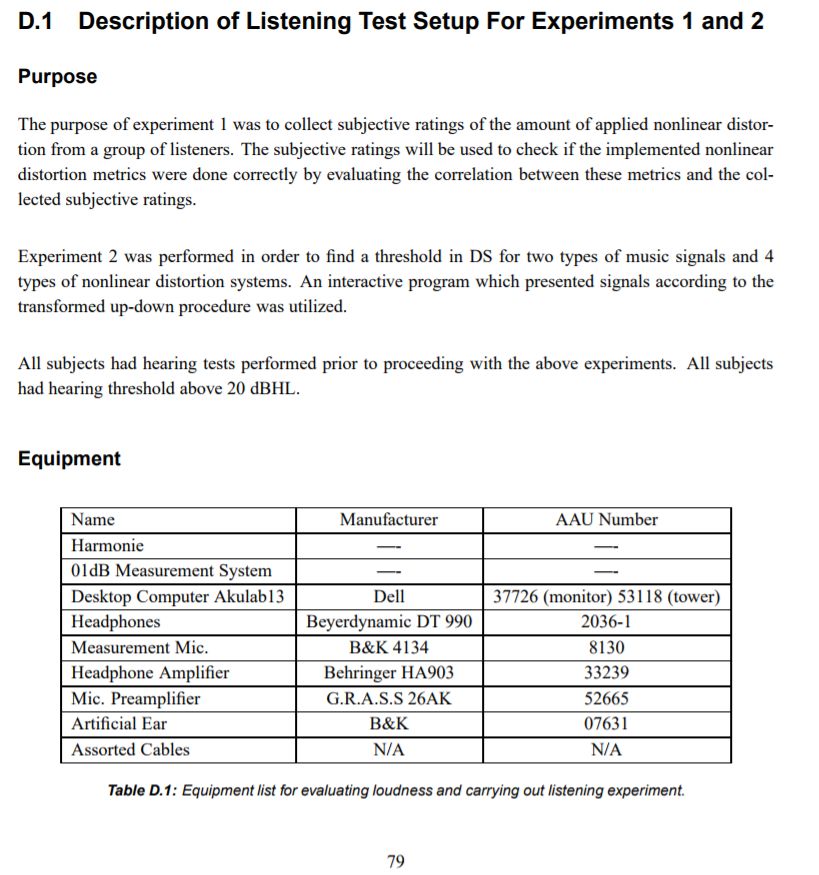

Did they use the built-in sound card in that Dell computer listed in the attached image below? Behringer doesn't appear to have a manual or any reference to that headphone amp. The headphones appear to be of intermediate quality.
I guess I'm kind of skeptical the test equipment they used might not contribute significant distortion of its own to the test, as well as possibly mask low level distortion of test signals.
I really have no idea what they used. The thesis is here:
https://projekter.aau.dk/projekter/files/9852082/07gr1061_Thesis.pdf
I read that and as Earl said not long ago...
The bottom line is that it is the nature of the nonlinearity that matters NOT the THD level. Electronics crossover distortion can be audible at .01%, while loudspeakers can be inaudible at 15% - it all matters on the nature of the nonlinearity. Basically distortion in a loudspeaker can easily be made inaudible while in an amp it takes some work.
LP's at their most horrifying almost never reach 15%. Mechanical systems have mild asymmetry (evens) and soft compression (odds) but no abrupt discontinuities like crossover. These things are far less audible than people think.
