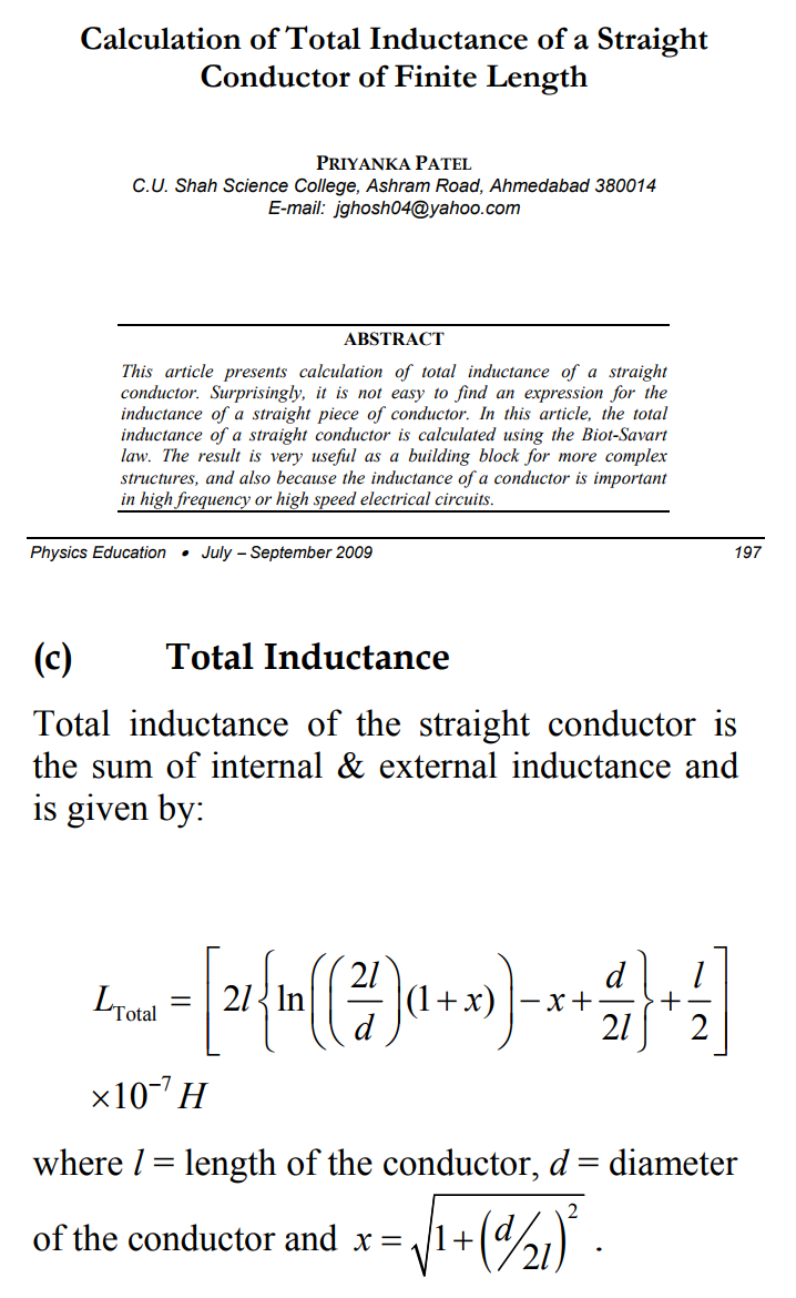

And, according to Grover + Rosa + Patel, the self inductance of a straight cylindrical conductor of diameter 1mm and length 300mm, is more than three times the self inductance of a straight conductor of diameter 1mm and length 100mm. Inductance is a superlinear function of length.

For real wire pairs, using infinite length numbers works very well because there is field cancellation of the bulk of the field and what remains is strictly linear with length. That linearity begins to fall down when the aspect ratio gets low. Terman covered that with the third term of his formula.
For the internal inductance, the author played fast and loose with the math, used A and B for ends, and B for flux..sloppy. The end result was a specific number, but the length of the wire attributed to that value was not mentioned.. like, this much inductance "per foot".

It was good. And clearly explains why it is superlinear (love it) at the dimensions discussed, as the part that is not contributing as much flux, the ends, is not what grows as the wire lengthens.
Note equation 14 and the text following. For the twisted pair, a real world example, he shows linearity with length with the caveat about aspect ratio.

Patel's article from Y2009 uses modern notation and arrives at the same result
Sorry about the 3 different magnifications of the 3 different copy-and-pastes. My browser and my screen capture sw are not cooperating this morning. Click once to remove compression-distortion, and click on white X at lower left for full size imagery.
