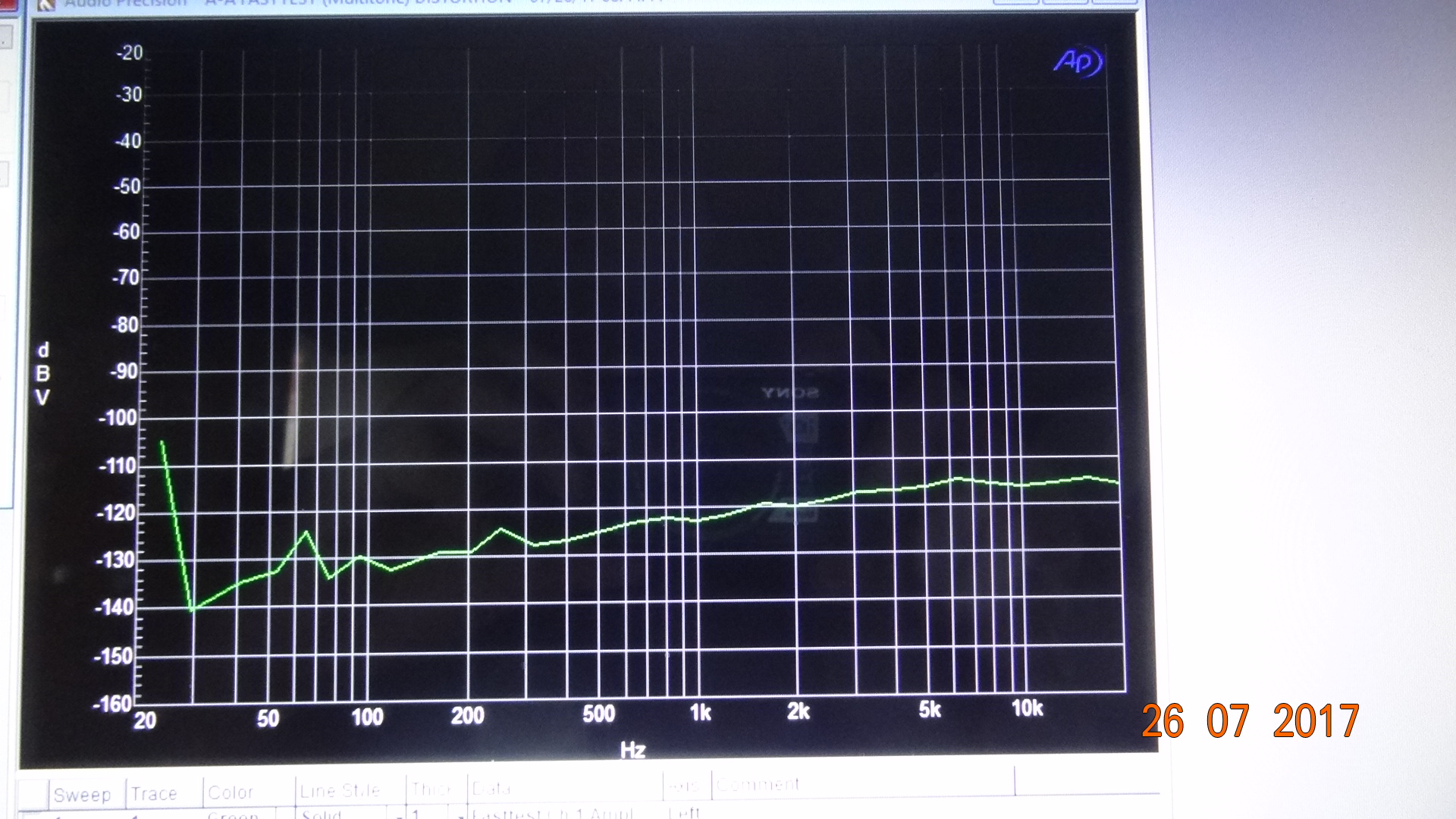

Ok a base line for more multitone tests..... for those who haven't seen such on an A-P ---

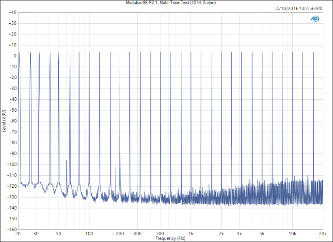

Richard: I'll take your blur and raise you a legible multitone output from an AP courtesy of TomChr (which I have posted before). Note this is just a 40W LM3886 based hybrid, but it's still lower distortion than the average pre-amp. MiniDSP is many times worse.

That is great performance...... Now try this.... apply multitone to the source (via DSP?) and output to a preamp and thru power amp all together and what does it then look like at the output. ??

I don't understand the question, first of all the crest factor of the multitone is a potentially large factor in the levels possible, second the source material would totally obscure the noise floor and I can't see any information from such an experiment.
You could take source material and add deep holes in it and see the infill, Dean Jensen did this ages ago but now with DSP you could do much better. I have some examples on Jan's site, one could easily take any piece of music and create holes <-120dB down at any intervals you want. Personally I would take a whole minute of music sampled at 96k and do it with a 5.7M point FFT.
