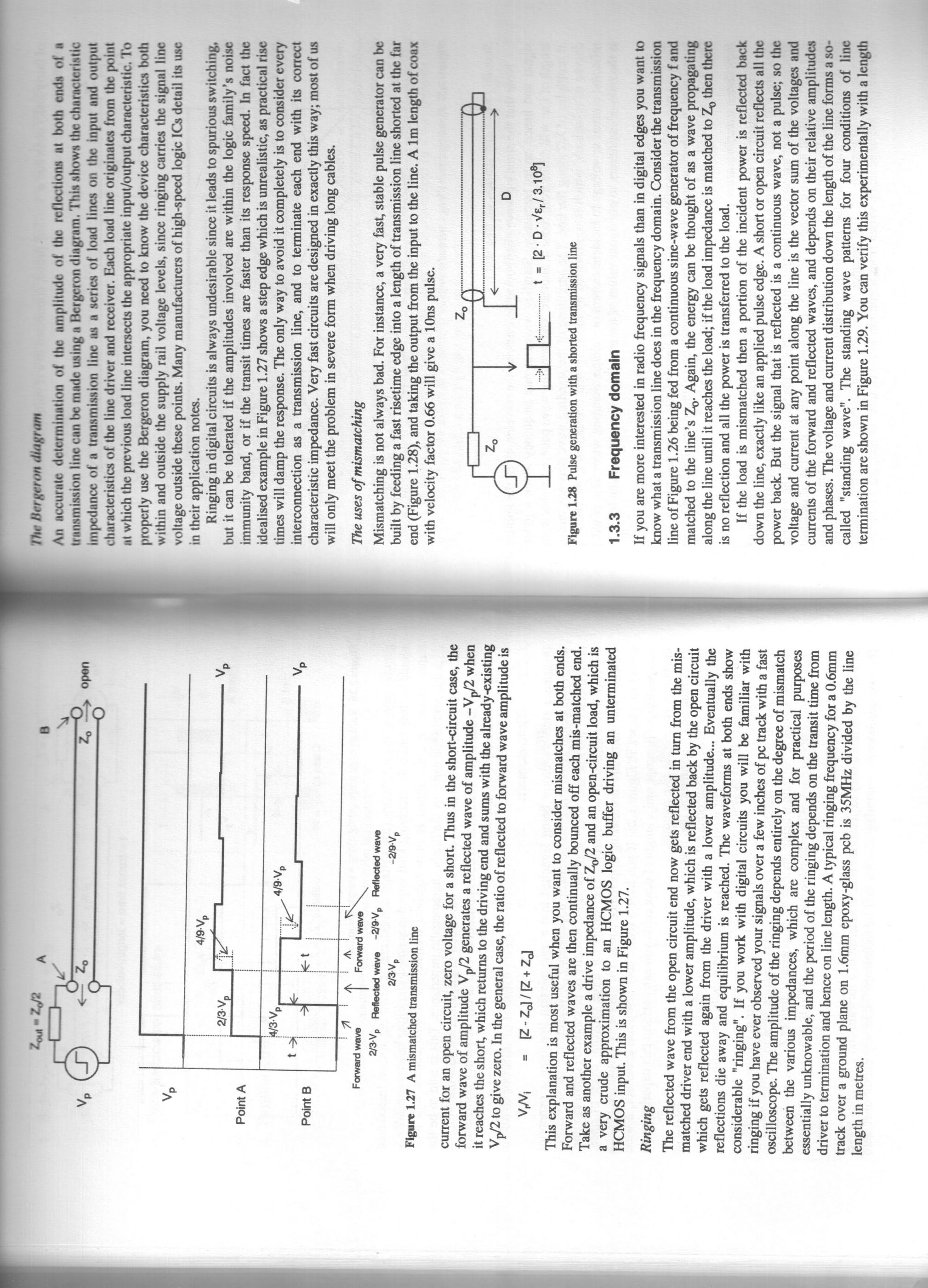

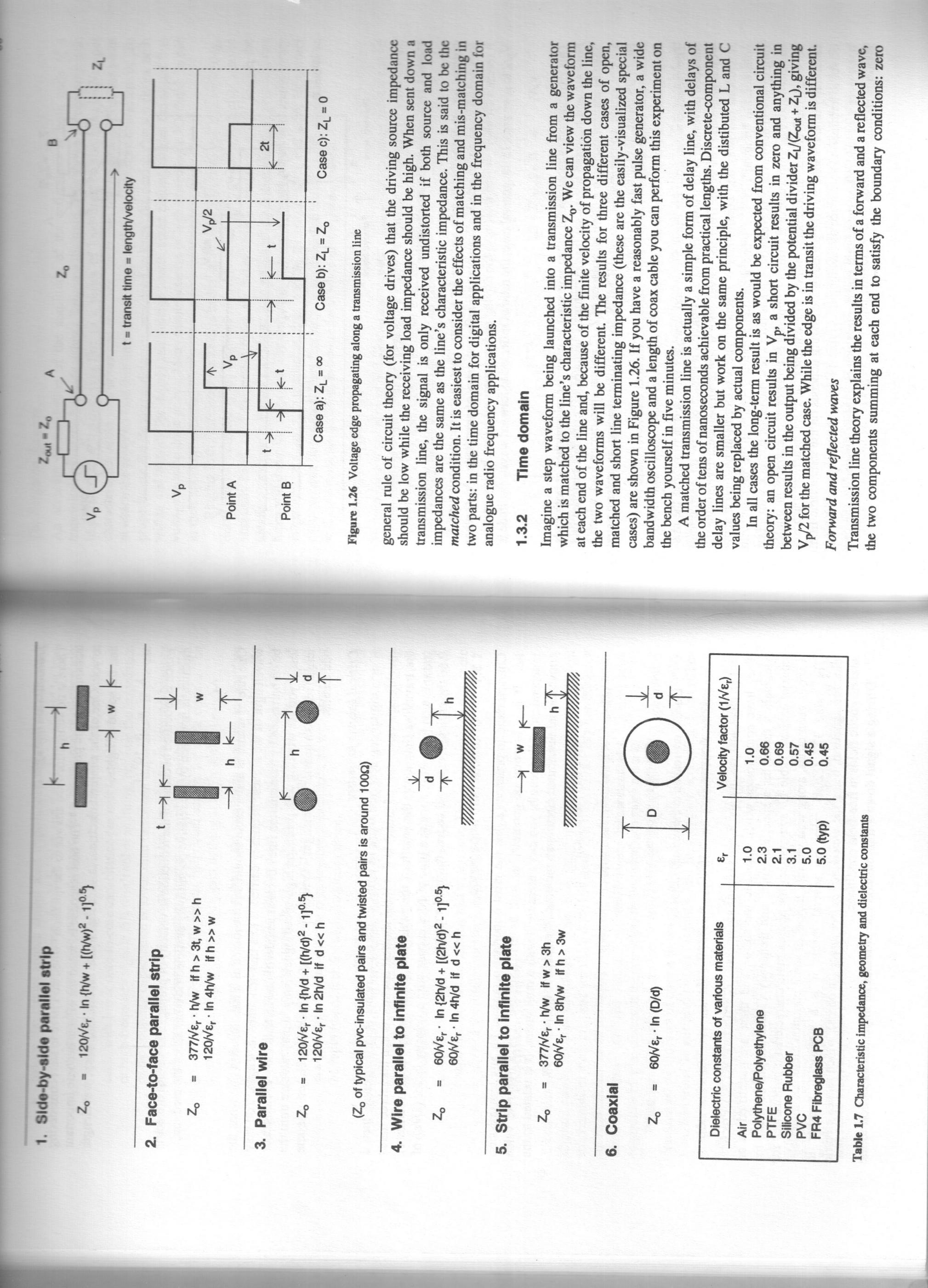

Here is the documentation that we need to understand the characteristic impedance of an RCA connector:
John I can always count on you, the characteristic impedance of 1/4" to 1/2" of connector has virtually nothing to do with anything. It amounts to a fraction of a pF or nH discontinuity depending on if it's above or below 75 Ohms. The same is true if you put a c-clamp on the cable and compressed a 1/2" or so. A new tweek is born, properly spaced Jorgenson Clamps (preferably made of myrtle) on your SPDIF cables.
