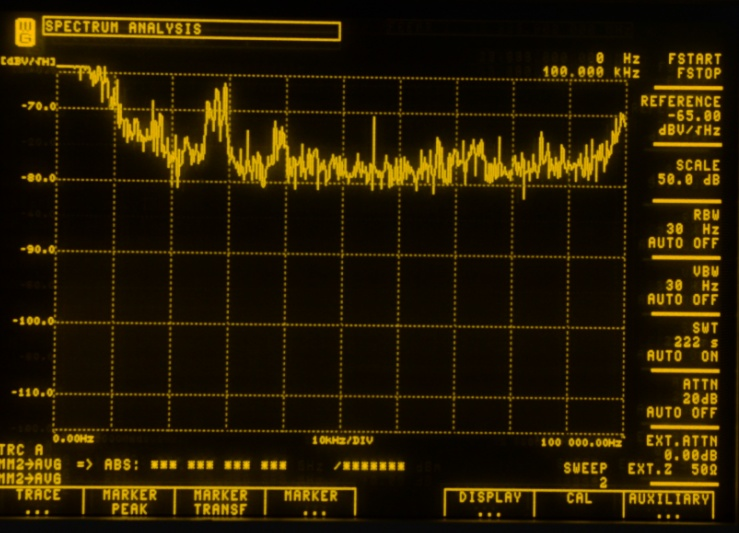

Waly, AFAIK only simulators show Y axis in V/rt(Hz). Instruments use dB, dBu, dBV and you need to take BW and bin width into account, when calculating noise from noise spectral density.
Incorrect. I still have to find a non-toyish spectrum analyzer that doesn't have the option to display V/rtHz or dBV/rtHz on the Y scale. Even free PC tools like Arta have this option, and it's also available for log sweeps (not very common in standalone spectrum analyzers). Of course, you have to know about and look it up, it is not the default setting.
So maybe I was just using wrong settings?
No, you are just not measuring "noise", but a signal spectrum. A small but essential difference.
Yes, but I understand this.
Still you can get the noise level, related to reference level and measurement bandwidth, from spectrum, when measuring output with no input signal. In Arta and similar SW, you get the "RMS" value, which is the RMS voltage noise at the actual setting, say for 48kS/s it is for 24kHz BW unweighted, unless the weighting was chosen. It can be also calculated from "noise floor", e.g. for -140dB "bottom floor" with 0dBFS = 1V, 48kS/s and 65536 samples in the FFT record (0.73Hz bin width), after some trivial calculations we get noise voltage of 19.84uV over 20kHz BW unweighted. This is S/N = 94dB/1V/20kHz or, in other words, 140nV/rtHz. Hope I did not make many mistakes in trivial maths.
This is not a simulation. W&G SNA-33 spectrum analyzer, 1Hz resolution BW from
20Hz to 26 GHz. It has some DSP, but is essentially a purely analog device.
BTW this is the noise of a R&S NGT20 lab power supply, 5V from the rightmost channel.
-100 dB/rtHz is 1nV/rtHz
