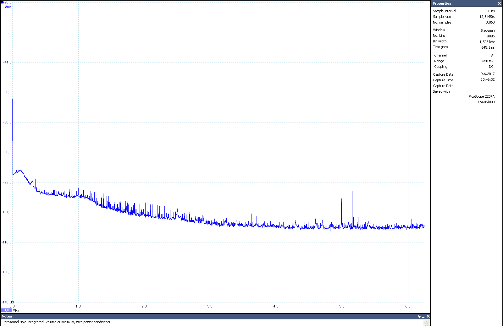

Just to show an example, let's see my measurement at the output of the Parasound Halo Integrated integrated amplifier, which was connected in a system with Denon SACD/CD player, but the volume knob at minimum. The whole chain powered from the power conditioner.
You can see my noise measurement up to 6MHz, Y axis is calibrated, in dBV, FFT conditions shown in a box at the right side.
This is a pretty good result above the audio band, but not so good in the audio band. This was confirmed by Stereophile test in
https://www.stereophile.com/content/parasound-halo-integrated-integrated-amplifier
by Atkinson's measurement of S/N.

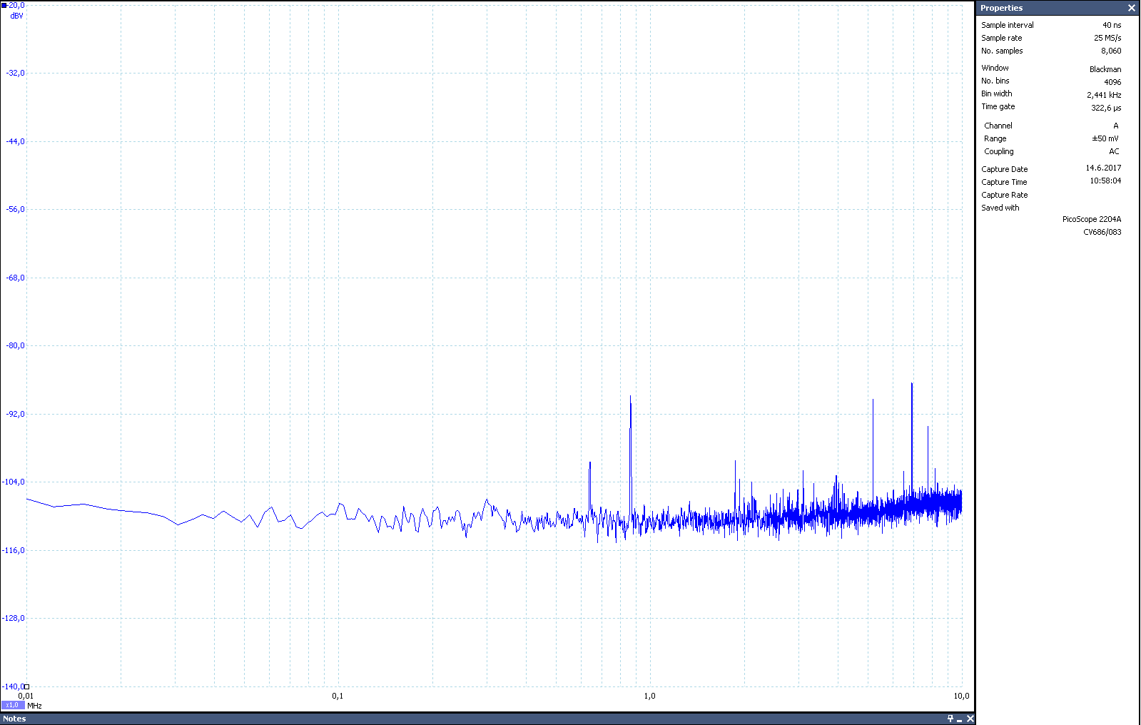

This is what we usually get at the output of an audio preamplifier, which is not connected to anything but a measuring instrument (battery operated) and the preamplifier is supplied from a standard stabilized power supply inside Al metal box. Class II. Quite a lot space for improvements, right?
Pavel, just out of curiosity, are you in the country outside of Prague or closer to downtown? That's a good bit of HF hash.
I am about 5km from downtown.

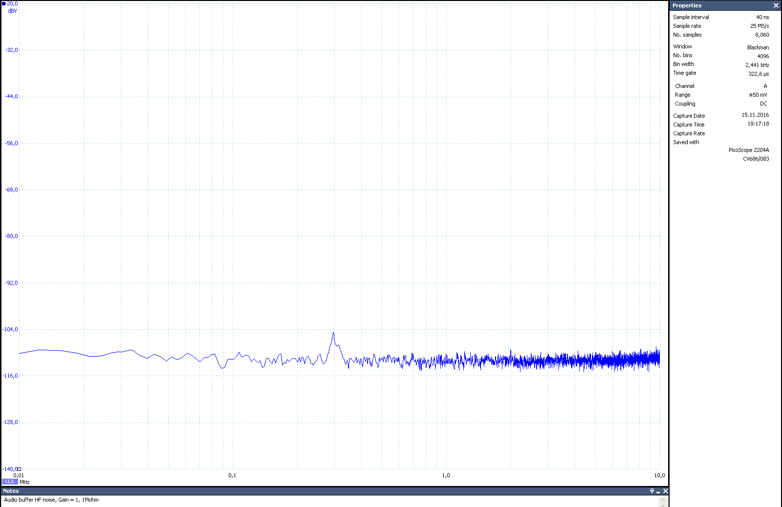

But the EMI sensitivity issue can be solved, as in this measurement shown. Now, the link stage has separate power supply and is built in well-shielded box, input RCA jacks are mount directly to the chassis and shortest cables (few cm) inside the box are used. Still something around 300kHz.
Well, regarding "noise", a qualified person like you can make calculations from bin width, sample frequency and no of samples stated in the graph. Calibration in dBV is good if you want to read amplitude of spikes, here near 5MHz. Or should it be uncalibrated?
That would be pretty hard from a chart, anyway, "spikes" will be shown on a noise spectral density scale as well. And BTW, the spectral noise density doesn't have spikes, those are statistically correlated spectral components.
The problem is, such a representation in dbV vs. F is not a correct metric of the "spikes" amplitude vs. the noise amplitude. Assuming they fall within a bin, "spikes" have a constant amplitude, disregarding the bin size, while the noise amplitude depends on the bin size.
But it does qualitatively illustrate what you mean.
