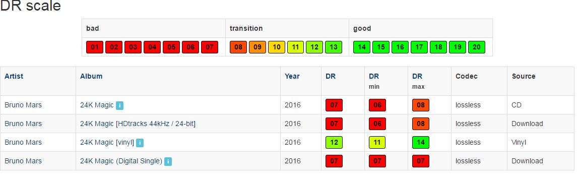

Why is it that for the same recording, we often seem to find significantly higher dynamic range on LP vs CD or hirez downloads, esp in the case of popular music ?
I was browsing through dr.loudness-war.info and saw bruno mars for example because my son asked the question.

This link might answer your question.
Dynamic Comparison of LPs vs CDs - Part 4 - page 2 | Audioholics
Also, As for dynamic compression on CD vs LP ... mass market music is often compressed more and there are different reasons for this. I think LPs are marketed to a different audience ( audiophiles? ) and so more care is taken in mastering the recording to sound good on a high end audio system.
The use of compression by recording engineers really baffles me to be honest. It just sounds like crap and why ruin a beautiful musical track??? They have no ears? The youth today like abrasive, compressed sound? I don't know ... is it really about selling records? Do these trashy recordings really sell better?
I think it is often just about plain ignorance about compressed music

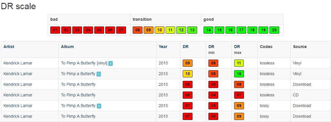

Interesting. So that thread ascribes a mild positive to the effective DR of LP vs CD. But take a look at a few I pulled up from the DR database mentioned above. Note that these were chosen as being representative of the standard pop fare and far far removed from the kind of material that the (typically older) audiophile folks would listen to.
Looks like a great strategy to reinvigorate vinyl for the younger generation using precisely the material that is popular with them. If the readings below are to be believed, any demo would show off the differences like night and day in favour of the vinyl ... so the illuminati lives !
