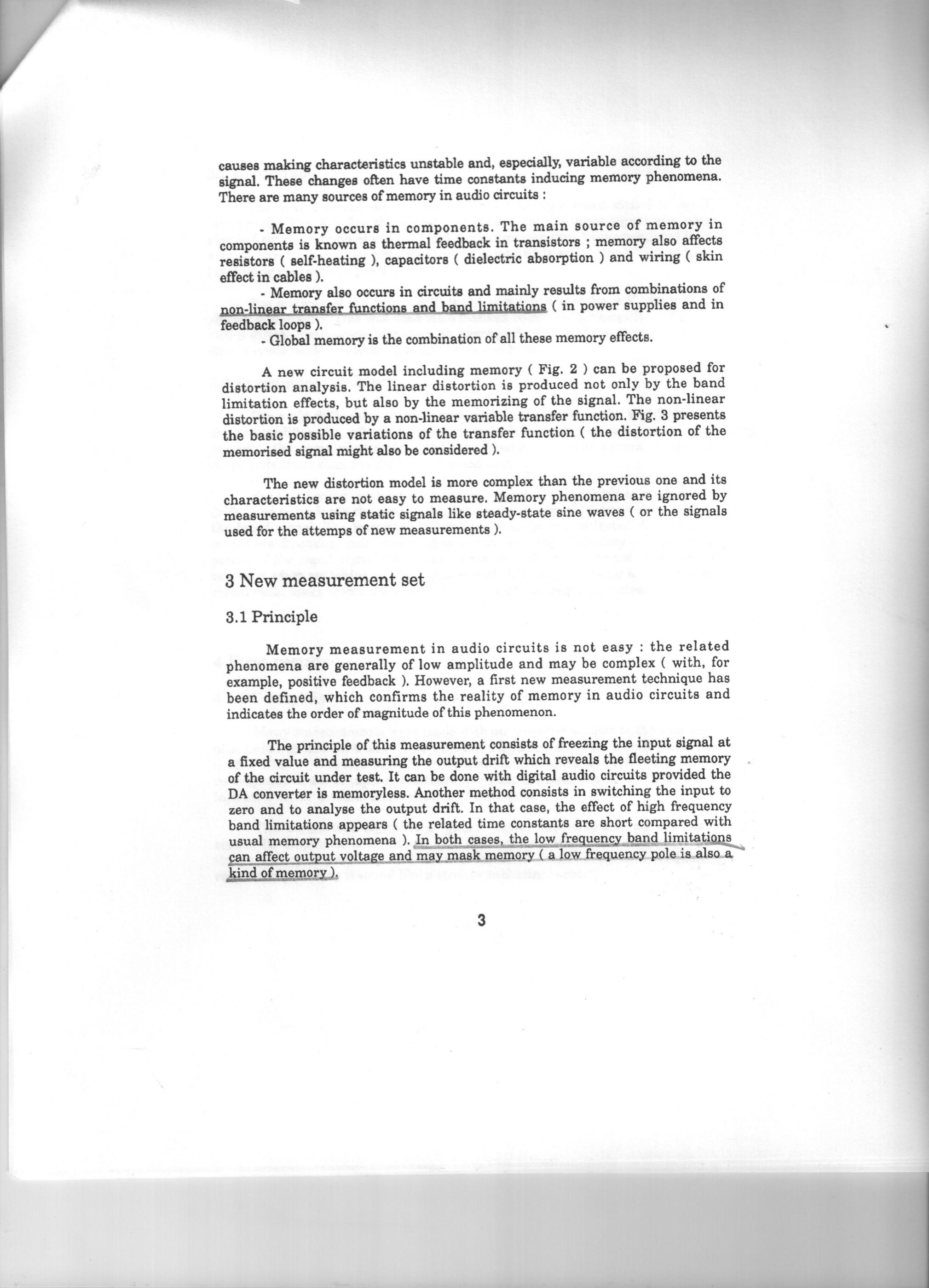

Now that some people have responded to this AES paper 'Measurement of a Neglected Circuit Characteristic' for better or lesser, I would like to point out something that seems to be ignored by just about everybody.
Here is page 3 where I have underlined something that appears to be most important: Low open loop bandwidth might be a contributor to 'memory distortion'. This could be the key to improved listening quality, above and beyond local heating in passive and active components. That is what I want to look for.
