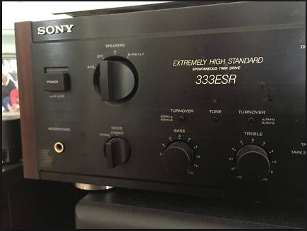

I don't know about the Silmics, but in my humble experience marketeers are generally smarter, sometimes MUCH smarter, than we think.
OTOH I remember a Sony high-end equipment series from maybe 70-ies or 80-ies which sported on their faceplate the motto 'Extremely Standard'.
I always wondered about that; I think I understand what they were trying to plant in our collective minds but for me it came across as 'Very Bog Standard, Nothing Special'.
It was expensive too.
Jan
I think they wised up. I am confident it was Extremely Standard in the beginning, I would not have missed the 'high'. The logo was stylized ES also.

You are right sir. Here is info about 'Extremely Standard' in the description on left side. Vintage Knob.I think they wised up. I am confident it was Extremely Standard in the beginning, I would not have missed the 'high'. The logo was stylized ES also.

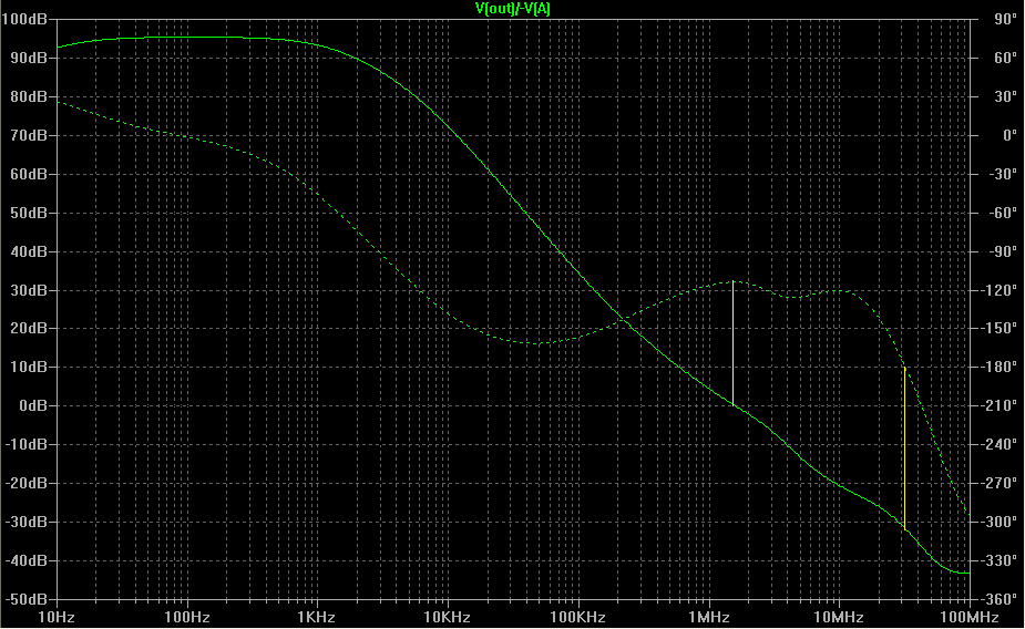

what's shown looks like adequate phase margin at the ulgf
but you don't show high enough f to see the gain margin and the phase seems too flat in the last few octaves without some gain peaking in the next to pull it up
Of course, sorry. This one is extended to 100MHz, but I assume that the real world parts may differ in that area. I will see soon.
Thank you. I was wondering about that. Parts and layout both affect modeling accuracy if only low frequency models are available or used. It would be interesting to see how your measurements turn out.
