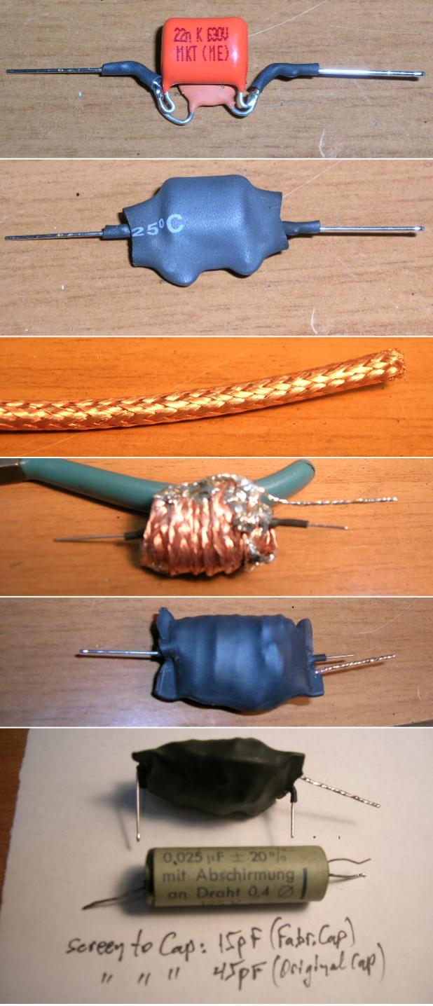

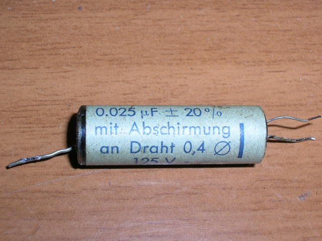

Naaah, I am sure the published capacitor guru is right and the Agilent capacitance meter is wrong.Maybe there is not a full layer of outer foil in all film caps? Maybe some of them look more like the image below from the side?
I was pretty happy to see Richard's technique but less happy to see Mark's so repeated the experiment. Cap was 10uF/100V PE and measured with the copper leads going directly into the terminals of a B&K meter (zero-checked before each measurement). The measurement was repeated with the B&K and also measured once using one of those cheap "measure everything" things on eBay.
Total measured capacitance either meter: 9.7uF
On one end with B&K: 87 and 87 pF
Other end of cap, B&K: 85 and 84 pF
With cheap thing: 85 and 84 pF on opposite ends.

It is pretty clear on a round single section wound capacitor the outside foil should be connected to either the signal common or the higher potential side. On many capacitors the
Lead connected to the outside foil is marked with a band. Some use the lead on the left when reading the label to connect to the outside foil.
HOWEVER there are capacitors made up of multiple sections that are paralled. These can have alternating outside foils and not have an easily differentiated wilt wiring advantage
Of course there are some where there is extra insulation around the outside that would reduce external influences.
Of course we could have stacked foil construction or even shielded capacitors ala aluminum can units. Some of those are actually well sealed, even some specialty film units.

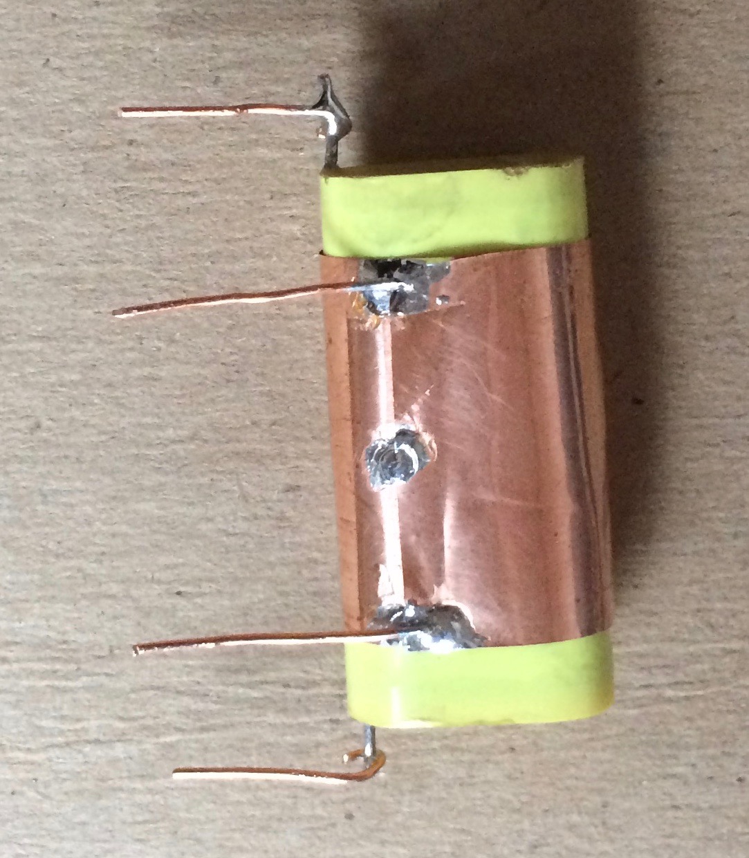

and trimmed the tin foil. Same IAR WONDER-CAP 8.0 uF 200V capacitor.
Hi Mark
If you check using the two hum detection methods shown a few posts back.
http://www.diyaudio.com/forums/loun...ch-preamplifier-part-ii-9180.html#post5045872
and you notice no difference, then these caps are built somehow like Ed says (not prone to hum pick-up)
In a few circuit applications, one could also use copper foil or tin and solder a wire to it and ground it... for a shield.

I have met such three-lead caps in RF circuits of old German radios. In one case, I had to improvise
George
