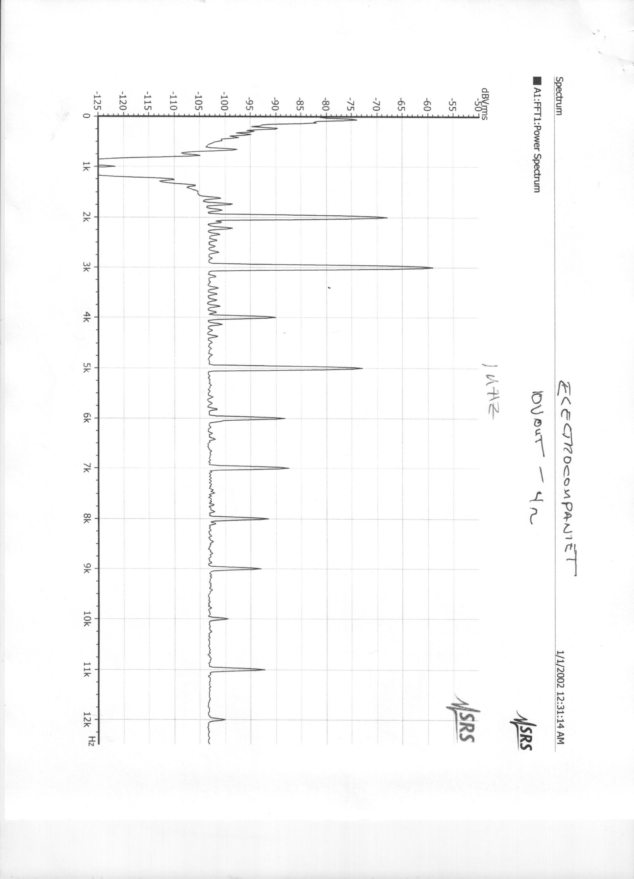

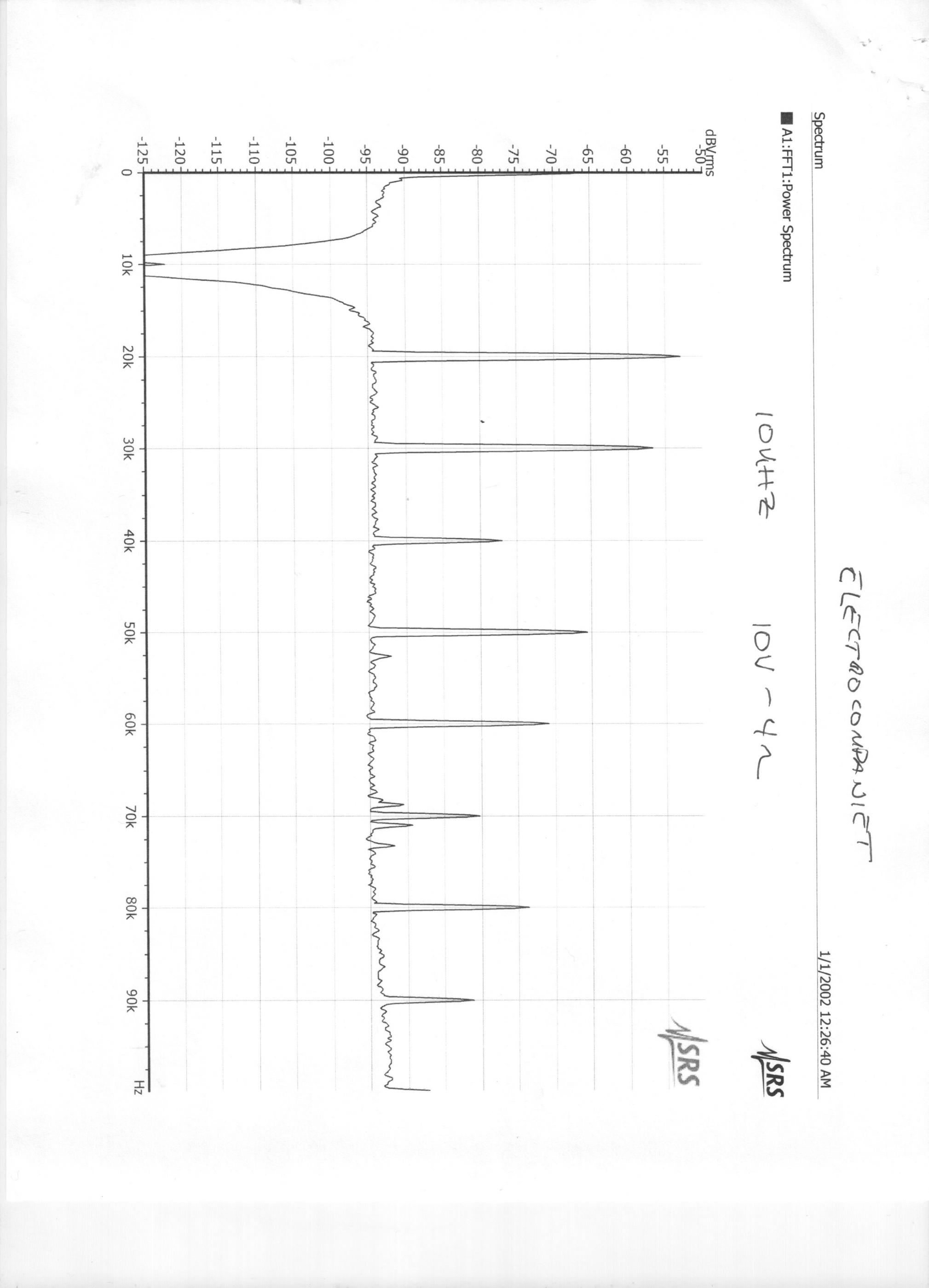

So, is there a point to these graphs other than this is a horrible amplifier and the 10kHz distortion is much higher than the 1kHz distortion?

No Jan, Jan L. did not design the 'heart' of this amp. Without Matti's major modifications, it would have been nothing at all. By the way, I first contacted Jan L. more than 40 years ago. His interview with you was a disappointment to me.
The amp actually measures with a normal thd meter, very well. The output is in dBV, but the test signal is 10Vrms, so each harmonic is 10 times lower. You did not catch that did you?
OK guys, with a conventional HP339 measurement, I get 0.01% at 1KHz, and at 10KHz, 0.025% distortion with 10Vrms out and a 4 ohm load. Not too bad for an amp having only 20dB of feedback. Also, with an 8ohm load and 10Vrms out, I get 0.0055% at 1KHz, and 0.0095% at 10KHz.

OK guys, with a conventional HP339 measurement, I get 0.01% at 1KHz, and at 10KHz, 0.021% distortion with 10Vrms out and a 4 ohm load. Not too bad for an amp having only 20dB of feedback.
No, not bad at all. And I'm sure there's a good amount of local feedback linearizing the intermediate stages, thus flattening the loop gain over bandwidth. Plenty of ways to skin a cat and pay attention to maximizing your performance bang for your loop gain buck.
