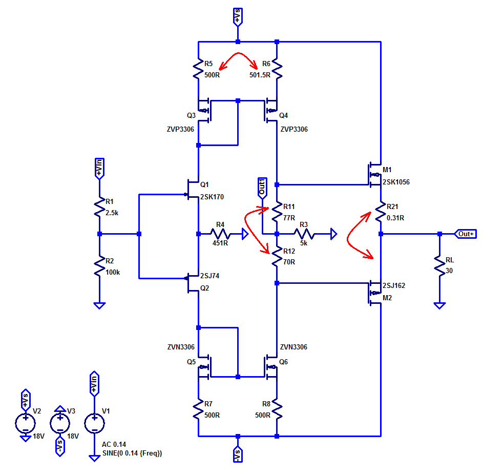

> Constant distortion with frequency implies constant feedback with frequency which is usually caused by deliberately high open loop bandwidth.
> High open loop bandwidth, all else being equal, usually gives lower PIM distortion. So there! '-)
Attached is an example circuit with no global feedback. -3dB bandwidth is at 600kHz.
If we believe in Spice, then distortion at 10kHz is almost 10x that at 1kHz.
For the sake of learning with an example, what can one do to achieve constant THD vs Freq. ?

A few notes :
R5 is not equal to R6 because of need to trim DC offset at R3 (IV resistor).
R11 is not equal to R12 because M1 and M2 have different Vgs at bias.
And R21 is included in order to match transconductances between top and bottom half of the source follower.
One can of course omit R21 and readjust the value of R11, if so wish.
Patrick

On JC and others comments regarding constant feedback vs freq. You can count me in that group since day one. I have said this many times in past and finally some start to Get It.
It is the reason I went to passive RIAA in my published phono design back in the 70's (?). Discrete ckt running on +/- 24vdc.
THx-RNMarsh
Yes, could not agree more.
BUT, does that in itself also guarantee constant THD vs. freq. ?
(Which was the original question.)
Patrick
Constant feedback vs frequency requires constant OL gain vs frequency. This would mean that the distortion reduction factor is constant vs frequrency.
It only guarantees constant distortion vs frequency if it has constant OL distortion vs frequency. Normally this is not the case.
Jan
I just measured the Otala Electrocompaniet and it does a pretty good job of being about the same at 10K as it is at 1K. That is close to the ideal.
How did you measure it? 'Trust your ears' ?
Jan
