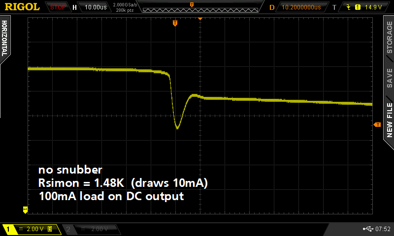

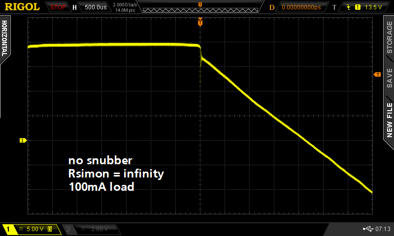

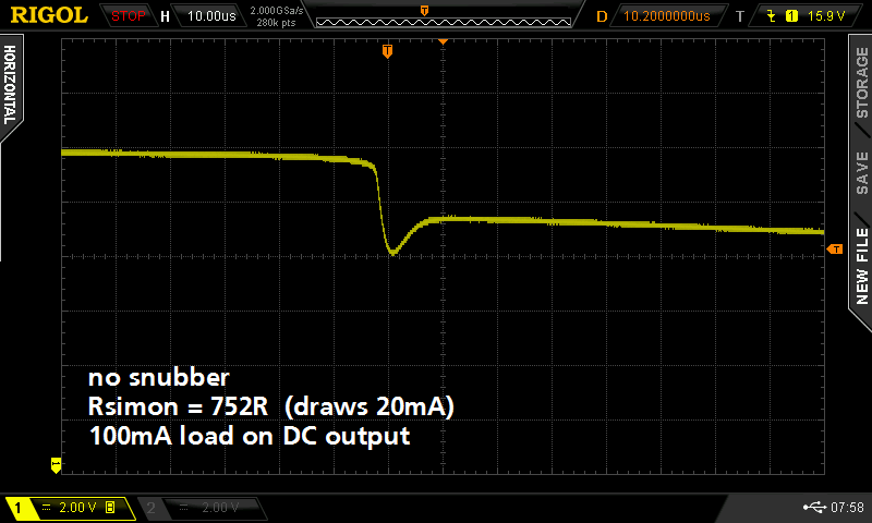

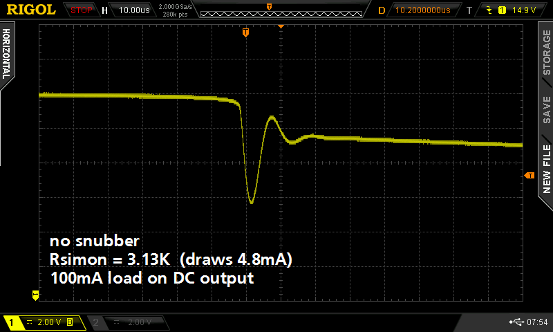

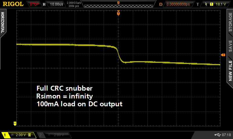

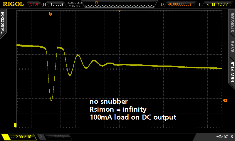

I got enthusiastic about the idea Ed Simon proposed in #91094 so I tried it out this morning. He suggests ripping out the snubber and replacing it with a simple resistor, straight across the secondary, chosen such that the resistor current is 10% of the load current. I reconfigured my test board to do just that; the schematic is shown in image1 below.
I decided to run the tests with 100mA of DC load, using an AC wall wart rated for 500mA AC RMS current. I figured: knock off a factor of two because their ratings are probably optimistic lies, and knock off another factor of 2.5 because my load draws from very well-filtered DC whereas the transformer current rating is AC. Thus I draw 100mA DC from a 500mA AC transformer.
Images 2, 3, and 4 show the voltage across the secondary with "Rsimon" removed from its socket, at increasingly greater horizontal magnification. This is the ringing we hope to eradicate.
Image 5 shows what happens when you install a full CRC snubber, whose component values have been pre-tested on a bellringer jig. Ringing is completely annihilated.
Images 6, 7, 8 show the voltage across the secondary with the CRC snubber ripped out and thrown away, but with Rsimon added across the secondary. As hypothesized in post #90194, this simple stunt did indeed damp out most of the ringing. It's not quite as pristine and smooth as image 5 but it's a damn sight better than what you get when you do nothing at all (image 4). The resistor Rsimon does dissipate significant power: 72mW in image 6, 152mW in image 7, and 300mW in image 8. Whereas the CRC snubber dissipates negligible power.
But one component is certainly smaller and cheaper than three components. It also eliminates any concerns about "which capacitor type will give the best sound in my snubber" since it eliminates both capacitors! If you can tolerate the power dissipation, and if you don't mind the (slight) overshoot in the waveform, then maybe a 1R snubber might be an acceptable replacement for a 1R+2C snubber. Woo hoo.

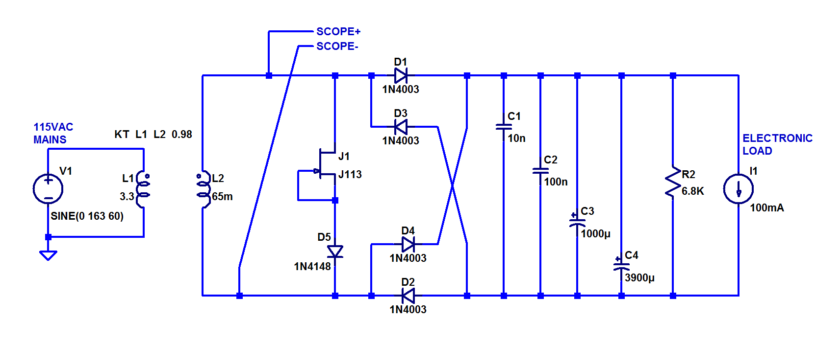

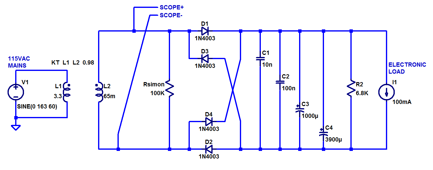

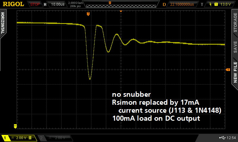

I think the significance of the turn off ringing is voltage dominant is that the transformer secondary is abruptly unloaded.
I don't think so. I think the reason why "Rsimon" reduces ringing is: plain old damping. It's the R in an RLC parallel resonant circuit and the smaller the R the higher the damping.

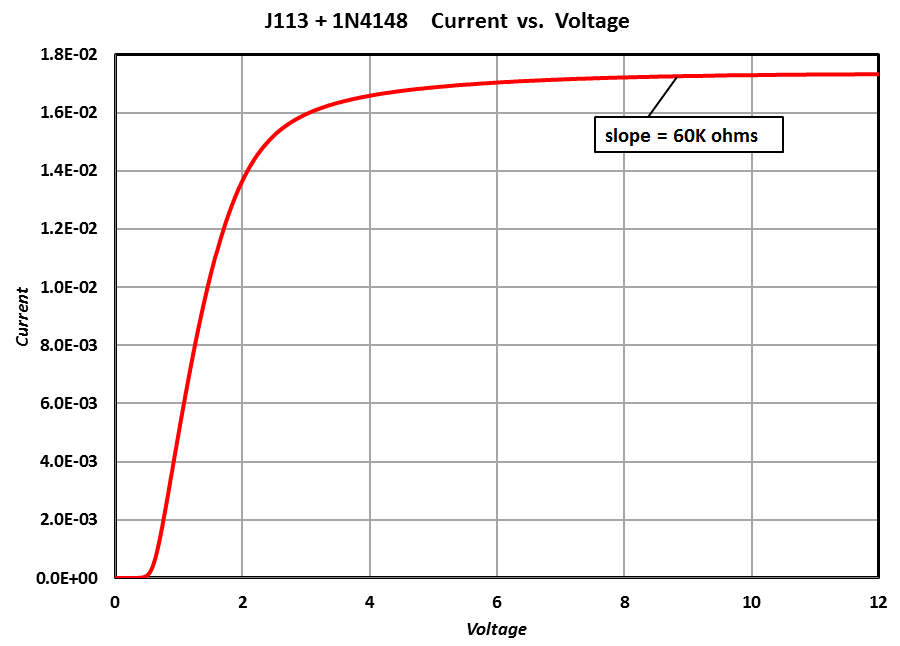

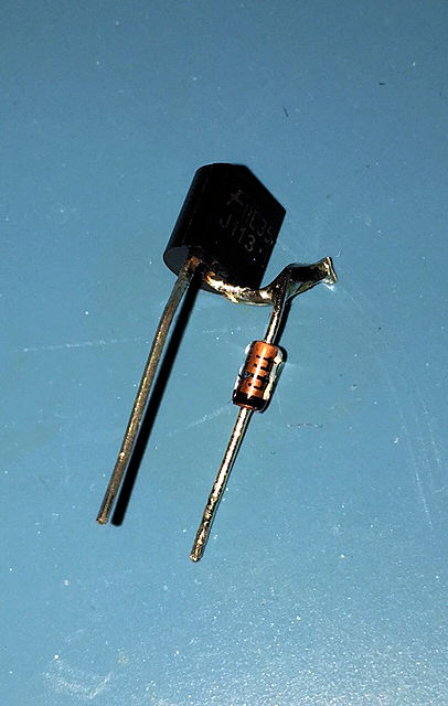

I thought of a way to test this. Let's make sure the transformer secondary is not abruptly unloaded, and let's do this without introducing a parallel R. Instead let's introduce a parallel current source. See schematic in image 1.
I put some J113 JFETs on a curve tracer and selected one whose IDSS was 17 milliamps. Then I soldered a diode in series with it to avoid forward biasing the JFET's gate-to-source junction when the transformer AC signal reverses. Photo of my merde-rig in image 2. When I curve trace this 2-component blob I get the I-V curve in image 3. It's a pretty decent approximation of a current source and the ringing happens when the voltage is 20 volts, see #91102.
What do you know, this not-unloaded transformer secondary rings like a bell! See image 4 below. Even though there is a constant 17mA flowing in the secondary, when the 1N4003 rectifier diodes shut off, their not-soft recovery current pulse whacks the resonant circuit and it rings like a bell.

Mark,
Cool. But a stage further than what I thought I meant. The transformer secondary being only loaded by stray capacitance and powered by energy stored in an inductor will try to go to infinite voltage constrained only by the resonance limit of the capacitor. So I expected the current into a resistor would limit the maximum voltage swing.
Also the other area where I was unclear was I expected the damping resistor to draw 10% of the transformer's AC current rating. Not compared to the load! But then you went above and beyond that. One small trick to the single resistor damping is you can use the pilot light for that! So it becomes essentially free.
