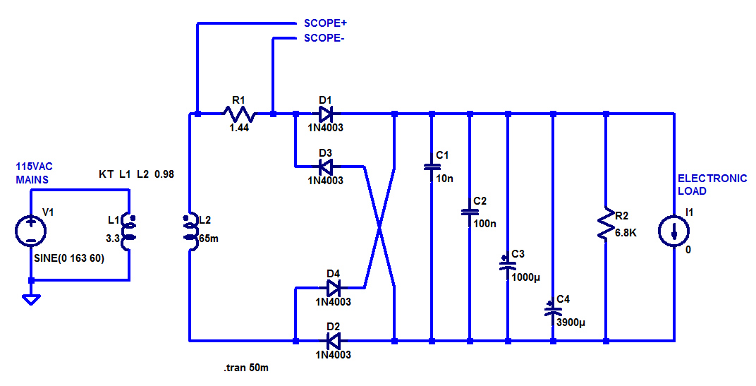

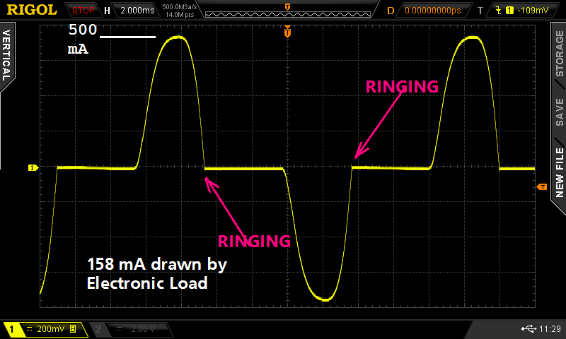

I configured my test board's jumpers to give Full Wave Bridge operation, installed a 1.5 ohm current sensing resistor (measured value on Keithley bench DMM = 1.44 ohms), hooked up the scope, and attached an electronic load to the output. My electronic load is just a current source + enormous fan, that lets you draw whatever load current you want, from a power supply. Schematic of my rig is shown in Figure 1 below. Please recall that the transformer is a 15VAC wall wart from the O2 Headphone Amplifier; it's pretty scrawny.

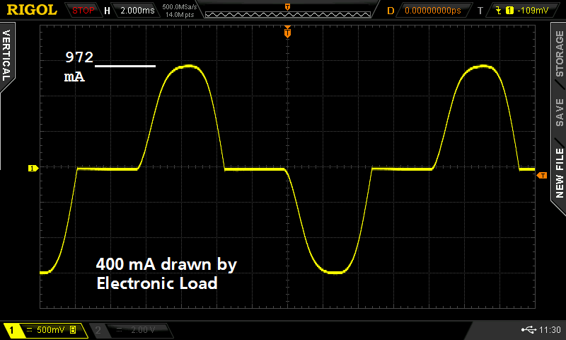

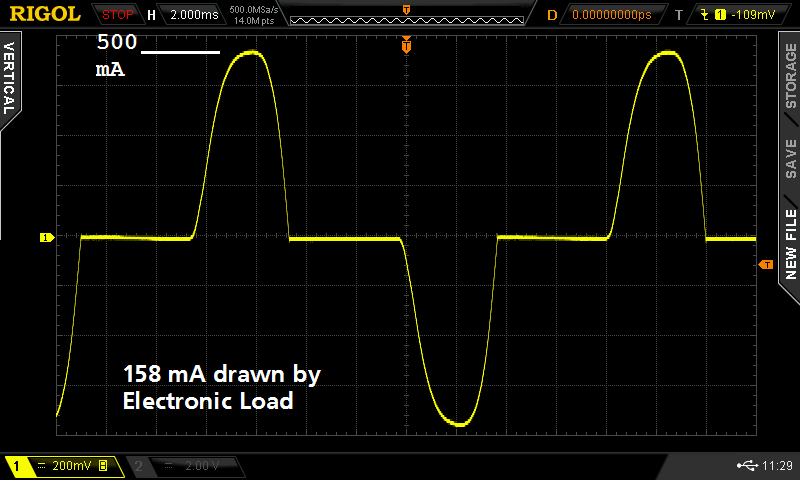

I snapped scope photos of it operating at four different values of load current flowing in "I1". The photos say this:
Code:
External Diode PulseWidth Diode
Load Current as % of Conduction
Current PulseWidth 8.33 msec Angle
0 mA 2.0 ms 24% 43 deg
54 mA 3.2 ms 38% 69 deg
158 mA 4.0 ms 48% 86 deg
400 mA 5.0 ms 60% 108 deg
Ed: looks like the conduction pulse width isn't a fixed and constant 30%.
anatech: looks like the diode conduction angle isn't teeny tiny.
PH104 & Jan: see whether you can spot the oscillatory ringing part of the current waveforms. It's there, I promise; but very small. This is why I prefer to look at L*dI/dt instead.
Added later: notice how beautiful the scope traces are, when driven by a source impedance of 1.44 ohms! Noise doesn't stand a chance of polluting these little beauties. Averaging was not used when snapping these shots.

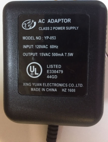

I dunno, Jan. This one's conduction angle increased pretty appreciably when going from zero (really: 2.9mA) to 54mA (really: 56.9mA). It's supposedly a 500 mA (AC RMS) transformer, so I would think pulling 54-57mA of DC current {after HUGE filter capacitors} would not be the least bit challenging. Besides, Ed Simon said "30%" not "30% with the following caveats".
Here's the transformer. At what kinds of load current would you expect it to start misbehaving? BTW the DC resistance of the secondary was about 3.5 to 4 ohms. So the 1.44 ohm current sense resistor did not change things all that much.

I look at your data as a confirmation that conduction runs around 30% in a properly designed power supply. At 400 mA 15 V the wall wart is probably past legitimate long term power rating. Also I aim for 5% ripple maximum 10%. I suspect you were outside normal design parameters. Pretty sure at a high conduction angle you are not getting close to the maximum voltage.
BTY a transformer rated for 1 A RMS AC will not produce 1 A DC! (12 V AC does not give 12 V DC. A few other bits factor in so don't even get the 70% you would expect but closer to 50% depending on things like internal impedance.)
So I don't think we are in disagreement. (About is the key word!)

That size transformer is usually "impedance" protected" as in no fuse. You can short the output and it won't fry. It also means the peak current is effectively limited. Similar for a Sola constant voltage transformer, which operate in saturation.

Ringing is present in the current waveform but it is very small, and scopes often have a hard time displaying it cleanly. So I prefer to view the ringing voltage instead of the ringing current.... it's far far easier to view the ringing *voltage* since the magnitude of the ringing voltage is 10% to 30% of the peak-to-peak secondary voltage. The magnitude of the ringing part of the *current* waveform, is less than 1% of the peak-to-peak secondary current.
Remember this image is from terrible, awful diodes (1N4003s), the absolutely worst axial-lead diodes tested. Also using a transformer with unusually high leakage inductance. Imagine how tiny the ringing current would be, with half decent diodes and a better than average transformer. Note to self: display the ringing voltage, not the current.

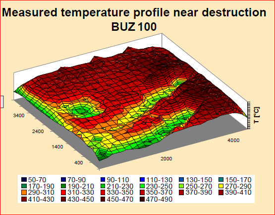

A (very) short digression: we talked a few pages back about current hogging due to temp differences on a MOSFET die. See attached - I thought this was a nice picture which I didn't want you guys to deprive off!
A 10:1 difference in T in degree centigrade across the die!
Courtesy an Infineon paper unearthed by my friend Ian Hegglun.

I think the significance of the turn off ringing is voltage dominant is that the transformer secondary is abruptly unloaded. If you can do the measurement with just a resistor across the secondary drawing 10% power it would be interesting to compare that to a full snubber. Of course the straight resistor approach is only useful on low power stuff.
I also like to put a capacitor across each diode equal to the diode's capacitance. That should halve any stored energy spike. Larger capacitors would offer some improvement of course but could never reach zero. The downside of any diode bypass capacitor is of course the increase in line noise.

Nice, thanks.
The lowest temp is around 230 C, and the highest in the ...near 500's?
Bet the pattern matches the die attach integrity. Did they happen to do an ultrasonic scan of that?
ps..you did mean 2 to 1 difference, no? That's another of those graphs where labels were horribly done. I've never seen a thermal profile that listed temps in the color bar that weren't on the display..

I was looking at the colored squares which seem to indicate a 10:1 variation.
And yes they say the cold regions are the 'bond attach shadows'.
I'll send yo the paper by mail - has a very nice thermal Spice model developed.
