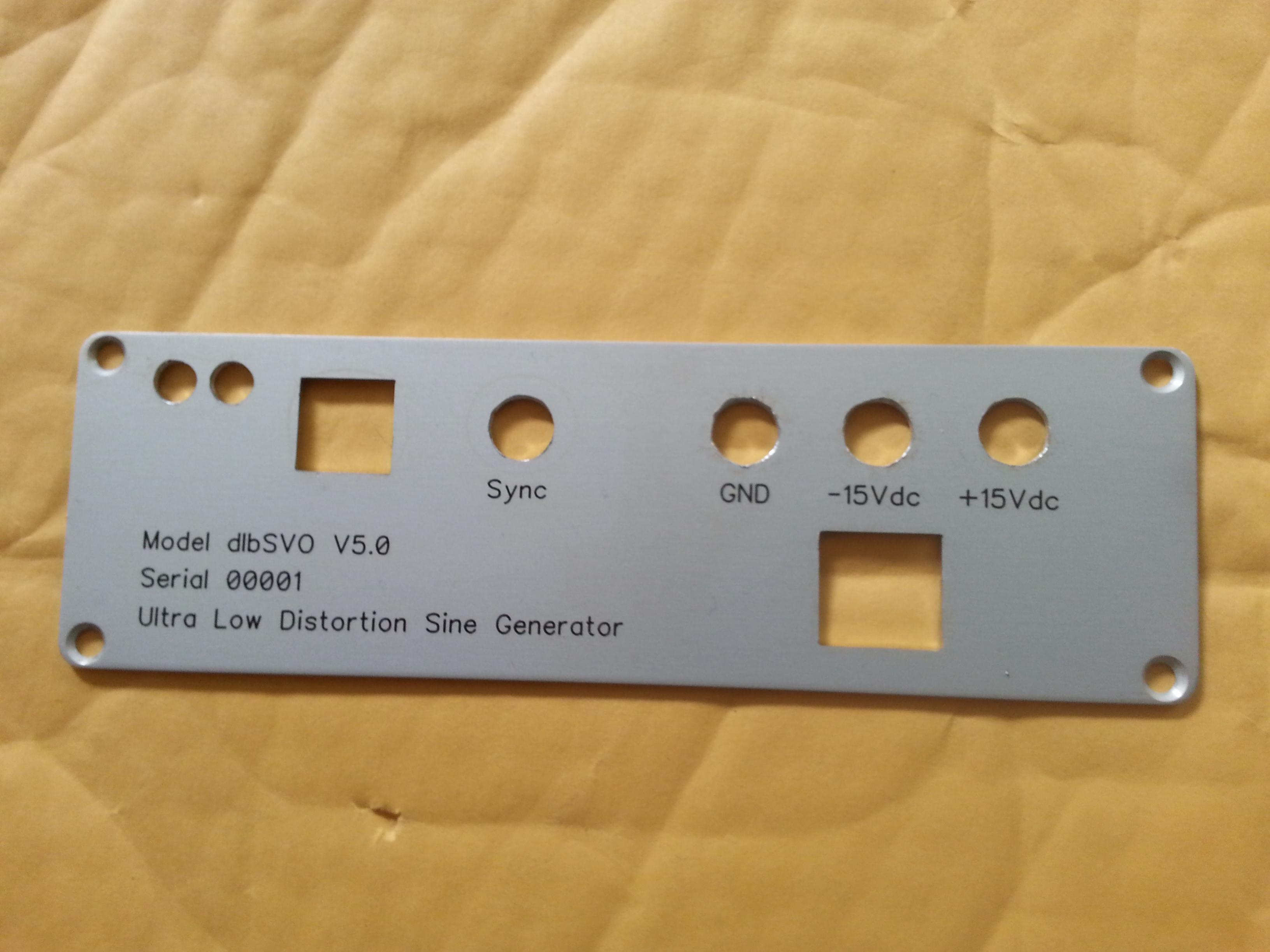

You mean baked on? Never thought of doing this but doesn't sodium hydroxide eat aluminum?
I talking about maybe a 1 molar solution. Safe to handle.
Tex put all there aluminum chassis parts in vats of sodium hydroxide to strip off the oxides before screen printing and or clear coating. For anything that didn't matter the stuff was just hung to dry and left to re-oxidize. This got rid all the finger prints etc.
The NaOH was just an example of a common obtainable chem sold as lye for soap making.
Don't know if it will work.
Here is an example of one panel that sort of worked using isopropyl to remove the film. It didn't get all the film off.
I had to do a clear coat to hid the remaining film. Still looks a bit blemished though.
If I can get a process down that works flawlessly then I'll start a thread explaining how it's done. For everyone.

I'm trying develop DIY process for labeling panels using home made water slide laser printed decals.The decal is backed on the panel. I need to dissolve the film after baking. The film is made from dextrose corn sugar residue.
What common chemical can dissolve this film without attacking the baked on laser toner.
Sodium hydroxide maybe, spa chemical. What?
NaOH would be far away from any choice Id' make. Dextrose should be water soluble (eventually). Is that not a possibility? If you need to accelerate the process, denatured alcohol and/or a small drop of soap would be a first choice. And let them soak for some time. Just do not scrub in the areas of the decals themselves, but you may around them (which would accelerate the breakup of the dextrose and provide weak-points in the dextrose film over the decals in which the water/EtOH might gain access.

Perhaps some acetic acid would do it, not to hard to work with. You could try some simple white vinegar as that is usually just a 2% acetic acid solution. At the same time I would think a dextrose would be water soluble?
It is a water process. The film has been treated to resist water. Once baked it almost water proof. It's quite a bit different from what we used on model air plains and such.
It is developed for this purpose.
I'm sure if I soaked long enough in alcohol or as you suggest vinigar it would eventually come off. But this could take days or weeks vinegar. I'm looking for something that will increase
the rate of dissolution.
I thought perhaps SY might already know being a material scientist or others.
I test a sample with 1 molar NaOH. It does work but 1 molar seems to be to concentrated.
If the heat of reaction is too high the heat will melt the toner. I don't want to remove too much of the aluminum either. 0.2 molar is better but I'm still seeing steam.

I'm reluctant on the NaOH since it has a good chance of undercutting the oxide layer under the toner, and having it flake.
Soap, EtOH, heat are all good, mild things to accelerate the dextrose removal. If you can, simply lightly scratching the surface of the dextrose film will accelerate the dissolution process greatly.
Tried this. It still doesn't get it all off without removing the toner. This is after baking to a peak temp of 400 deg F. As per instructions from the crafty folks.
Well, by the looks of it they're going for electrostatics (Al2O3 surface charge is positive, iirc and toner is definitely negative) and remelting for conformality. Which case the dextrose, also negatively charged is there as a vehicle.
But if the film is dense, then yeah, it's going to be hard to break through that crust.
I'm even reluctant to suggest ultrasonic agitation in the fear that the toner will dislodge.
