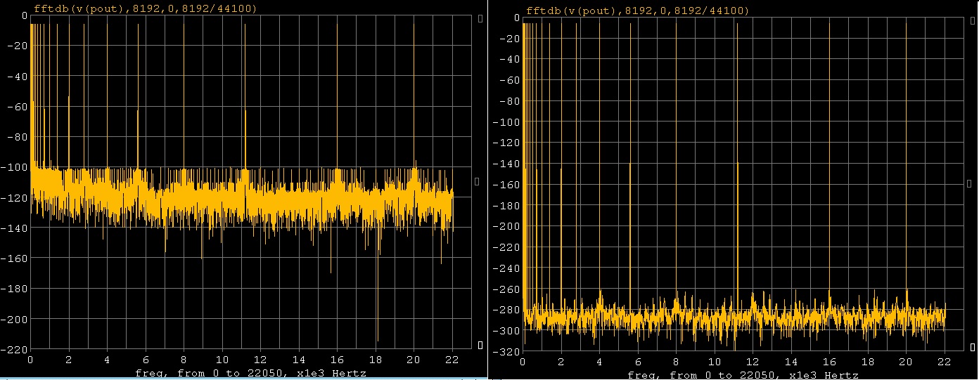

On the multi-tone issue:
I had a few moments to run a purely numerical simulation on one of the AP files that Jan posted. I used the 44100 sampling frequency. The missing information is easily derived from what is given. From any of the numbers you can derive the frequency of bin 1 which gives the length in time of the record so in this case the FFT length is 8192 and the bin frequencies are n*(44100/8192). They used 22 bins here. I used a simple POLY vcvs to add a fixed set of distortion orders. By the 5th order there was only one empty bin left and I have no idea how to interpret the distortion floor in any way but less is better. If you restrict things to 2nd and 3rd order only there are many empty bins.
The second figure is the input (poly = 1*input) and the first is the output (input*a polynomial with all orders up to 5 with small distortion coefficients).
EDIT - I would surmise from this that the concept of harmonic progression is somewhat lost here.
Scott I am pretty sure there's more to it than the file I posted. I remember that the algorithm also fiddled the relative levels, phase shifts and crest factor. I wish I could find the stuff!

That shouldn't matter the numbers given mentioned that the crest factor and equal levels given were the intended ones. Yes you can rotate the phases to minimize and maximize the crest factor over a certain range. The minimum crest factor is a neat math problem the max is obvious.
