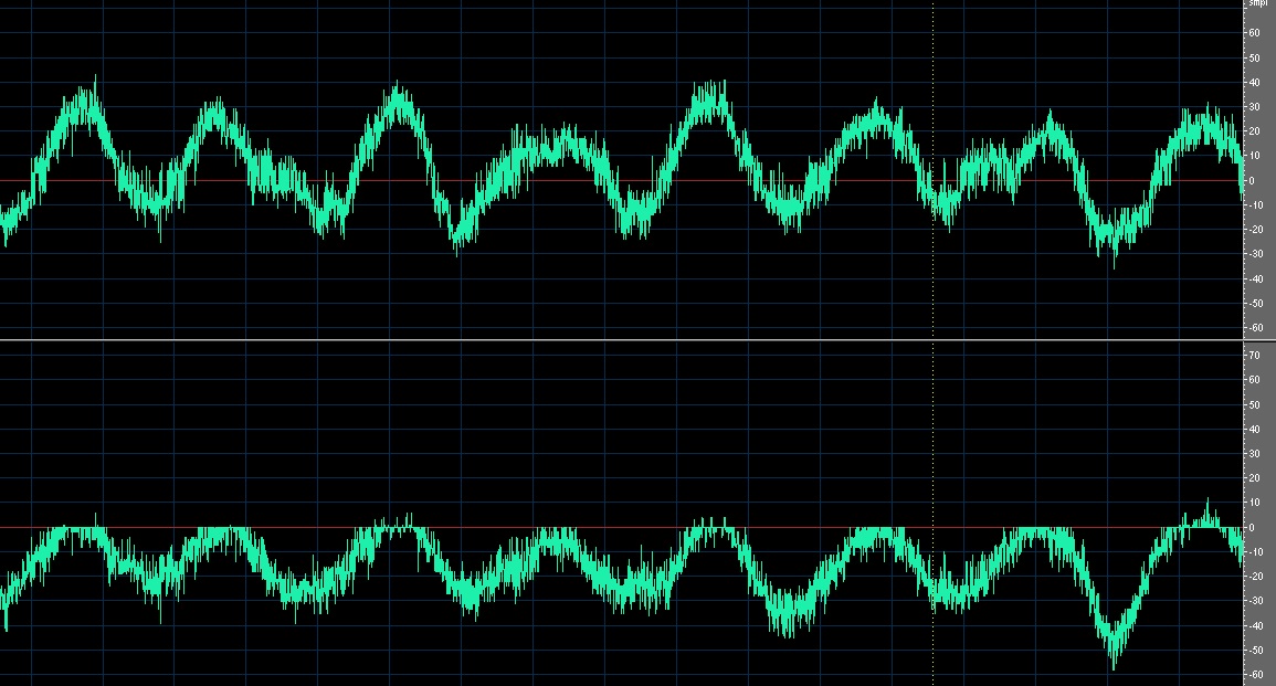

The difference is abundantly clear on my system, and presents as a nasty mask of noise, to the point of sounding distorted compared to direct playlist playback.
Dan.
Something like that should be easily verified using any of a number of standard tests. Are you able to do the necessary electronic tests? Its difficult to to a loopback test on a PC of separate software on the PC so at least another PC or external instrumentation is needed. From your description it should not need exotic stuff to find.
Its possible the ABX plug-in on your system is corrupt for some reason. However testing to confirm first would be really interesting.
If time permits I'll clutter a system with Foobar and the plug-in in a few days.
I am astounded that there should be any such a difference.I, SY, Jan and other have used it. "The difference between when a track is played in the player or the ABX utility is astounding.", we don't agree. I mentioned it before making all these differences "astounding" and nothing subtle does not enhance the chance that anyone will listen.
To make things clearer, I am playing back some very old Tango music...scratchy sounding violin etc.... a good test.
I found this by accident...hey I expected the playbacks to be identical...in this case, I find that the ABX plugin does change the sound compared to the original.

The sound difference I hear is reduction in extension of both lows and highs, with a bit of dirt in the mids...symptoms of noise.
You will have to listen closely for the changes, amongst which is a change for the worse in the flow and 'vibe' and clarity of the music.
The 'dirtier' the source track the better.
