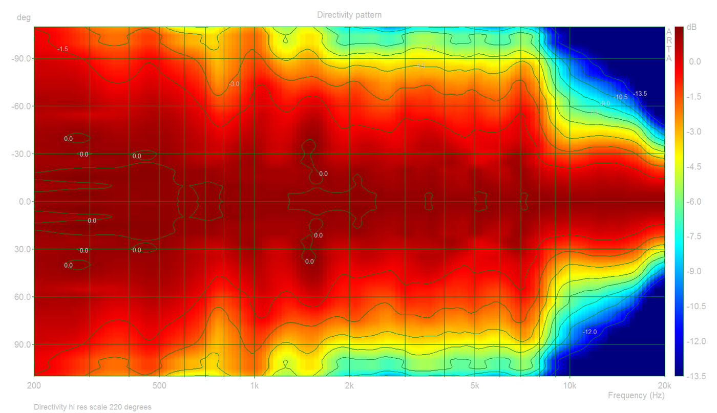

Following up on Bears question as to how to measure imaging: picture time!
As I mentioned before, the closer a transducer approaches the characteristics of a point source, the better it is for imaging.
This can be measured. A point source will radiate equally in all directions, so by measuring the directivity pattern, important information can be gathered about how well the transducer approaches a point source, and hence the quality of the imaging. The wider the spread and the more even the directivity pattern is, the better imaging will be.
The polar plot of the M2 that was shown earlier in this thread is the result of Toole's and Olive's work in this field. I have been developing from the same premise, but with an important difference. The narrow pattern produced by wave guide based speakers like the Geddes or M2 is sub-optimal in my view.
The speaker I will put on the market shortly departs from the wave guide based approach to directivity control. The result is a much wider listening window, as is born out by this plot from +110 to -110 degrees with a fine (1.5dB) scale:
Over a 180 degree listening angle, there only is about 3dB fall off, except for the highs. What you see on the high end is the physical limitation that even a small diameter tweeter has. There still is a listening angle of 90 degrees for the highs within 3dB, but at my age, the speakers sound almost the same straight on as sideways.
Later this month they will go to anechoic room for a second time to do fine tuning and make further measurements.
The effect this directivity pattern has on stereo imaging is very remarkable. Those going to the Triode Festival this November may get a taste.
One other effect of this directivity pattern is that room dependency appears to be less, rather than more as some may presume.
My working hypothesis to explain this observation is that the Haas effect needs higher frequencies to function optimally. Traditional directivity control collapses below some frequency, so what you get below that frequency are reflections that not corrected by the Haas effect, and are thus perceived as separate sound sources, muddying things up.

Have you read Sound Reproduction and its material on the Haas effect (now more often called the precedence effect)?

Brad, would be mighty obliged if you could point me to where to find this. My sources are Moore, Blauert and Pickles, amongst others.
There is a much-modified third (really second in terms of content) edition in the works, but the first ed. is ISBN 978-0-240-52009-4, from 2008.
The discussion of Haas/precedence is mainly in Chapter 6, Reflections, Images, and the Precedence Effect, pp. 73-93.
Bookfinder shows used copies for under 28 USD.

I'm quite interested in your speaker approach...
...but having said that, having a better speaker which is a great idea, doesn't explain why or IF changing an amp or a DAC ought to alter the perceived soundfield in a given system. Assuming for the moment that we are not talking about bias/prejudice and other self-induced perceptions. I'm saying that the result is altered.
Never heard of anyone being able to measure that, but if they have, great!
If it's never happened to anyone reading, ok fine.
Happens all the time afaik for most people. EVEN when you WOULD PREFER, and rather not hear any change/difference.
Even if it doesn't work as you think it will you have a story that the reviewers will lap up :)
-Existing effect that the readers may not have heard of
- Belief that you have found something others have missed
-Product delivered using your finding.
The perfect High End story. You should win awards with that.
