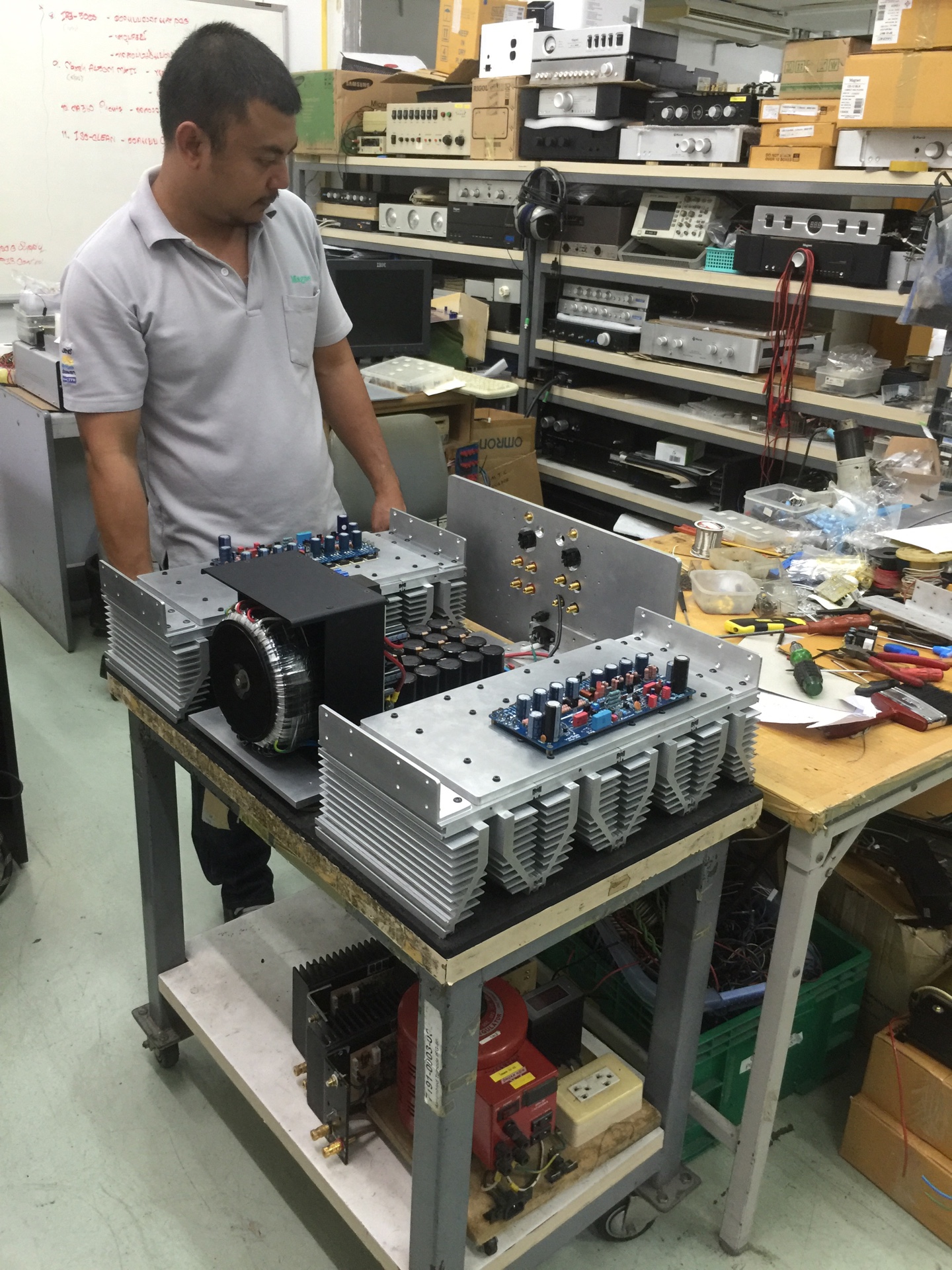

The JBL M2 has left the shipping dock -- I need two of these 2-channel amps.... making progress:
My tech support is via Magnet Techology, Bangkok, Thailand.

Still there is no the drivers heat sink mounted, how thy are going to instal it if the board and the output mosfet are already fixed to the main heat sink??

Lol, relax Dadod your child will be fine.....what you see is the trial fit stage.Still there is no the drivers heat sink mounted, how thy are going to instal it if the board and the output mosfet are already fixed to the main heat sink??
It's going to look impressively industrial, and I would be proud to fit a perspex top cover, especially nice work.
What's the estimated output power, idle power and total power consumption of this monster ?.

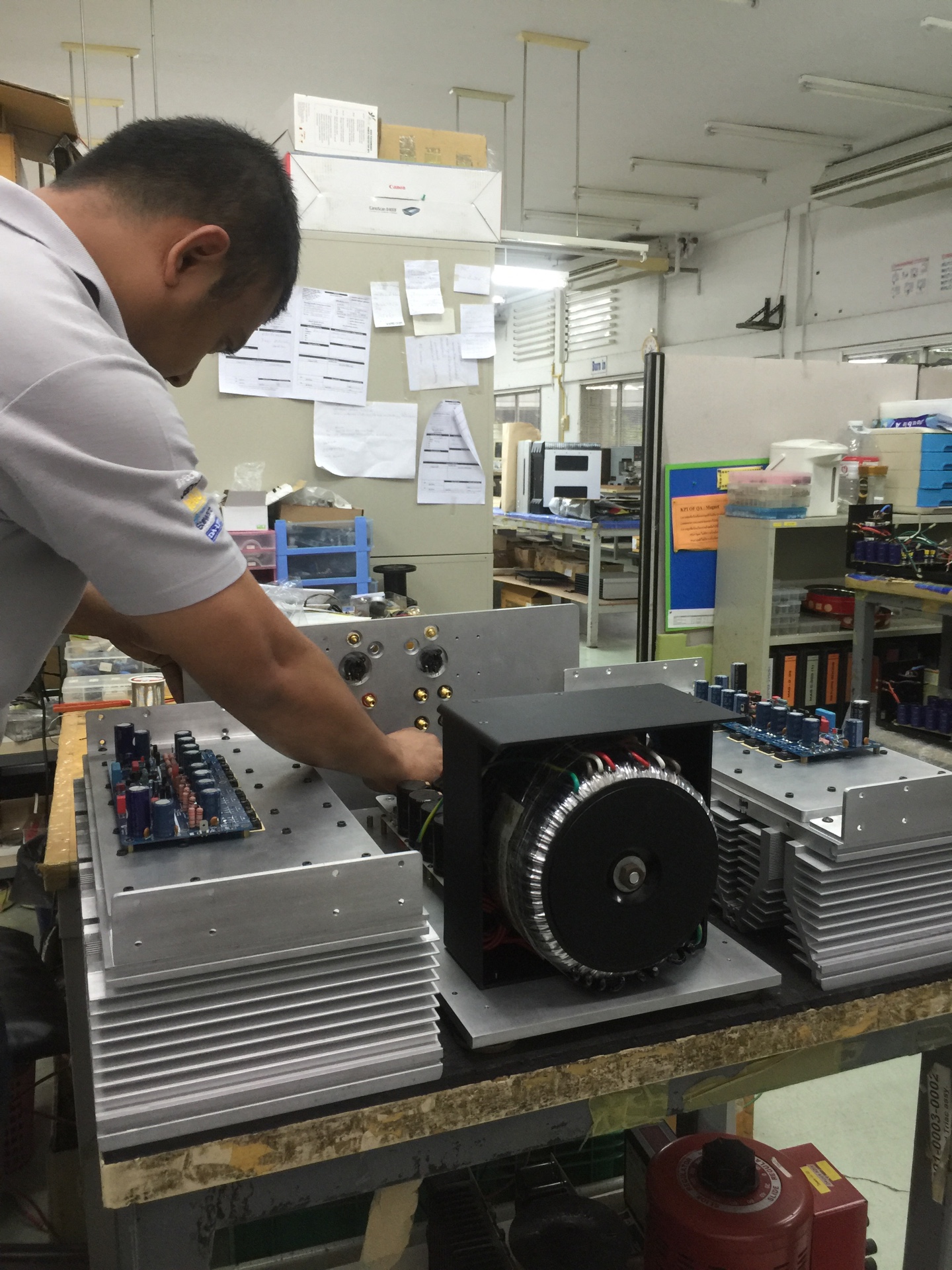

Wow, a PCB layout revision, with the output coil still on the PCB .

Otherwise, a true DIY work .

I think Richard measured the amp as is and found it was a great performer. As long as you orient the coils correctly, the magnetic induction issues are quite manageable.
I'm talking about a finished amp, not about a testbench spread. Results could be dramatically different.
Not as long it's on the PCB. Take a look on how the Halcro DM88 installs the output inductor; it's placed in a separate compartment of the massive metal enclosure. Care to guess why?
There is direct output before the coil on that PCB, so it's simple not to install the coil on the PCB, but somewere close to the spekare output connectors.
