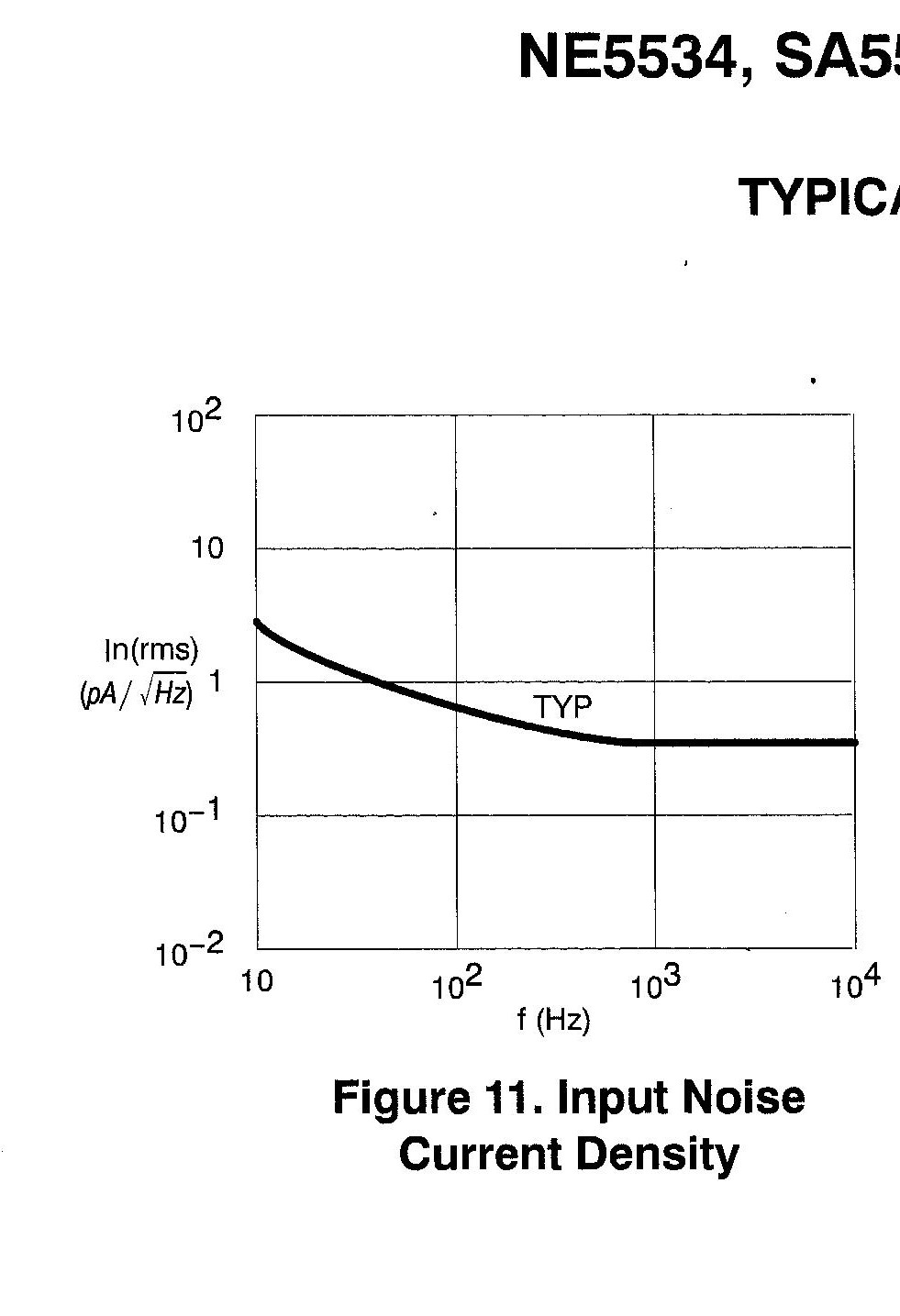

Do you? Then the comment below is invalid due to the 5534 input current noise 3-4.5pA/rtHz @ 30Hz, rendering about 4nV/rtHz for a modest 1kohm impedance @1KHz MM, therefore doubling the 5534 input voltage noise, to a total of about 6-7nV/rtHz. You would be much better even with a good jfet input opamp.
I'm just sayin' that the best bang for the buck MM phono is with a 5534 Mark.

At least according to the On Semi datasheet.
Yeah, different specs from different manufacturers. Anyway, a typical MM has 500mH inductance, which is ~3kohm @ 1KHz, and that's on top of the DC resistance. I would still not use a 5534 with such a cartridge, although if your noise performance reference is the needle on the vinyl noise, then you may get along with much worse than a 5534.
