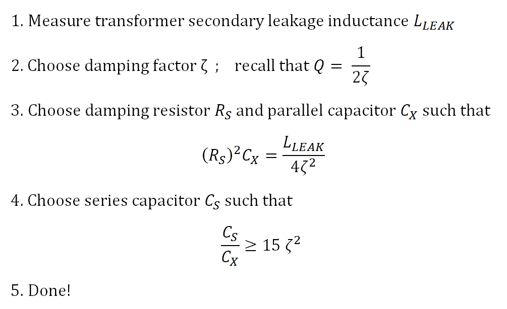

what was the snubber values placed across transformer [in the Linear Audio article]?
Richard, as others have remarked, I followed the Quasimodo snubber design procedure as described in threads here on diyAudio. The procedure is:
In step #2 I selected a damping factor zeta=1.5, as discussed on p.103 in the magazine, just above Figure 6. Since zeta>1, the second order linear system is slightly over-damped. The remainder of the design procedure is simple plug and chug arithmetic on a calculator with scientific notation.
