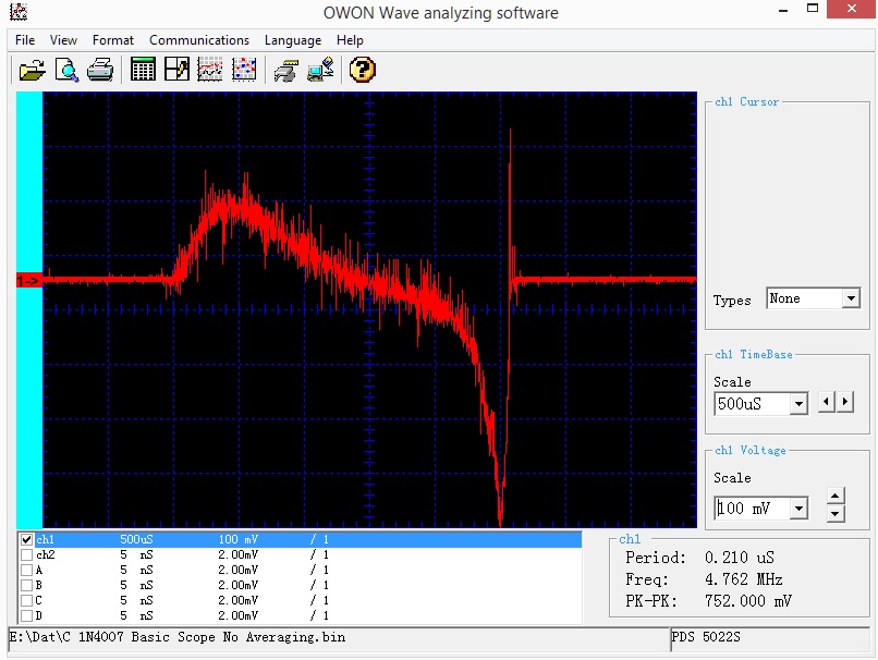

How does a rectifier have a "sound"? Any sort of data to show it's recovery/etc?

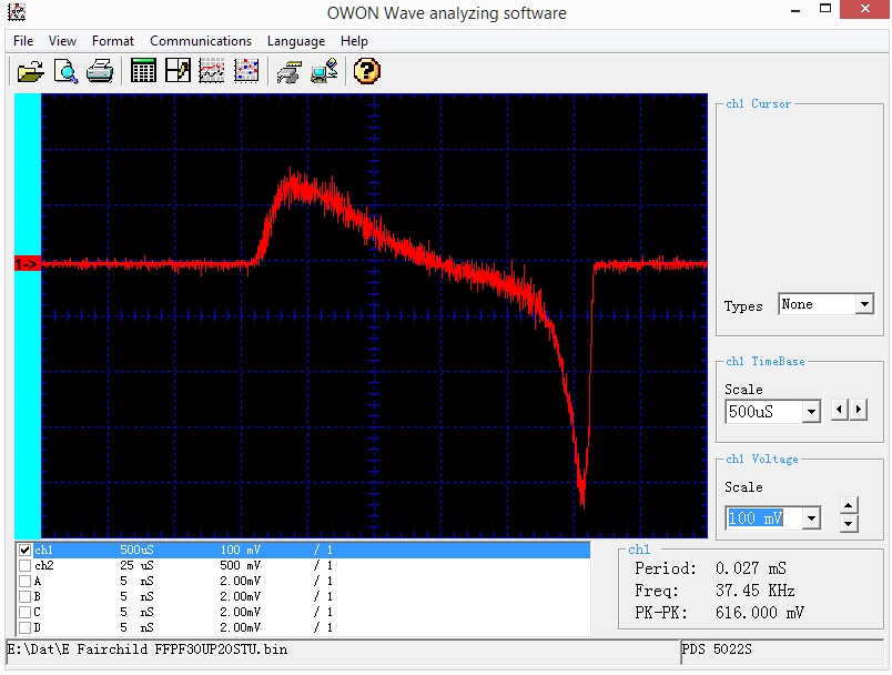

This is a rectifier that will have a "sound." And one that won't.
