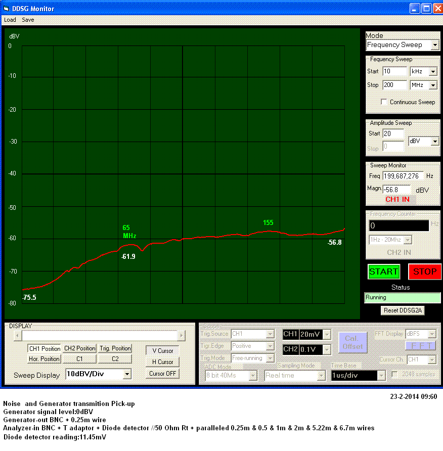

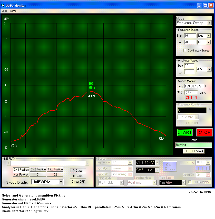

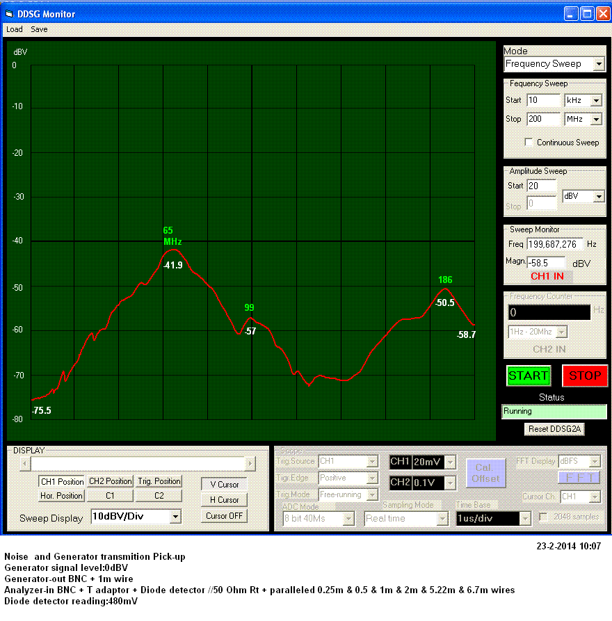

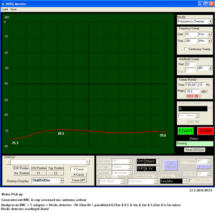

In my workshop, a 10kHz to 200MHz sweep generator (Ro: 50 Ohm) drives a single wire antenna of a varying length with a 1Vrms signal.
At a small fixed distance there are six single wires (0.25m, 0.5m, 1m, 2m, 5.22m, 6.7m) connected in parallel at the input of an analyser which is synchronised to the sweep generator. It’s 1MOhm/20pF input is 50 Ohm terminated. A 50 Ohm broadband diode detector is connected in parallel to it.
The variable in the attached screenshots is the length of the transmitting antenna.
Green numbers show frequency (MHz), white numbers show amplitude (dBV)
Horiz axis is linear 20MHz/div.
First screenshot is the ambient RF noise in my workshop at the basement level.
This noise varies with time and day. It can reach –55dBV on a noisy day.
One floor up and the RF noise goes up by 6 to 9 dB.
I am 5km away (line of sight) from a location with many TV and FM transmitting station antennas and 4km from an air force surveillance radar.
George

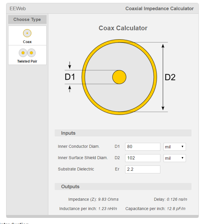

The effect of the shield! Try the coax calculator.
Couldn't find a calculator for shielded twisted pair if that's what you mean.
