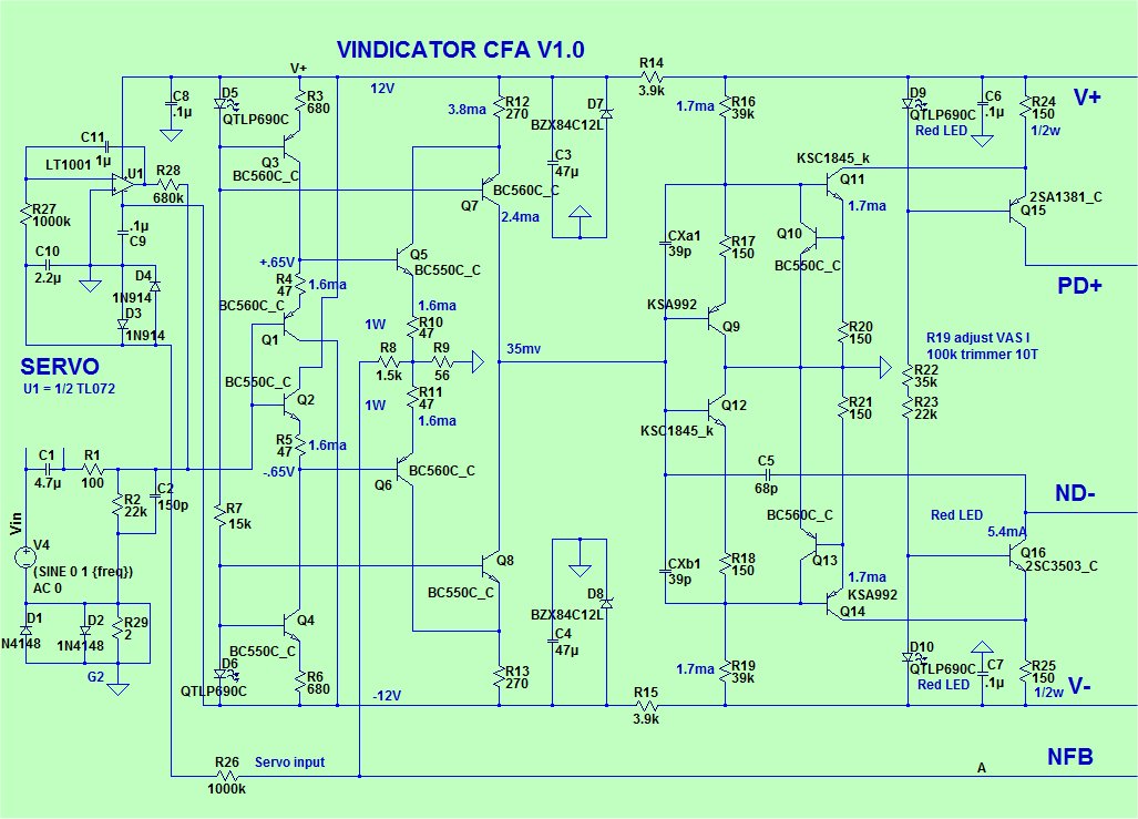

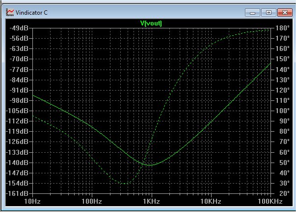

No folded cascode. Too exotic .
I have two building this now. It is folded cascode all the way.
I used Sam Groner's Final TIS for the right hand (folded) stage. I was surprised
to see that -140db 1K PSRR at output. No other design even comes close.
THD and slew are secondary to how an amp rejects it's dirty PS !!

ostripper,
Glad you piped in, it was your conversation with others that I was pointing to without naming names. :)
Me and Vzaichenko are the new wave.
Some of these (old) new adaptations will define the forum.
Doug self "blamelesses" are sooooo boring.
That last "groner" IPS will do 6ppm right up to 130V p-p.
Symmetrical "rules". (I am NOT in the self camp). :D

What characteristic behaviour of a PS most affects the amplifier and how?
