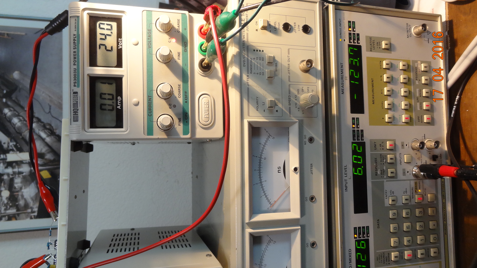

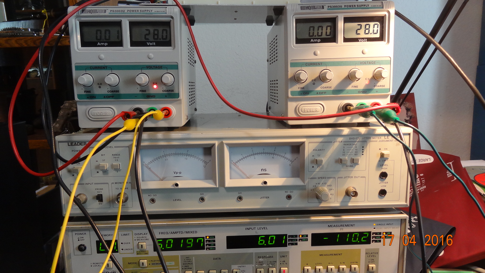

A two opamp direct coupled composite amp (with loading) using 2ea
LM7171's. 2v rms
5KHz THD, dc offset, etc didnt change from +/-15 to +/-24vdc.
The thd starts to rise slightly at +/- 28vdc...... from -123 to -110db.
... more later...
