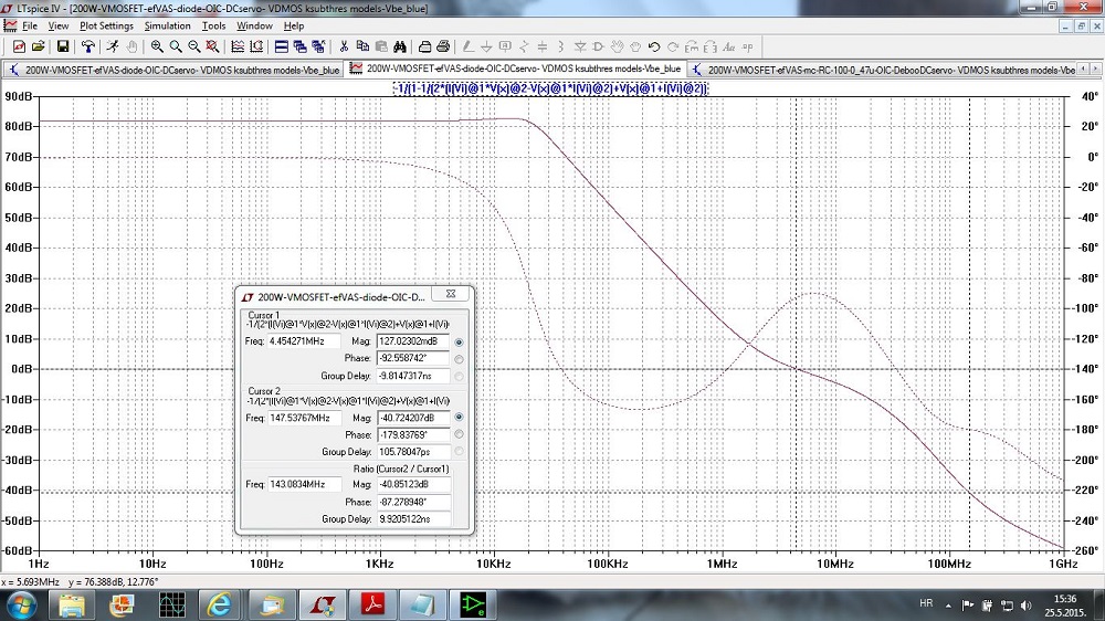

I've found in my search for better amp that it's easier, in CFA, to move ULGF up in frequency and still keep very good phase and gain margin.
Gain plot looks good! Better than mine at the moment.
Thank you John.

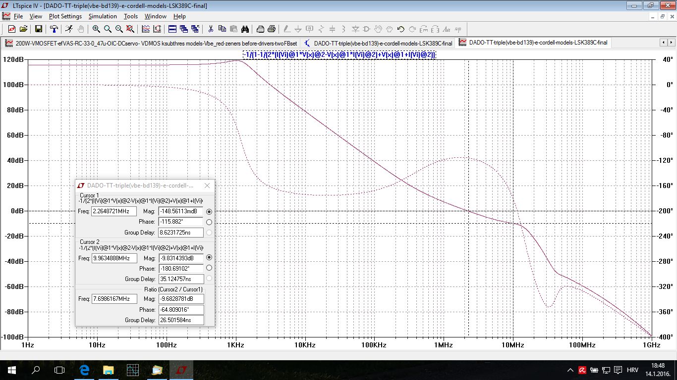

What can I add to your results, proving once again you are not even remotely understanding feedback, since you are using "Open loop X", where X=gain, phase, bandwidth instead of the "Loop Y" where Y=gain, phase and the "Unity loop gain frequency" concept, to estimate the phase margin?
I'll stop here, not before mentioning that your level of knowledge is ultimately not helping the CFA cause at all. I could probably further debate with dadod how and why would a dual pole be anywhere CFA specific, if he analyzed all the 4 or five internal loops for stability, and if what he got to qualifies as "simple", but with you, it's definitely useless. We certainly don't speak the same (technology) language. I apologize if this is not what you would like to hear.
Why I would say that a dual pole is CFA specific, this is a Loop Gain of my VFA built few years ago.
