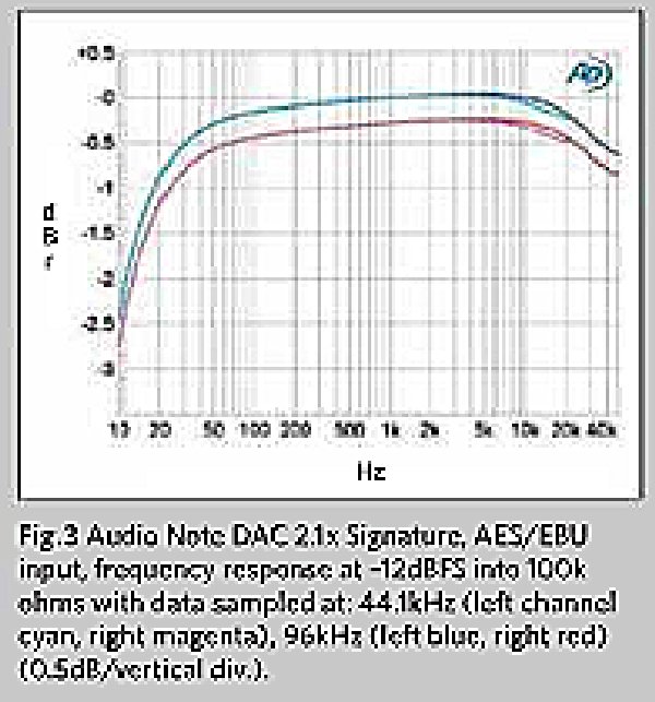

For a hoot read the recent Stereophile review of the latest Audio Note DAC, especially JA's sidebar measurements and comments.
While the article is not on the web, it appears that the sidebar is here:
Imgur: The most awesome images on the Internet
The typical NOS DAC roll-off in the audible range is shown here:

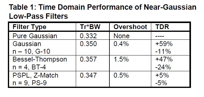

What are the rise and fall times of the "before" square wave?
Per screenshots of post #77036, rise and fall times seem to be almost equal.
The ‘before’ as I read it for 10% to 90% is approx. 20us .
The ‘after’ is double of it (it bears also a measurement “Rise 35.45us, Fall 37.55us”).
The frequency is 1kHz (one period is 10 divisions at 100us/div for the ‘before’ trace, 5 divisions at 200us/div for the ‘after trace).
So, for this 1kHz SQRW, by counting the ripples, I would say that the ‘before’ is brickwall LP filtered at approx. 21kHz. Scott has said it already here:

The answer is right there by standard rule of thumb 35us rise time = 10kHz BW IIRC for any order filter.
http://www.tek.com/components/low-pass-filters
This all fits ~20kHz in first case ~10kHz in second case. Table from reference below shows there is little deviation from tr ~= .35/BW across filters. That is 35usec rise time = 10kHz BW.
http://www.coe.montana.edu/ee/lamer...h_paper_NIappnote_on_gaussian_risetime_bw.pdf
