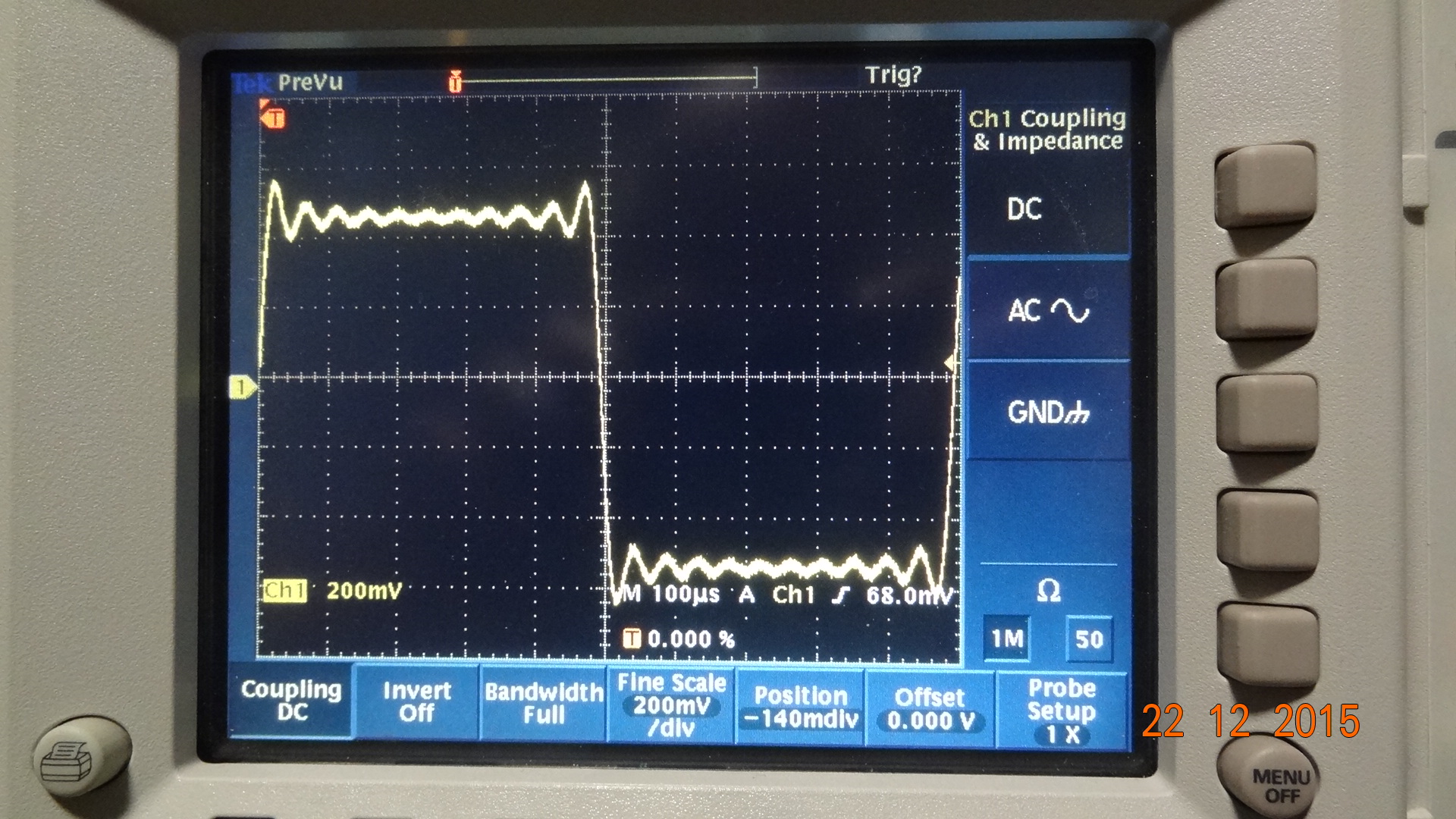

Some where I got some of you guys going in the wrong direction with me. Maybe I jumbled pictures with comments.
The additonal LPF at the DAC output that I made cannot have any affect on the creation of the 'Gibb's' ringing.
When I added the filter at the analog output to remove HF, I also saw the Gibb's signal (ringing-like) not at the analog output any more; All removed from entering the PA input.
I'm making dinner now, I will go back over the pictures later. You did not do this at 44.1kHz sampling. Yes the 48kHz Gibbs effect at 96k sampling can be seriously reduced by filtering that still does not touch the audible range. When you burn a Red Book CD the Gibb's at 22.05k will be back. It really would be good to sit down with a good digital audio text.

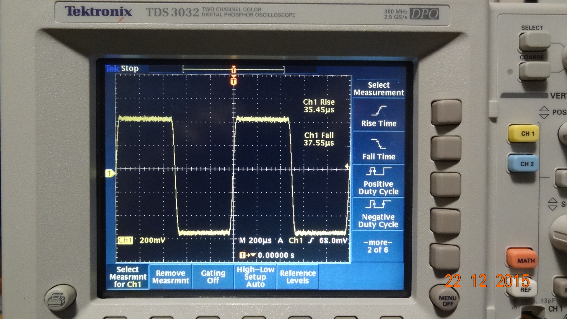

The analog signal is from an analog signal generator.... perfect square wave.
I record it via ML9600 analog inputs and then make a CD of it. I play the CD back and look at the analog output from the machine at the RCA/analog output.
In the listening environment, the LPF is used between the analog output of the ML9600 and the analog input to the BenchMark-2 which has its' analog output going to a PA. I do not have an LP system for many years.... too much distortion to my liking.
Before and after:

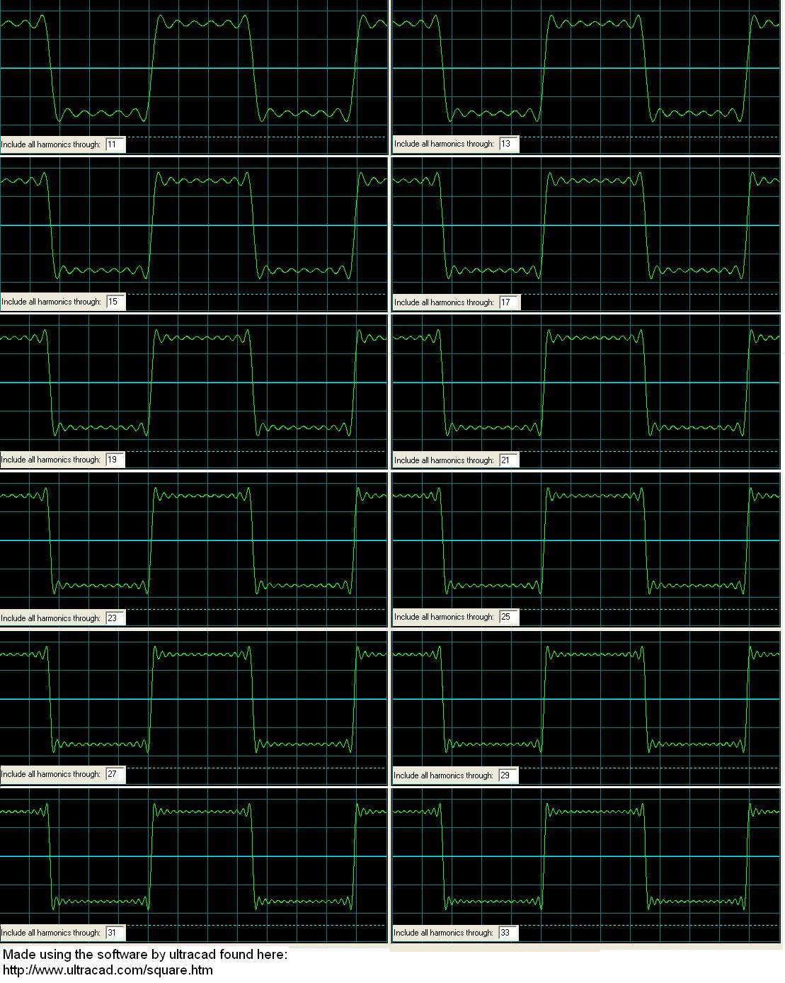

as to how to make this point.
rayma has come to a rescue , thanks Ray.
I used the above software to make the attached screenshot.
I wrote the number of peaks at the top (or bottom) flat of the square wave against the number of harmonics on a sheet of paper.
There is a pattern emerging when looking at the two columns.
Then, by inspection, we can estimate the number of harmonics (H) that the SQRW is composed of by counting the number of peaks (P) visible at the top flat:
H=2P-1
It follows, that we can estimate the number of peaks (P) that will show-up at the top flat when we know the number of harmonics (H) that the square wave contains:
P=(H+1)/2
