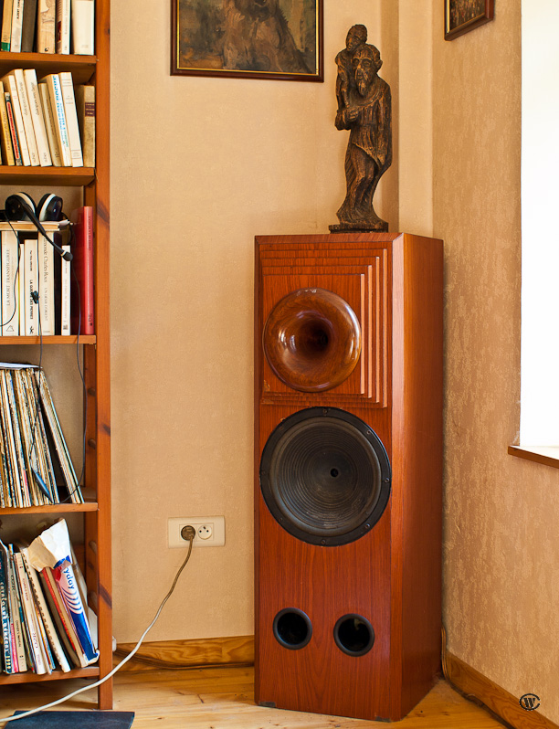

Everybody need, one day or an other to listen to a good 'spherical wave' horn system, le clearch based. And it is ennough to record one of those, in comparizon to any menbrane one to be convinced of their "accuracy". And, about size:

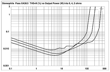

The noise contribution to THD+N is an interesting one, and one I have never seen much discussion regarding is there a 'best' shape for this. First attachment is THD+N for the Pass XA30.5 which is highly rated and award winning. This follows the shape that most of the amplifiers I have seen measured follow, with the minimum around -10dB from peak, below which noise dominates, above which distortion dominates. As that last 10dB is only for the biggest peaks or the odd head bang, this seems to be eminently sensible.

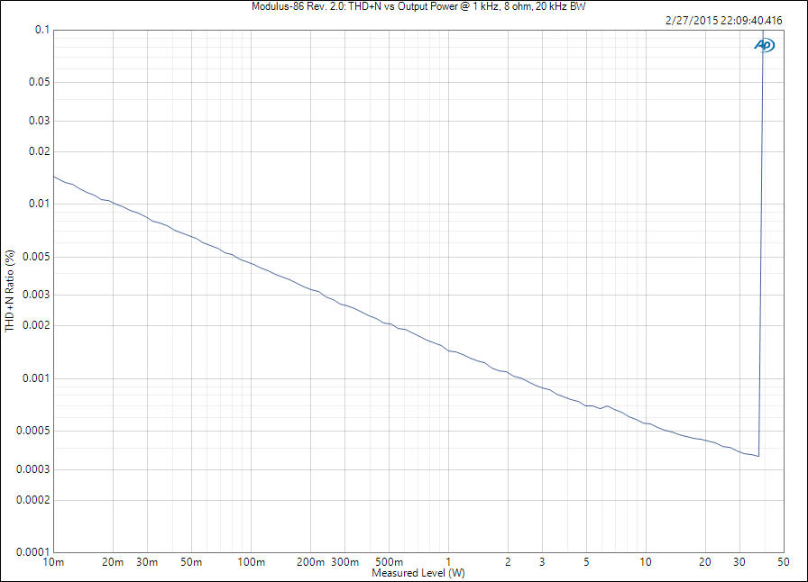

Second is the same for an amplifier I'm currently building a quartet of to switch to active drive on my speaker. It's the best I can afford at the moment :), and although the design will not tick the boxes with many (not big, not heavy, can't jump start cars) it measures pretty well. You can see with this one THD+N continues to decrease until clipping is reached, so inferring its noise limited. As the noise floor is down in the weeds and it could be said this is as good as you need to be for this particular measurement.
But when you do have to trade noise or THD, which way do you go?
(for the record, when operated within a common operating area I would not expect to be able to tell the difference between those two amps. )

Your horn system is more like what I grew up with with a large 15" cone driver and then a horn on top.
Note, please that i did a mistake. My horn is smaller than the cone, and that is not good. So I'm obliged to use an electrical 24dB/oct filter. If i was courageous enough, i would build an other enclosure with a sub and a high efficiency 10" or 8" bass medium.
I know, like you, and hate all those PA horns (i managed a big PA system with those old JBL PA horns, resonating everywhere with response curves like shark teeth ;-)

IIANM, the LHS distortion plot is on s linear scale. Might be easier to compare if both are log.
The NP amp is clearly low or no feedback. After 10 W the distortion climbs out of the noise floor finally you have soft clipping at a hundred watts or so.
The second amp looks like a high F/back exemplar - distortion close to the noise floor until is clips.
Two very different amps
