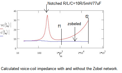

But compensating the impedance curve of my driver (1500 - 40 000) makes, for sure, a real positive difference.

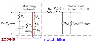

I would concur, but surely this is a Thiele (parallel) rather than Zoebel (series) network? Or just call it a conjugate notch as Zaph used to, which removes all confusion?

Of course I knew I would get this response But no, it is not about treble, it's about phase. You can make the tweeter response tilting down at 8kHz and that will be fine. But if you make a notch above 8kHz to remove the HF, it will sound different.
And yes, without the zobel you will get a lot of "hash" or noise, mostly with bad recordings. I hate it myself. So I have tried to find the solution without using zobel.
The compensation networks I use are parallel, of course. And situated after passive crossovers if any.I would concur, but surely this is a Thiele (parallel) rather than Zoebel (series) network? Or just call it a conjugate notch as Zaph used to, which removes all confusion?
See: DIY Speakers Design Knowledge, Speaker Review, Loudspeaker: Zobel Network Design
Once achieved with a given transducer, I consider-it as part of the speaker, and will use-it even with active filter.
Of course, in order to save components, the inductance compensation can be mixed with the low pass filter by simply increasing the last // capacitance for bass or medium transducers.
How do-you expect phase is changed at the output of an amp with very low internal resistance by adding a little parallel charge ? It is a capacitance with a serial resistance.it's about phase.
The goal is dual. First, having flat impedance curve after the cable ensure any serial resistance in it will not have impact on the response curve. Second, as explained, ensure the amp will not have to deal with disparites between voltages an currents all along the audio bandwidth.

I think a more appropriate name is a tank circuit, LCR, that is of course a parallel shunt circuit to tame the impedance rise of the drivers in question.
I had a feeling from the description that Jay was talking about a series circuit, he made it sound like a low pass circuit rather than a shunt conjugate network, or tank circuit.
matching network, conjugate, tank, boucherot; anything but Zobel. It just confuses as people think that a Zobel is a series network, even tho it isn't really. Having checked Esperado is correct in his use of the term, even if most consider it to be something in the amplifier.
