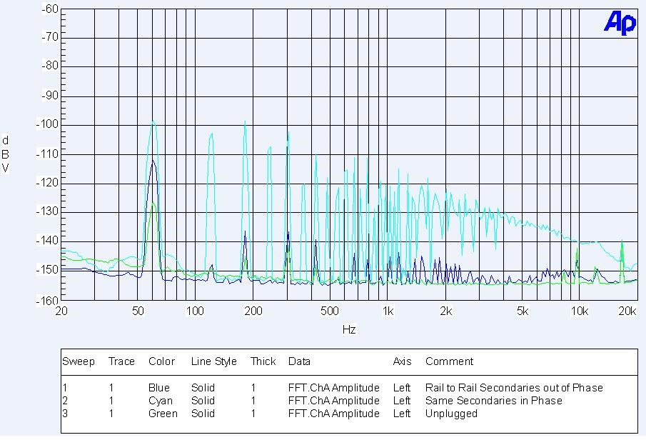

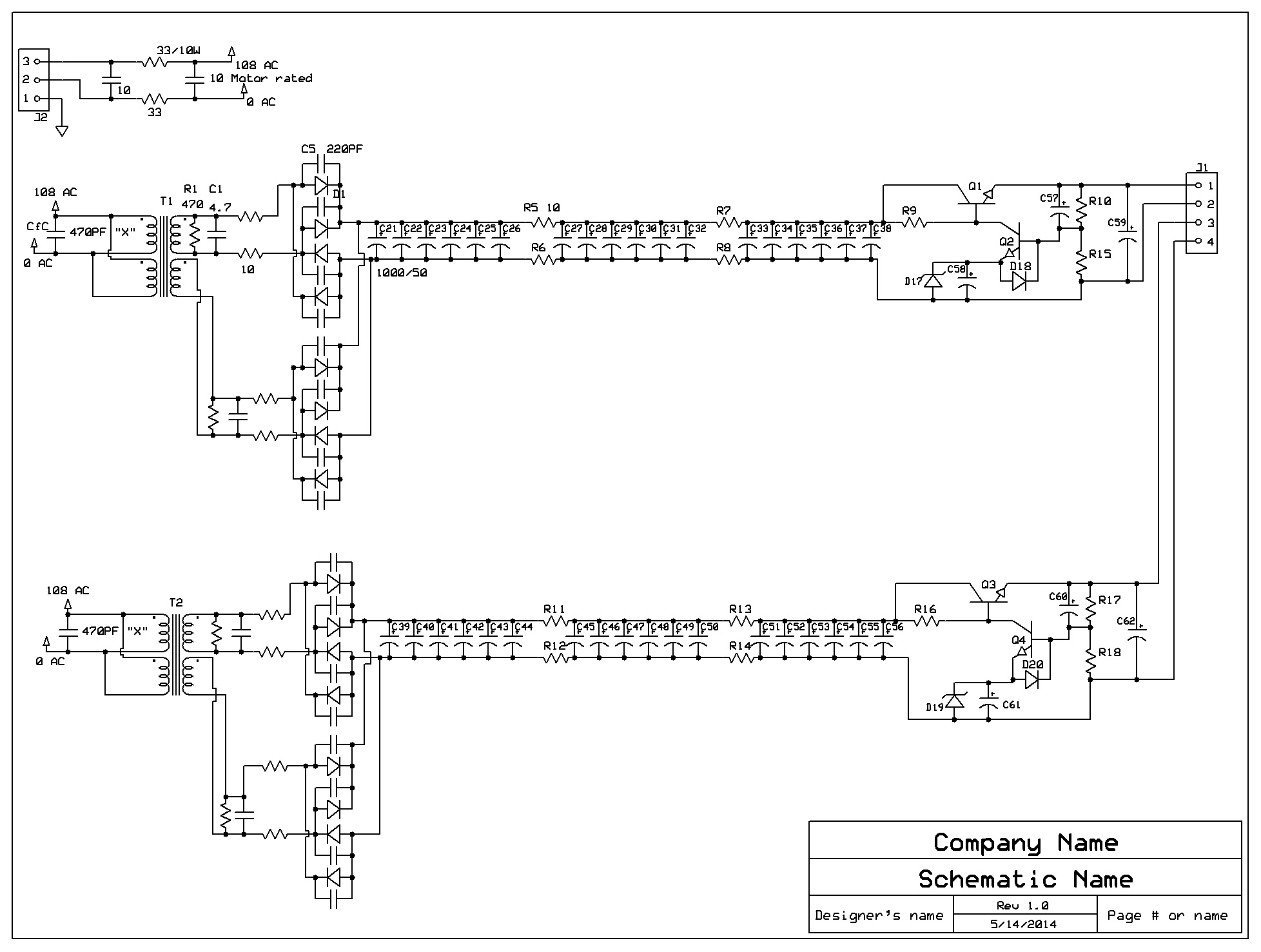

The "no" AC to DC conversion escapes me if it's mains powered at the beginning. Seems great for a pre-amp, I wonder what the bank switching time is at full power for a PA.
Appears to be an external power supply. A 10 farad bank at 40 volts might actually work for a 50 watt per channel amplifier as the average output should be 1/2 watt. But for practical purposes the output stage could be conventionally powered.

The ideally-floating supply for the proposed I source that achieves a small improvement in the complementary folded cascode preamp can be balanced so that a bog-standard dual bobbin transformer's line noise injection is small. Of course additional common-mode chokes don't hurt.
The big cap banks could be switched smoothly enough to avoid audible transients---but I could imagine a scheme like that inducing paranoia---did I just hear that?
Simon, the problem with AC is, on my point of view, not so much noise on the rails (it is easy to design high PSRR devices), but leakeage induced by the transfo creating parasitic noise between the ground of several devices connected together.
So, traditional batteries that recharge when you don't listen to music and disconnect from AC when music is playing seems to me the best solution.

In a conventional linear power supply the line noise is conducted during the rectifier diodes on period. Some folks bypass the rectifiers with capacitors that then pass the line noise all the time. A properly sized capacitor will reduce switching spikes from rectifier types that produce them and minimize the line noise. Most designs I have seen that use bypass capacitors size them way too large.

When testing for CE approval that is what I found it just shifts it around a bit on the spectrum analyzer in some case it was worse. One cap across the bridge input with HS diodes worked best. Well best to past the conducted emission to the line at least.
