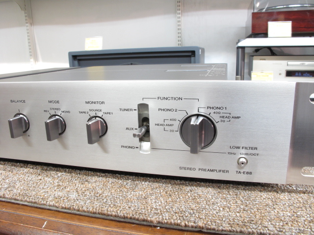

I once did a demo in a shop with various loads on an Ortofon Jublilee MC. Started a 100R, then 47R, then 22R and finally when we hit on 10R there was an noticeable and obvious improvement. Since it has a DCR of 6 Ohm and hence effectively its source impedance, it seems with a number of cartridges benefits getting close to it and that it seems to get to a point where the load starts to "bite" and then perhaps finetune it.

My vintage Sony super duper TA-E88 has a pair of MC head amps, each having a selectable load resistance of either 40 or 3 ohms. Not stupid, they were.
